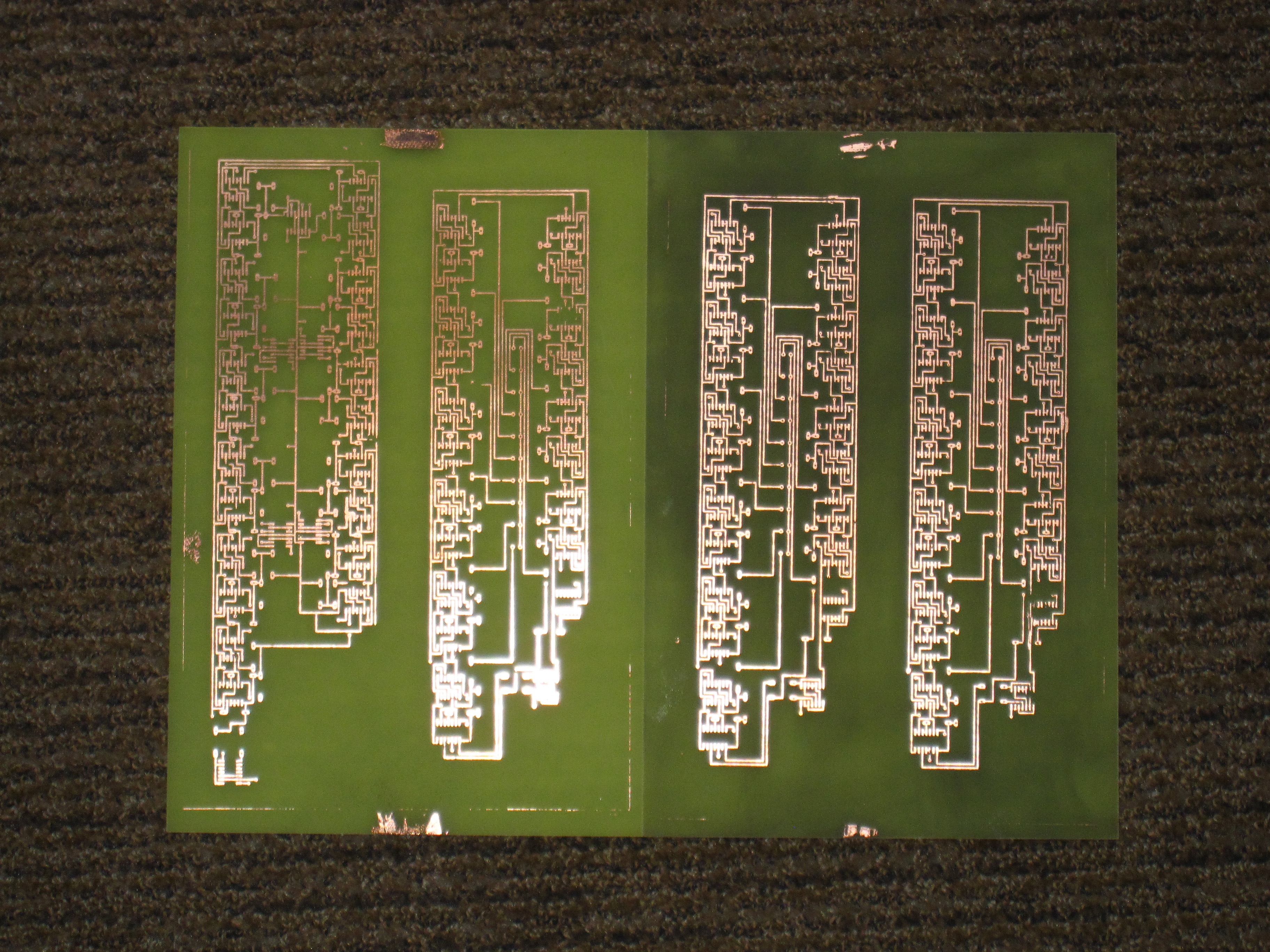

Guys,
Thanks for all of your input and your help on this, it really helped me out. I was finally able to etch some boards for my digital comptometer circuit (I still have not tested it fully, but if I get it all working I will definitely post up some schematics on another thread in the future). I used heat transfer with magazine paper, which I then put in boiling water before peeling off the paper and etching with ferric chloride. the boards are far from perfect, but I think that they came out reasonably well considering the complexity and size of the boards and that this was my first time trying this. I have a lot of drilling to do now, but this is certainly a step up from manually wiring things on perf board. also, if it is of any help to anyone here, I found that sharpie marker actually works reasonably well as a substitute for an etch resist pen, although it is not perfect.

Staedtler pens such as these **broken link removed** work much better. The lines are much finer.
You can erase lines with the solvent methanol.
All said, i feel, that for complex designs , EDA based artwork and tone transfer method is still better
I do agree with 3v0 that while toner transfer, one can use press& peel or pulsar pro etc where they are available freely in their local markets.
pcb artwork of complex nature, using marker or etch-resist pens , would turn out a workable board perhaps. But doesn't look good and has its own issues.
