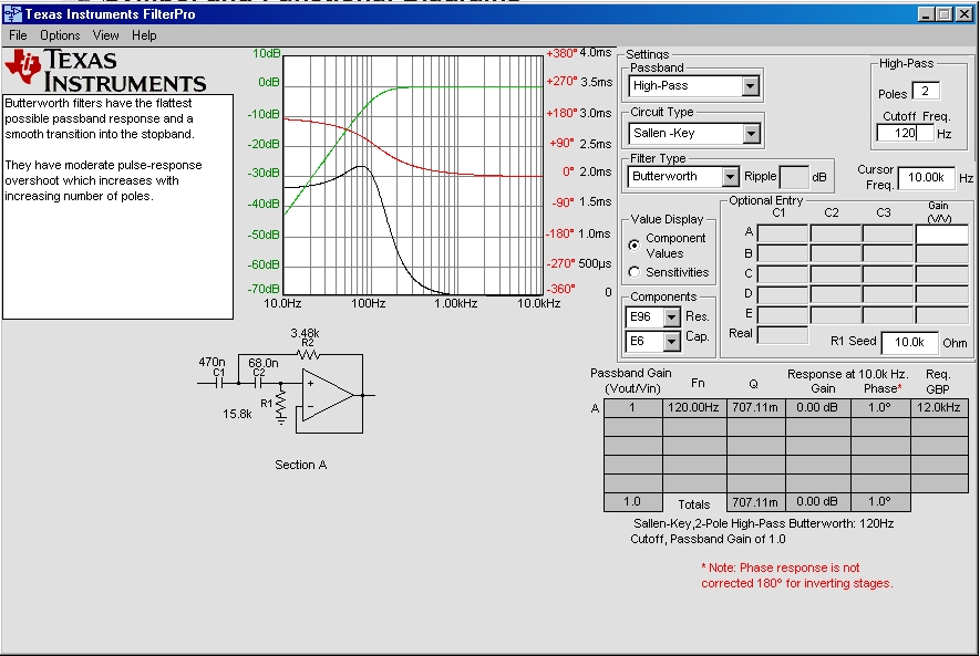

Go to the TI website and down load a free program called "FilterPro". It will design high- and low-pass op-amp RC active filters of various orders and gains. I have it downloaded and use it all the time. Write back if you cant find it or need some help with it.

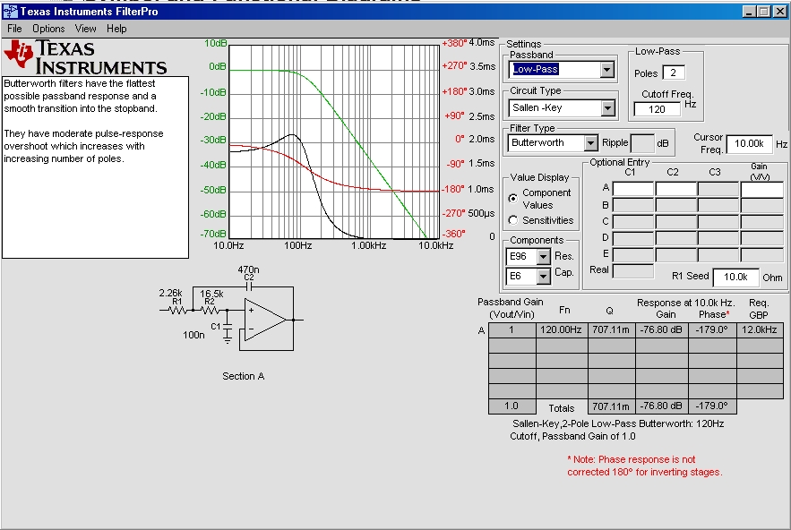

Here is the High and Low Pass Opamp versions as designed with FilterPro. These are way simpler than anything involving inductors...:D
2 questions:
those op amps would be put between the input signal and the amplifier right?
and my one drawback is that these are powered circuits... is there any way to make a passive filter so i dont need to plug it in??

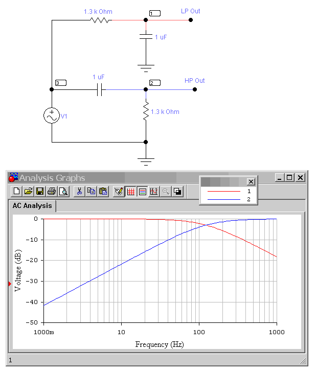

Attached is the schematic for two one-pole passive filters to perform the crossover function at 120Hz.
Note that most crossovers for this function are two-pole for faster rolloff but that involves very large inductors to make passive filters at this low frequency. That's why active filters are usually used at audio frequencies.
The resistor values assume a high amplifier input impedance. You may have to measure the amp input impedance and adjust the resistor values accordingly. For example a 10kΩ amp input resistor will shift the frequency about 10%.
The capacitors should be non-polarized film type (mylar or other).

The huge inductor of a passive sub-woofer filter will pickup mains hum from any nearby mains transformer. A single-pole cutoff is almost useless anyway. You need sharp 3-pole active filters.
The Sallen and Key filter designs usually use equal-value capacitors for the highpass and one resistor double the value of the other. Or equal value resistors and capacitors and the opamp with a gain of 1.6. Texas Instruments Filter-Pro software doesn't know it.
where would i ground the schematic that crutschow posted because i am trying to do this filter without a power supply, or do i need one?
Look at the response curves of the passive filters. It is almost useless as a filter.
Its response is down -3dB at 120Hz but it still has plenty of output at 1khz (-18dB).
The highpass is the same. It still has plenty of output at very low frequencies.
Crossover filters are usually active so they can have sharp cutoffs with more poles.
