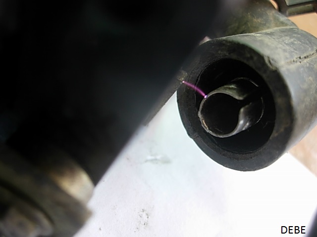

yikes - some serious spark happening there.. might have a look. Any idea what cars these came off? I can just about braze a butt weld on aluminium if I need to or just use some angle alu (just a benzomatic with rods) so I can fab up something if need be.. That looks pretty smart - and water/moisture proof.

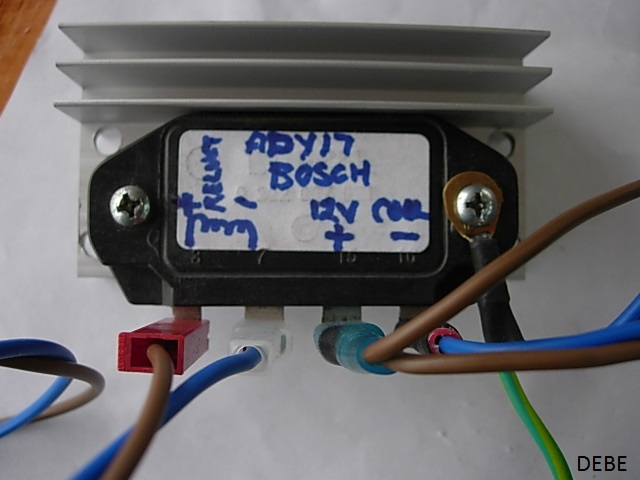

Do you have a close up of the module as mounted on the distributor plate?
Guess my old regular coils wont wok with this right?
The trigger coil came out of a Honda car distributor. The Bosch module from a Ford car, & would need to be mounted on a heat sink outside of the distributor. Electronic ignitions need that type of coil, not the old points type coil.

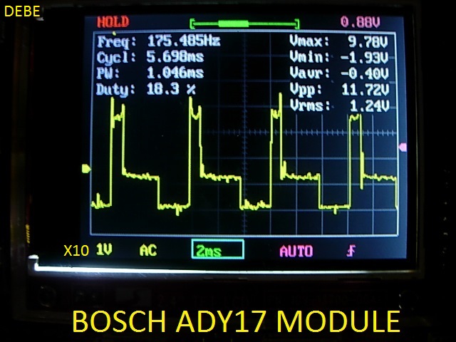

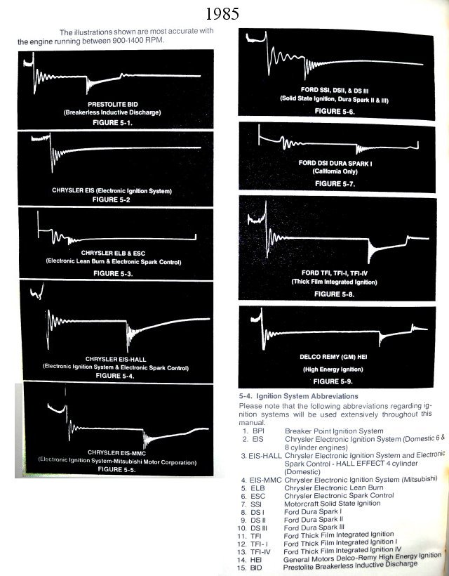

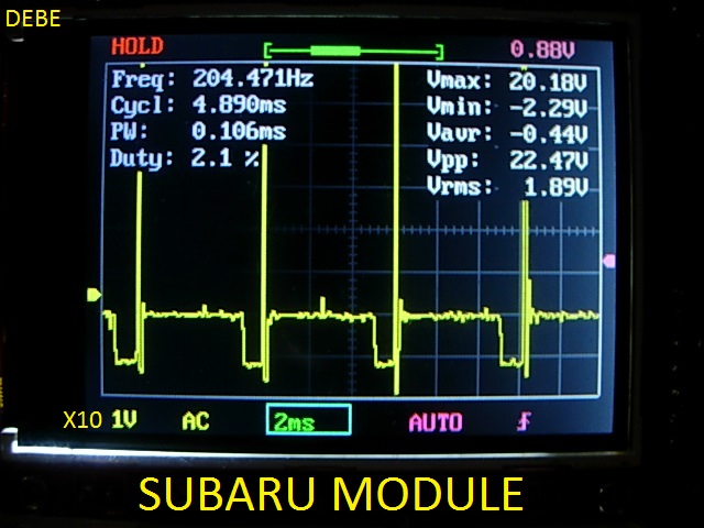

Here are scope patterns for different brands of electronic ignition.
This link should work now.
https://www.dna-robotics.com/uploads/3/4/9/6/34960915/automotive_scope_diagnosis.htm

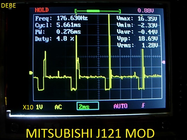

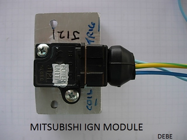

Just a bit more information. This is a Mitsubishi J121 module & wave form on the coil primary.

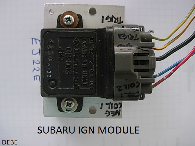

This one is from a Subaru EJ22E engine. This module has 2 separate units built in to one module. Very handy if one fails.

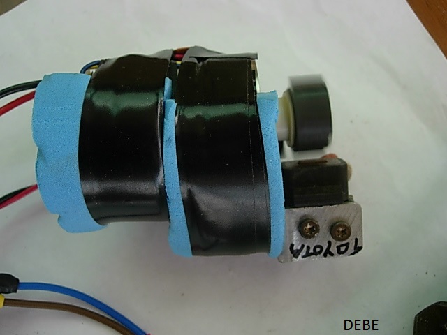

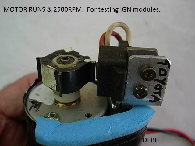

This is my Reluctor unit for testing IGN modules. The Reluctor is from a Toyota distributor.
Im endeavoring on a little attempt to make my own electronic ignition.
