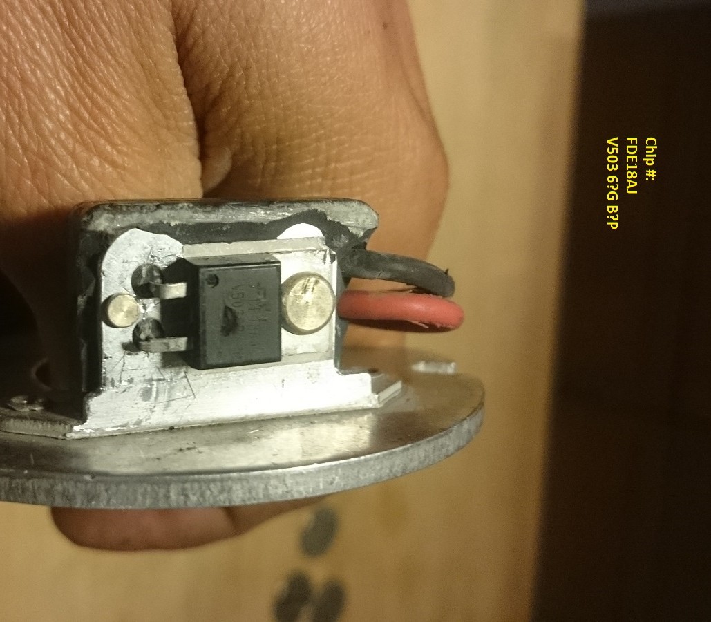

Here is the chip that was burned out - I managed to get the plastic resin off ok -
Can anyone try help identify a replacement? I tried reading the last 2 numbers, Either 6 or G and B/P..

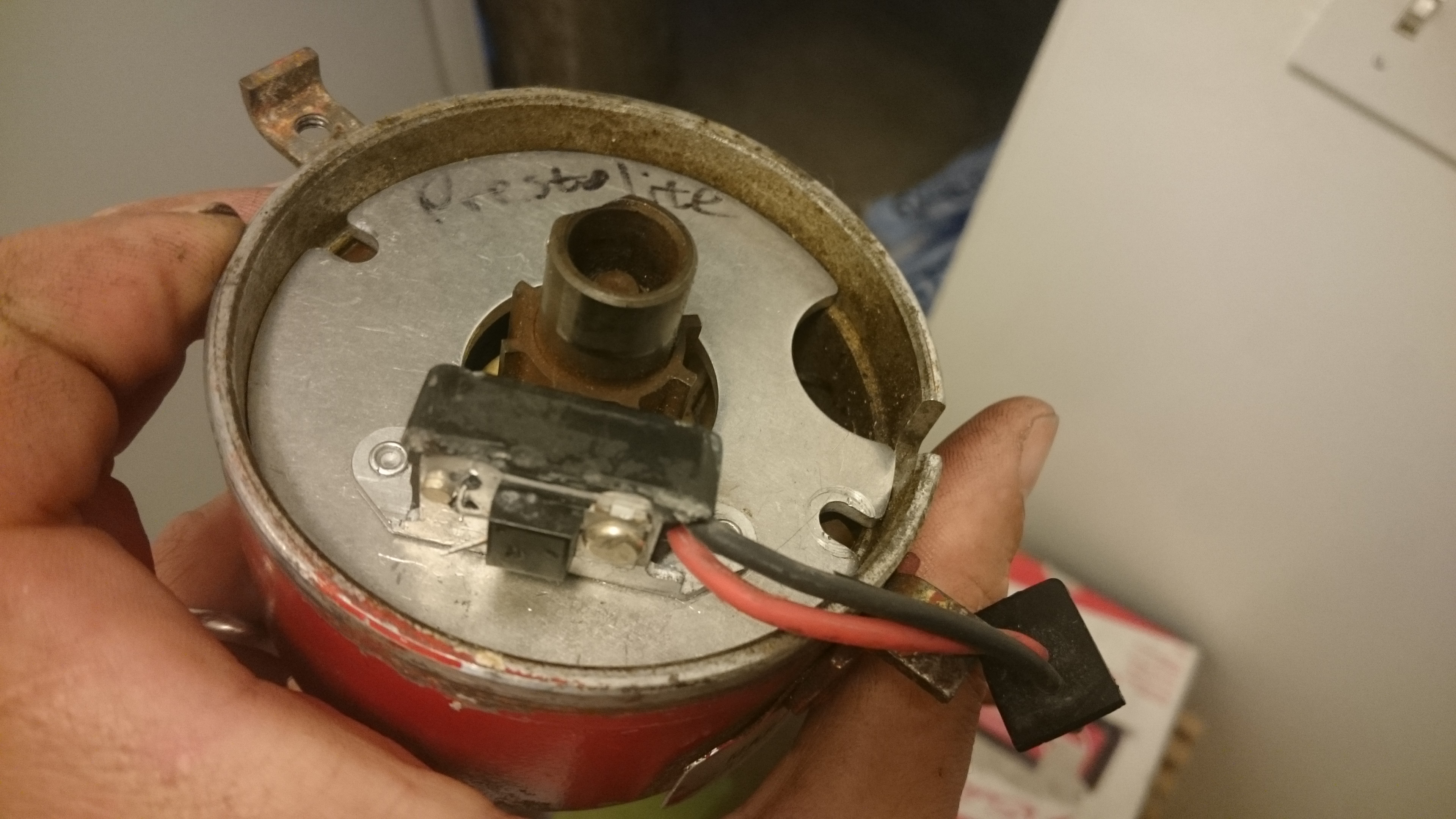

I have a pertronix unit that was given to me and it was burned out. Being the fellow I am I opened it up and found a very similar looking system inside. This guy built his for $10..

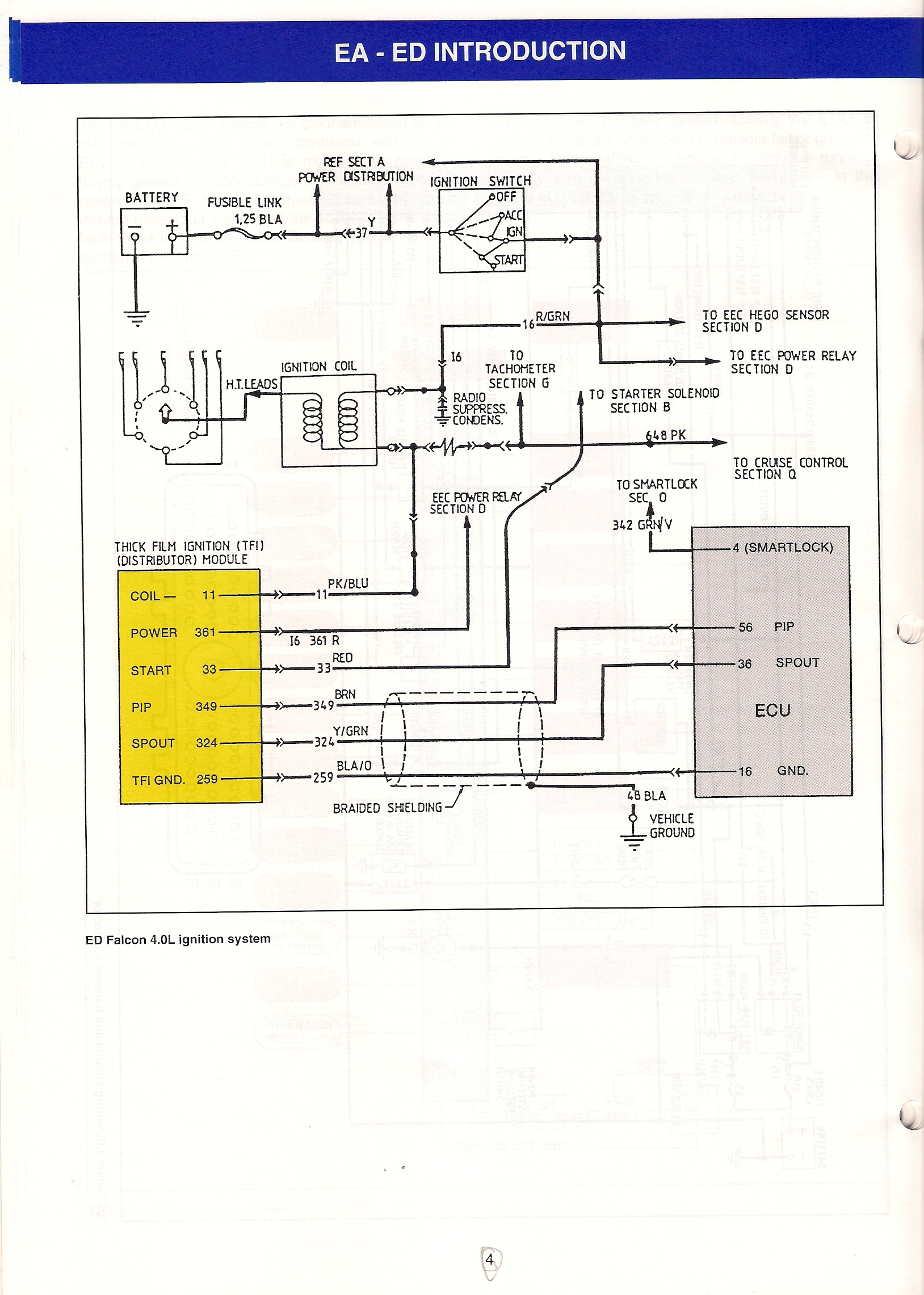

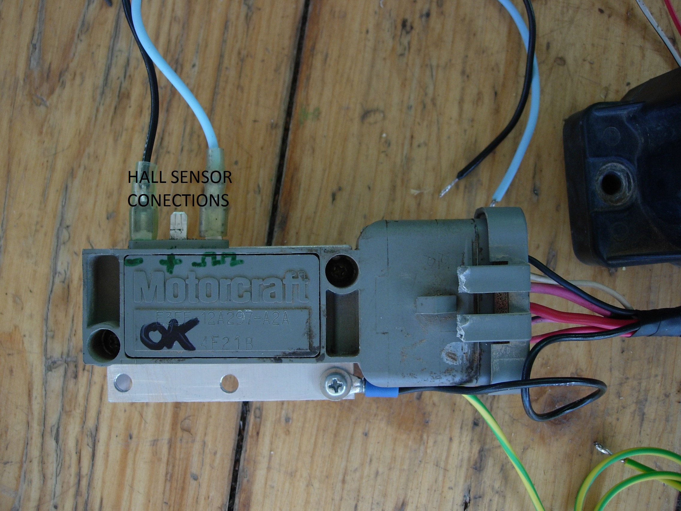

This Ford Distributor Module is designed for a Hall sensor, & it has the current limiting built in. I pick these up for free from a local scrap merchant before he crushes the car. Probably quite cheep where you are. They do need to be mounted on a heat sink.

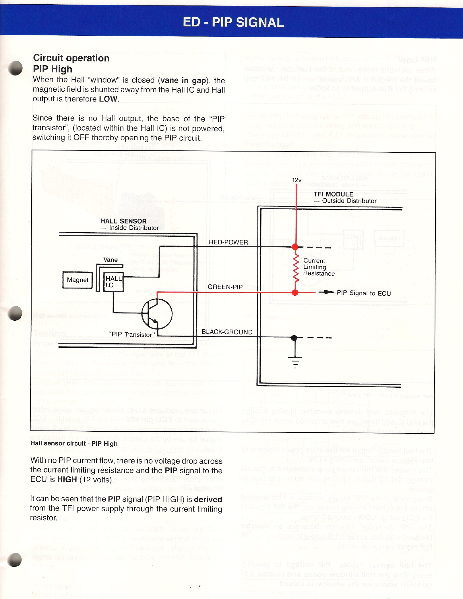

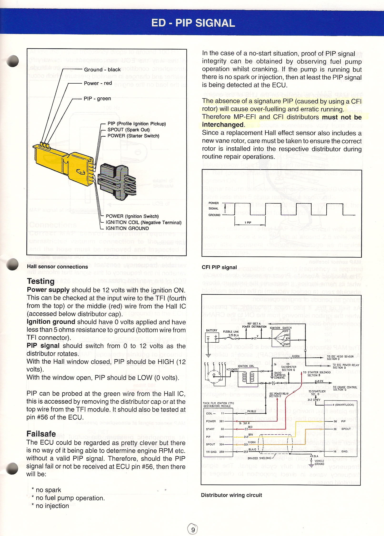

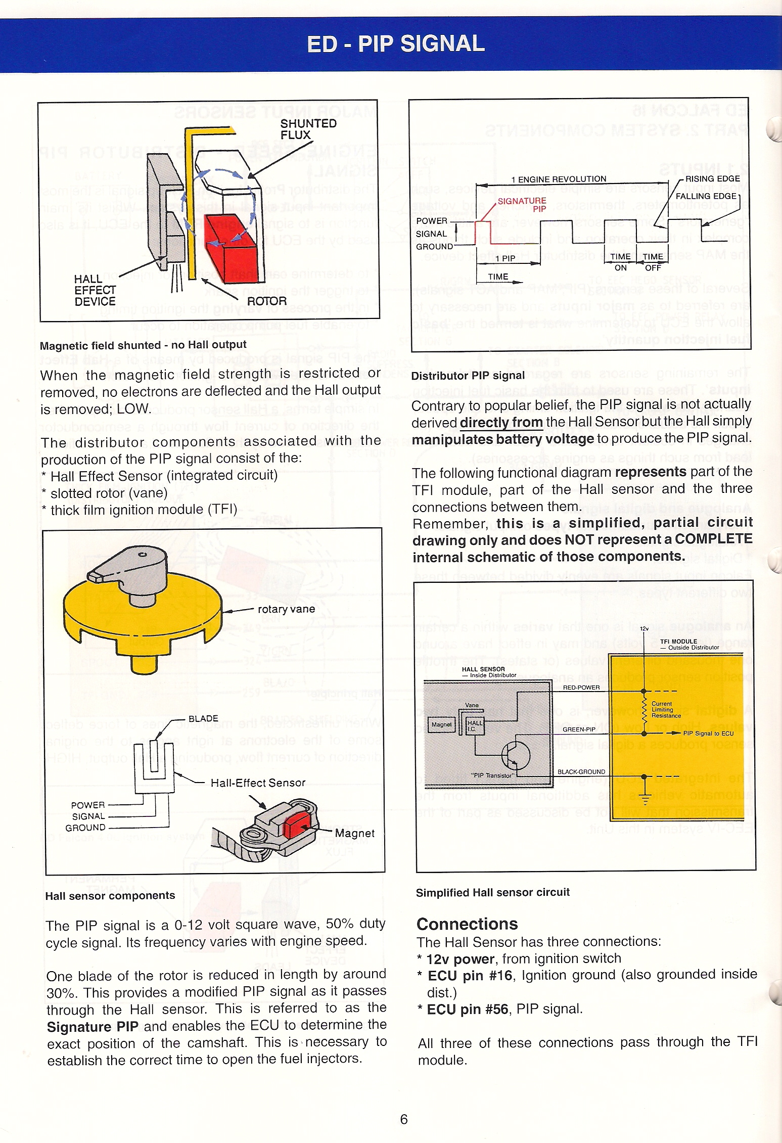

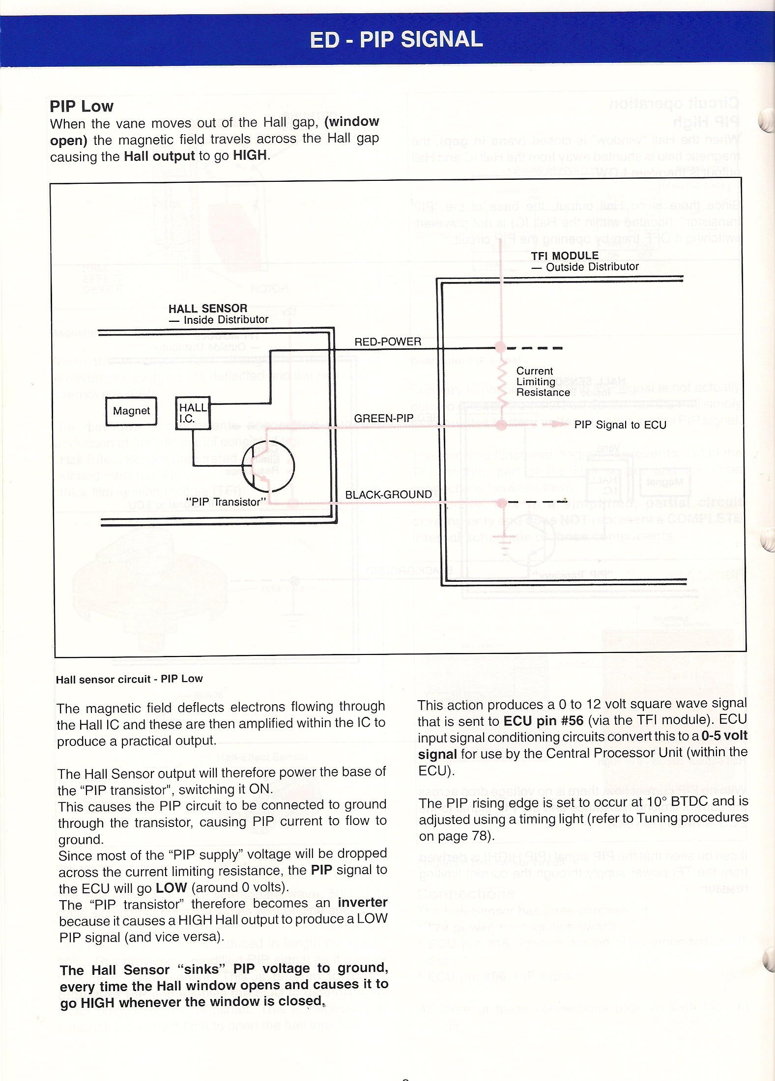

This you might find interesting on Ford TFI/ Hall ignition systems, It was part of a Fuel injection course I did some years ago.EB.4.jpg EB.5.jpg EB.6.jpg EB.7.jpg EB.8.jpg EB.9.jpg

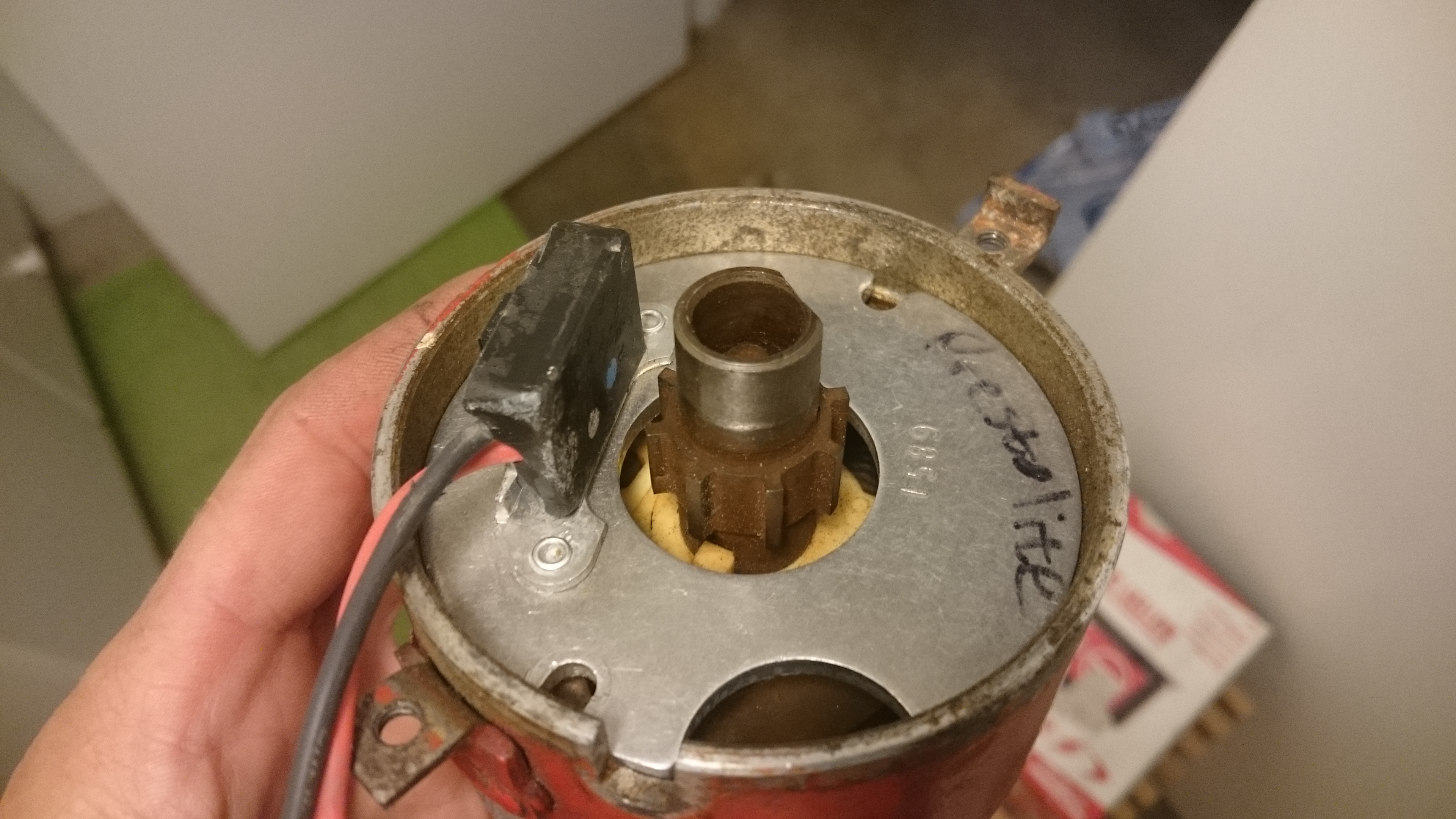

Also - here is a similar pic of the reluctor I have, can anyone tell me what type this is (so I can at least correct my terminology!) and if it will work with the components / schematic above?
I held a metal knife onto mine and it doesnt appear to be magnetic - how does this trigger the sensor?
The sensor includes, or is magnetically close to, a permanent magnet. The reluctor completes or modifies the magnetic circuit.

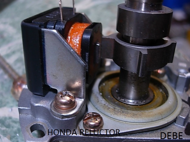

This is a reluctor type unit as you previously posted. They use a triggering coil, & the coil has a magnet on it.
Mine is a pertronix ignitor 1 unit that burned out.. I foud a replacement chip on ebay for $4.. will pop it on and see what happens lol.. but no oil on this thing.. just the reluctor and the chip thing i ordered.. underneath are some more components but its TINY.. about 5cm x 2cm x 1cm thick..

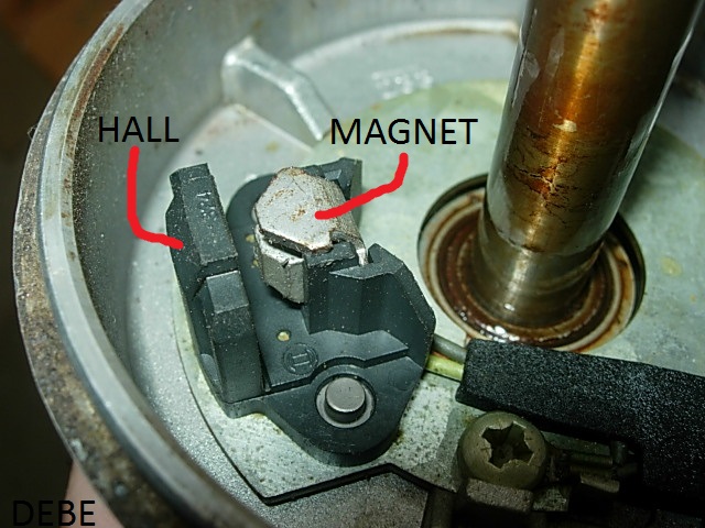

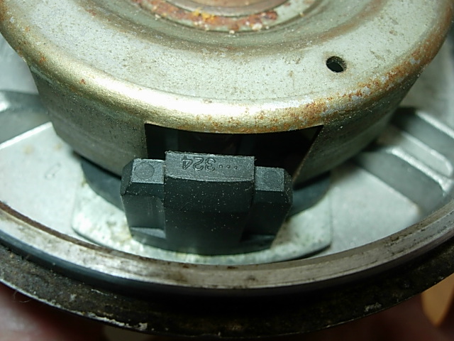

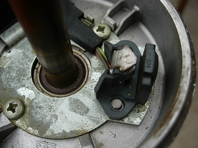

This is how most electronic distributers use Hall sensors to trigger Ign modules. These are hall sensors designed for automotive use & have built in magnets & are quite
rugged.

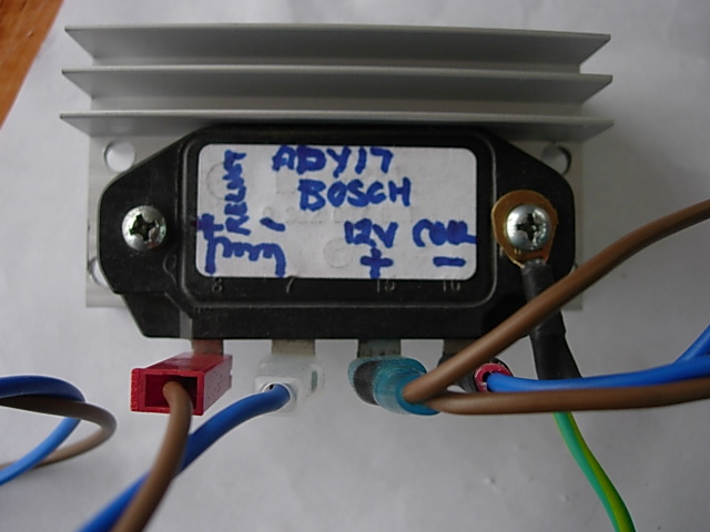

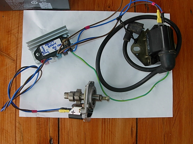

If your setup doesn't work with the reluctor. You could try this Bosch ign module that's designed for that system. Just find a sensing coil from a scrap distributor & fit to your distributor. You should be able to find the Bosch module at a wreckers cheep All of these parts I have scrounged from scrap places for free.
