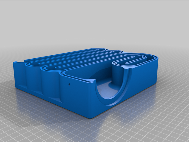

You may find this article & the video linked in it interesting?
A 3" sub claimed to work to 40 or 35 Hz.
I saw that before, its interesting, though not practical for me atm due to cost of 3d print, etc. But in the future it would be interesting to just order a box like this with the right speaker and voila, you have a speaker :)
