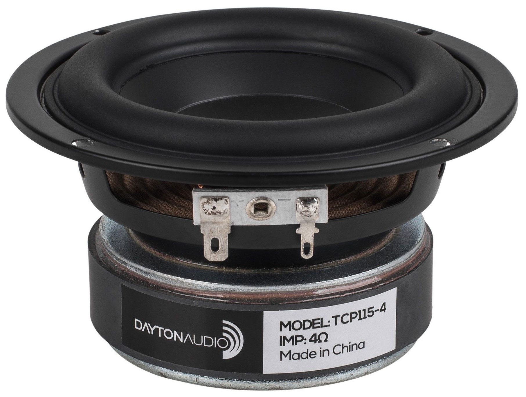

Oh 1 more thing. 1 of my goals in the future is to build a more portable speaker consisting of dayton TCP115. The speaker from wood i made is about 2.5L altogether, but i choose dimensions poorly so its very high, probably to high to comfortably put into backpack. It should be a lot wider. I will check the dimensions of those JBL extreme and sony speakers and try to be within the limits of them, see what bass that gives me. That is also the reason i am prefering thin materials - speaker is less bulky in the end. Sony SRS-XB41 is 291 x 104 x 105mm. If i used really thin material, that would give me 3.1L of volume, which is more than i have now, quite a lot more. So maybe in this case, a metal frame would be good ? I am not sure what contributes more to vibrating, the weight of the material or how stiff it is. But maybe with braces .. Then to further optimise it, i would use wires less long. Oh and the thing u prolly will not approve of ... shorter port with smaller diameter (all the calculators and guides i checked, the bigger the diameter, the longer the tube). Anyway this is my goal. But, what if we want to push the physics to the limits ? Look at the graph i attached of a stupidly small enclosure. 1.5L !! Granted not very low but stil, 70Hz, isnt that what JBL charge 4 has ? I would love to hear how it sounds like this.
And 1 last thing. Though i prefer port with daytons since i can actualy simply calculate it. But i am still, as an engineer by degree, very interested how it would sound with passive radiator, not tuned or calculated, just picked by stroke of luck. I cant wait to get parts i ordered to play around, learn, test.

I am really happy, i have found the perfect enclosure size, i have found the speakers, actualy im looking forward to seeing how much i will sense the extra 5dB from 4 ohm version. As for tweeter, i just picked the cheapest one i could find, if i find the quality to not be good i will obviously switch. Now i have to work on my woodworking skills, its hard to cut straight with jigsaw and have to make speaker pretty to sell it :D
Many of the spec's for the 8 ohms and 4 ohm speakers are different so the sizes of the enclosure and port will be different, if you want the best results.
The 4 ohm speaker will be 4.9dB louder than the 8 ohm speaker at the same amplifier volume control position. If the amplifier can produce its full power into 4 ohms the maximum output will be almost 7.9dB louder than the 8 ohm speaker. A TPA3116D2 amplifier can produce 40W per channel into 4 ohms at fairly low distortion with a 19V supply.

Very similar graph even though data isnt the same. The current amp is 2x25W, the one from the video and the one i tested, though i think it peaks at 20W per channel, most i measured. The amp i want to use in future is 8 ohm 2x38W and 4 ohm 2x50W. So we will see :)
