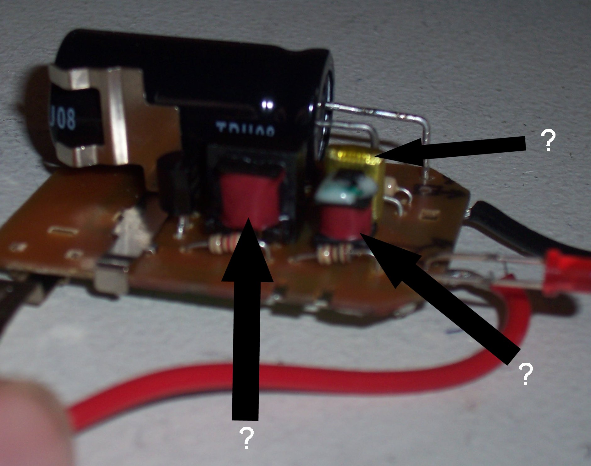

fantastic, iv found what ia was looking for, i just need some help working out what all the parts are!! i know a newbee question, but im getting there.

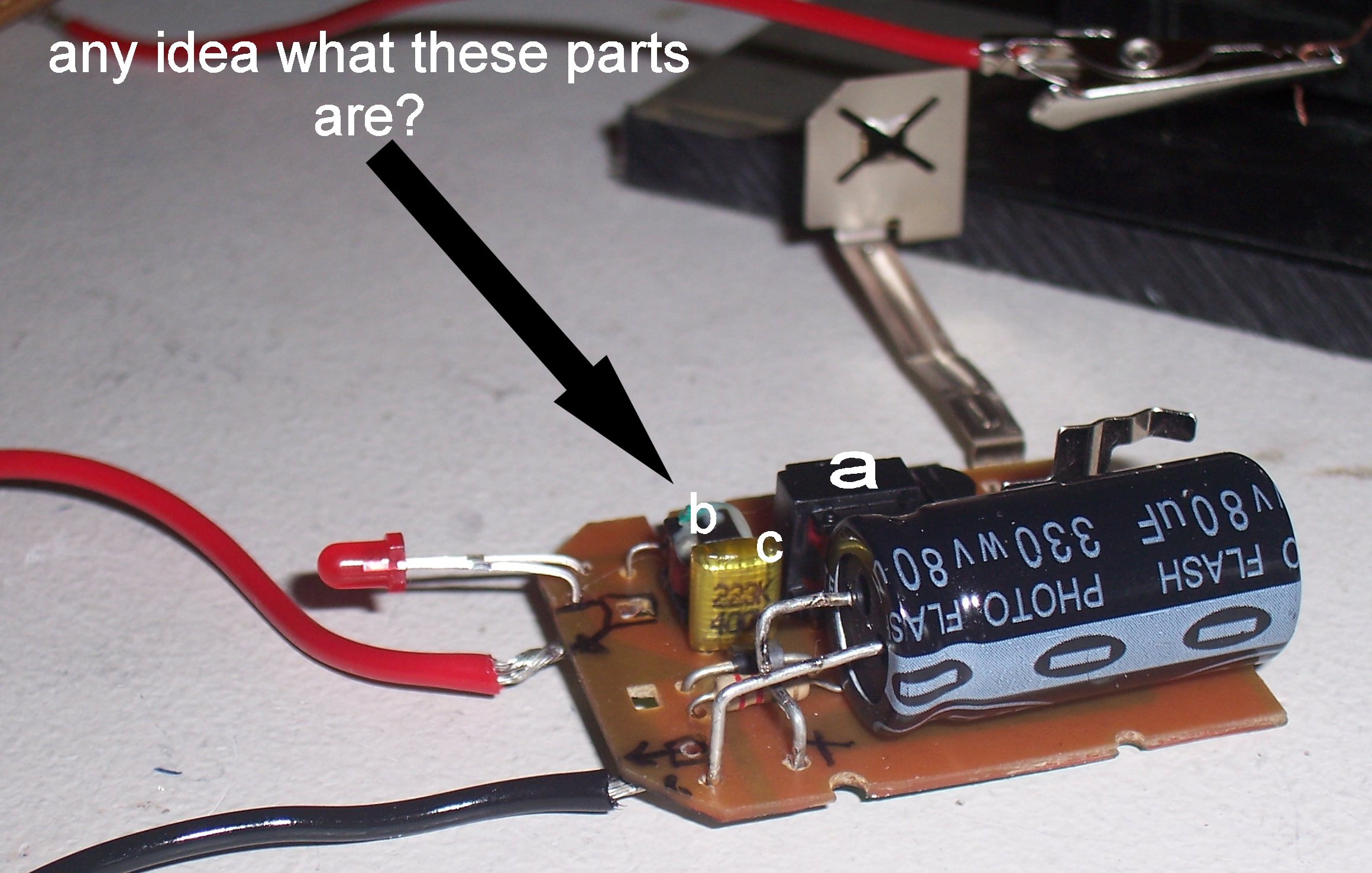

hi all i was just wondering if anyone can identify the parts in the pic, i cant find any markings on them, so any help would be greatly welcomed
cheers

By the look of it,
A. is a transformer ( T1 in the schematic )
B. is the trigger coil ( T2 in the schematic )
C. is a non polarised capacitor.
thank you houseOFwax, i can now start to design my new circuit, or at least re-design the original one to make it super small and super fast.

C is a film capacitor marked 223K/400. It is 22,000pF which is 22nF which is 0.022uF/400V. The K says its tolerance is 10%.
