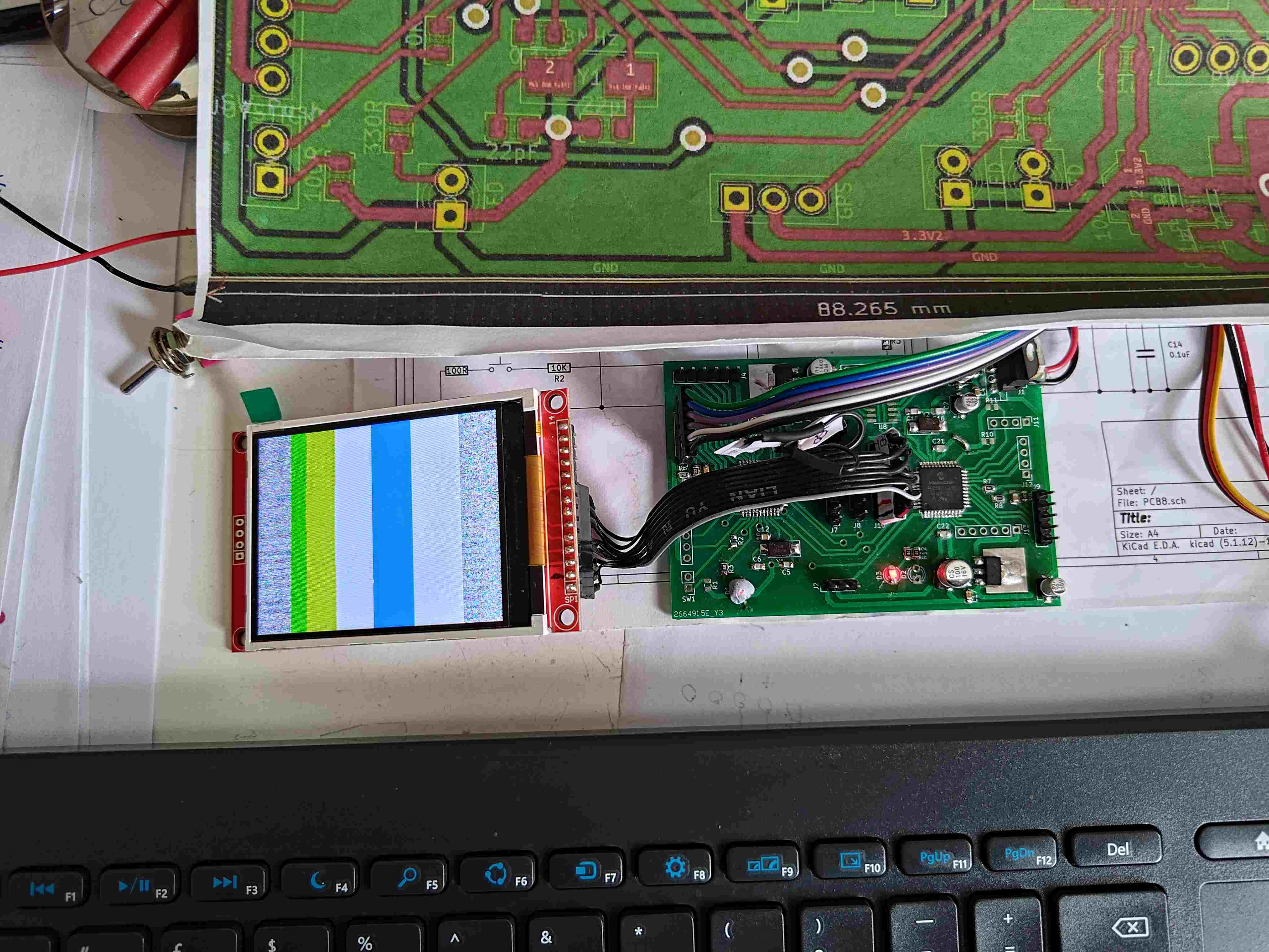

Hi, :)
At last I've got I's version working (a bit) after a few tweaks.
Now I'll be able to learn how it works.
Cheers, C.
Cam... Where is your code?? The problem with the code I put up was it's for a 240 x 240, hence your border.
Once I get a 320 x 240 I can get rotation up and running and then I can see exactly how CASET and RASET works to set the address..
BUT!! your nearly there..
Also.. Remeber what I said earlier... a 240 x 320 CANNOT! have byte parameters..
in the INIT you need words to send to the display ie ColSet_start.LB and ColSet_start.HB ColSet_end.LB and ColSet_end.HB 4 parameters...
Once I get a screen I can see where the pixels are going.
