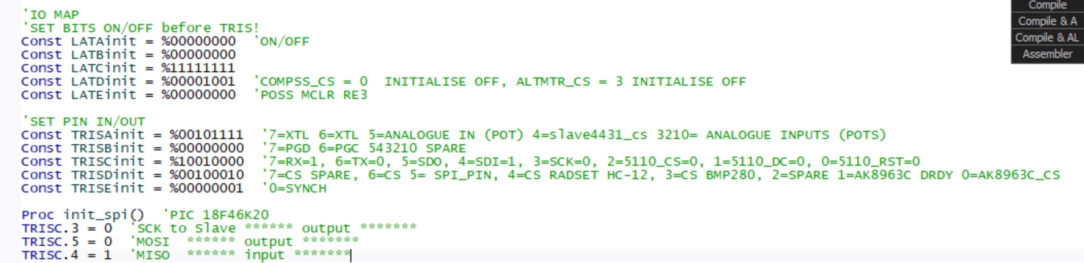

Hi D,
Here is the SPI set-up on my PCBs:
This works with the Nokia screen and all of the other peripherals.
It may not be conventional, but I've got used to it.
The init_SPI is called for in the program.
C

But what's your SPI speed?, the 4MHz setting in post #22 will give pretty slow results - with a 64MHz clock you should be looking at 16MHz.
I know, but you didn't (and still haven't) mentioned what SPI speed you're trying to use - and didn't post any relevant code.
Hi N,
I can't remember, and my limited brain can only concentrate on one thing at a time, and at the moment, I'm a bit busy. I'll let you know, when I dig further.
C
