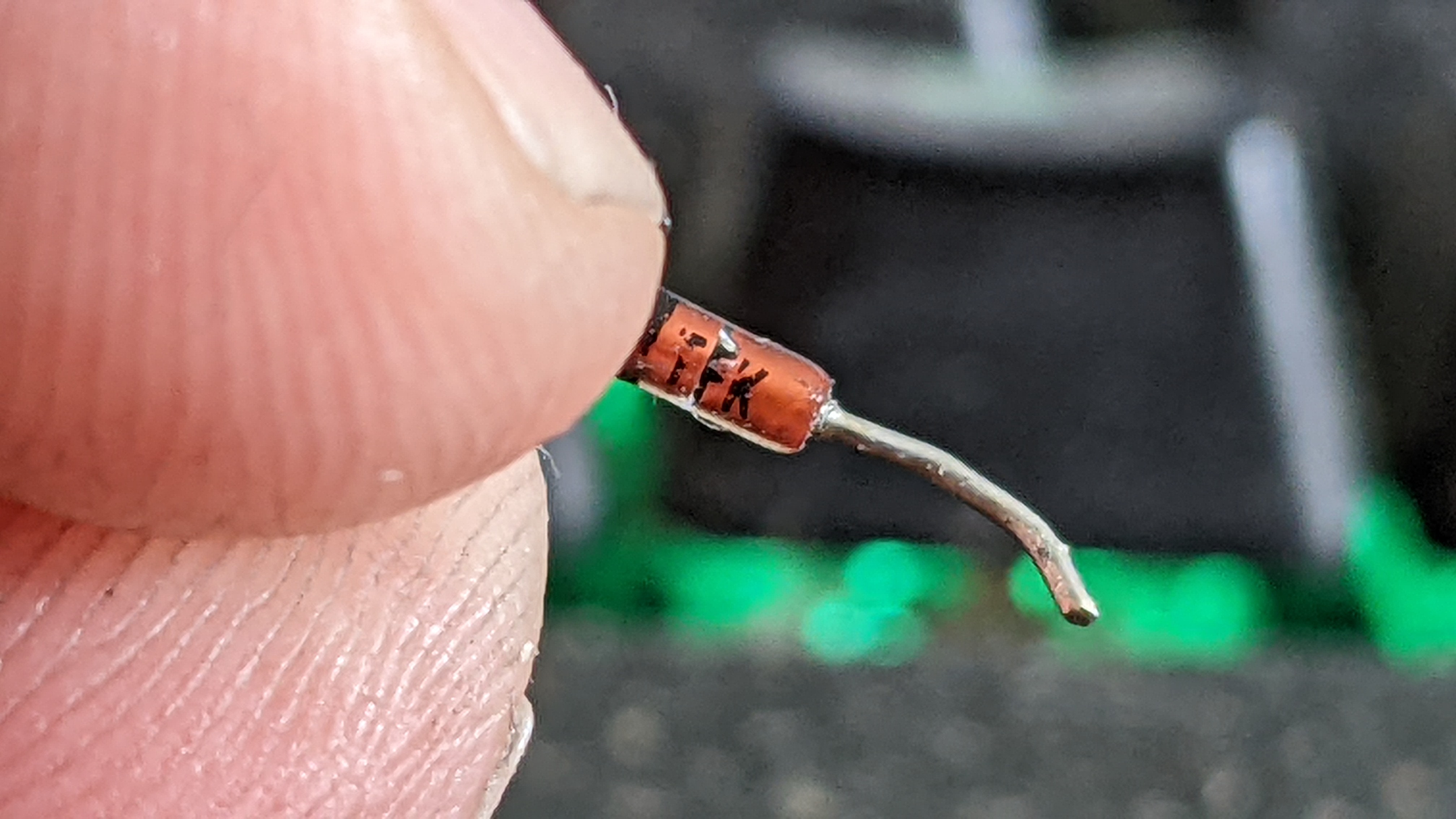

Hi there, I have a Commodore 1084ST computer monitor I'm trying to repair and would appreciate some help identifying a component. The problem is exacerbated by the lack online of any service manuals, so I'm currently drawing my own circuit diagram (it's going slowly). I have basic electronics experience and have repaired a few vintage 8-bit computers and the like. I haven't worked on a CRT before (I understand how to discharge the tube).

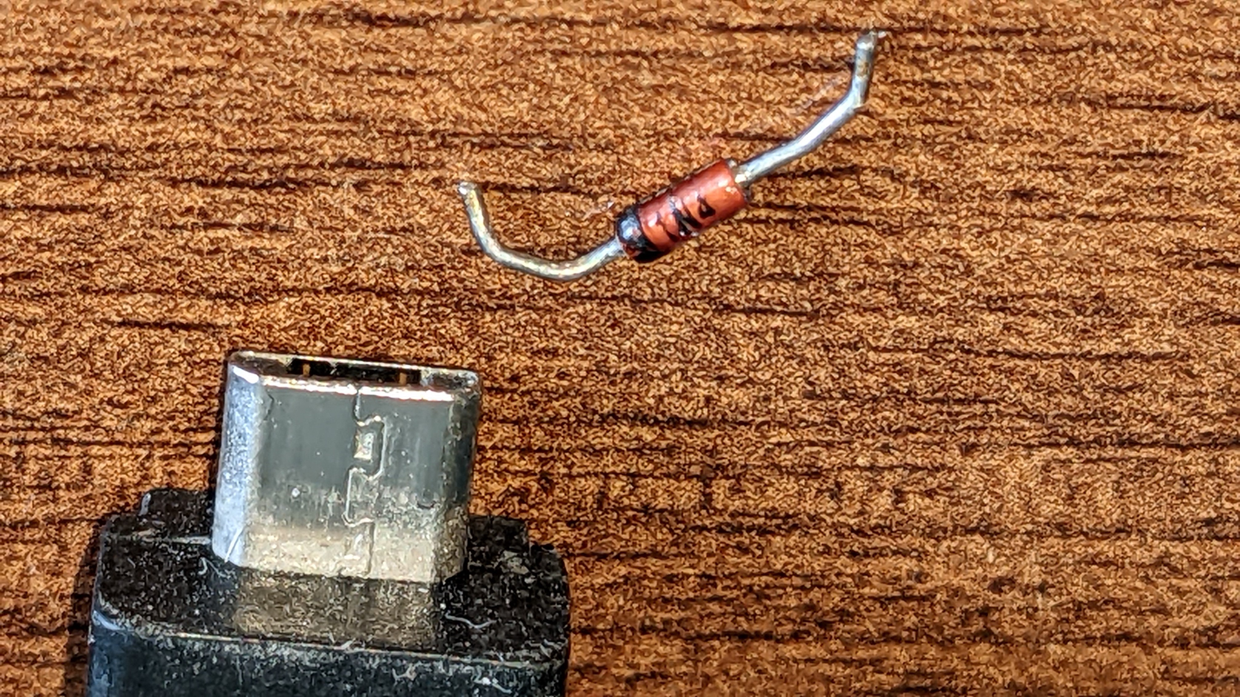

I think the text is 1N4. I have a strip of 1N4148 diodes and wondered if it'd be appropriate to substitute.
Flip over the diode to see the rest of the part number. Based on 1N4, it can be either a small signal diode or a zener diode. These are very different in operation, so the rest of the part number is important.

It's hard to see, this is the best I could get. I'm hoping someone familiar with the IC could suggest an appropriate value.

BTW, you're asking about the diode - is it faulty?. Assuming it's D3 off the circuit above, then it's just a DC rectifier feeding the voltage setting pot, D1 is the supply for the chip (and a slightly bigger fast recovery diode).

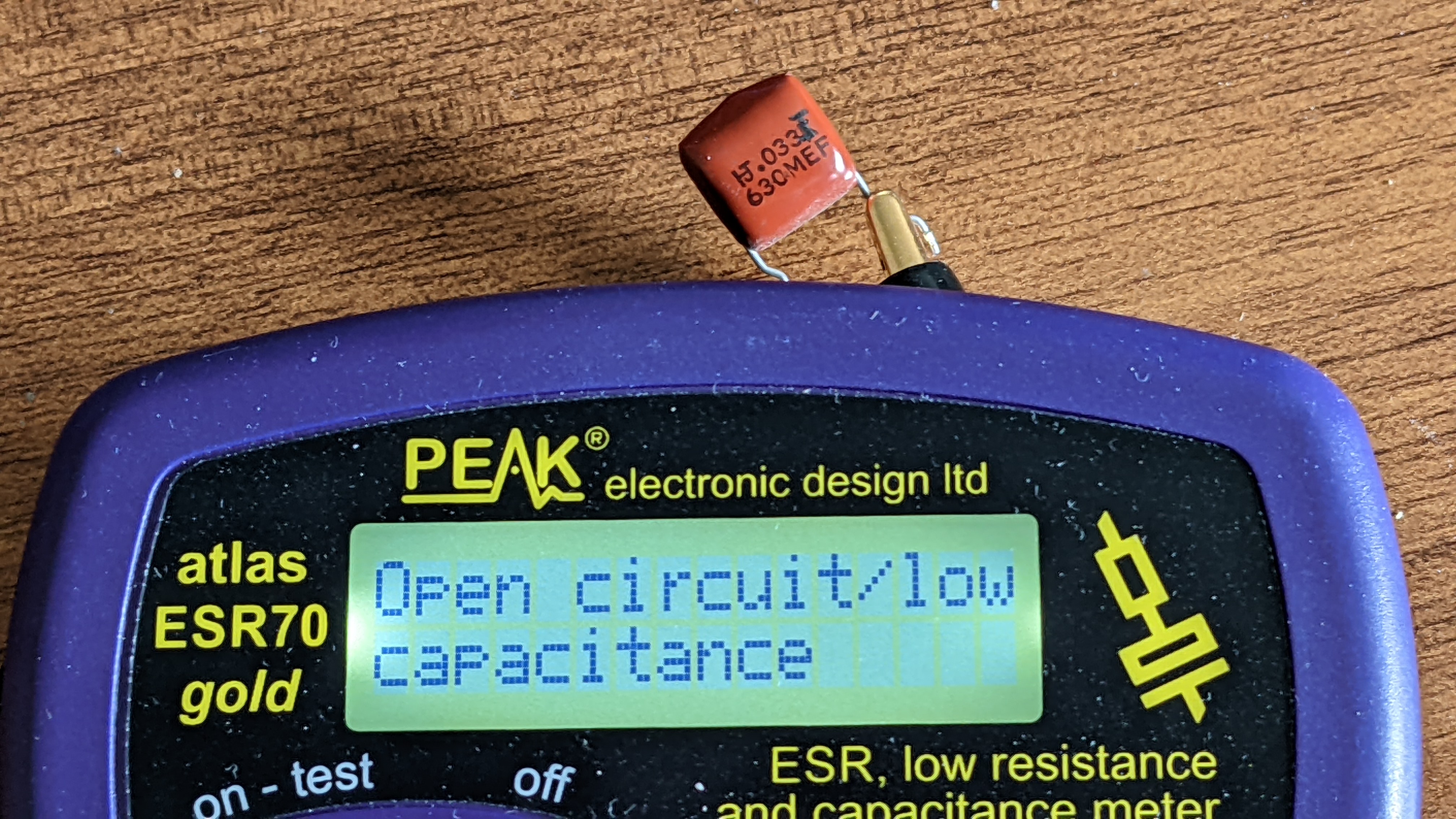

But I've continued to check and this cap, which is in that immediate area (difficult to describe without a diagram but one side is on a transformer nearby and it connects to the IC through another diode) isn't well.
Just to check, because the dot on these caps is confusing me. I have another elsewhere in the circuit that is marked with .33, reading at about 38uF (5% tolerance). So with the extra zero, this one should be 0.33uF?

It's clearly marked as 0.033 - which would be 33nF (or 0.033uF) - but these aren't the kind of components which fail and cause PSU's to die. Having repaired thousands, I've never changed anything like that, and probably never even tested any of them?.
I se on the circuit I posted above that C4 is a 33nF capacitor.
As already mentioned, the 1N4148 is a small signal diode, and not a zener, there's unlikely to be a zener in the PSU.

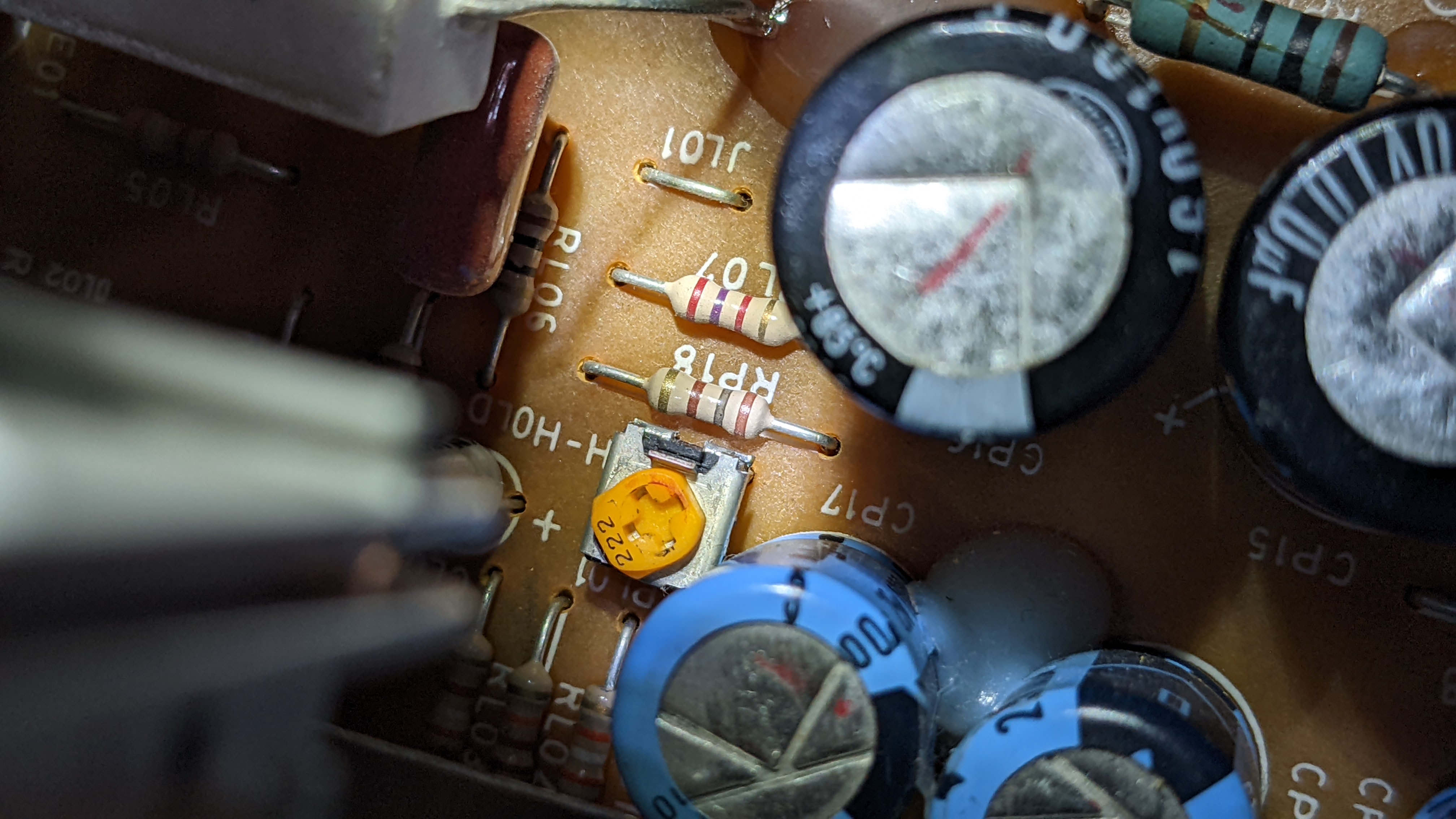

Tested most of everything now, except 5-6 hard-to-see to components I've yet to get to. I'm still trying to find RP19 (RP20 is the highest I can see) but it may not exist. Every component so far seems fine but I've noted that one small resistor on the secondary side of the transformer should be 180 ohms, but is reading as 100 ohms out of circuit. I'm not sure where it would be if it were on your diagram, well over to the right I imagine (the components on this board are numbered according to their distance from mains).

Are you sure that's the value the colour code on the resistor gives it?, it would be EXTREMELY rare for a 180 ohm resistor to drop down to 100 ohm (thinking winning the lottery jackpot every couple of weeks). Follow the tracks, and tell us which component on the circuit above it would be, or at least where each end goes. I presume you're assuming the second coloured band is grey?, it could just as easily be black.
I say this everytime in these types of threads - you don't repair things by randomly removing components and trying to test them out of circuit, you do so by fault finding and experience.
I think you're right about the resistor's value, it's too much of a coincidence. But I'm not randomly testing components, I'm being methodical and testing everything in the area, working outwards from the IC. And the values I'm recording I'll put online so that others can find them when they search for issues with the same model of monitor.

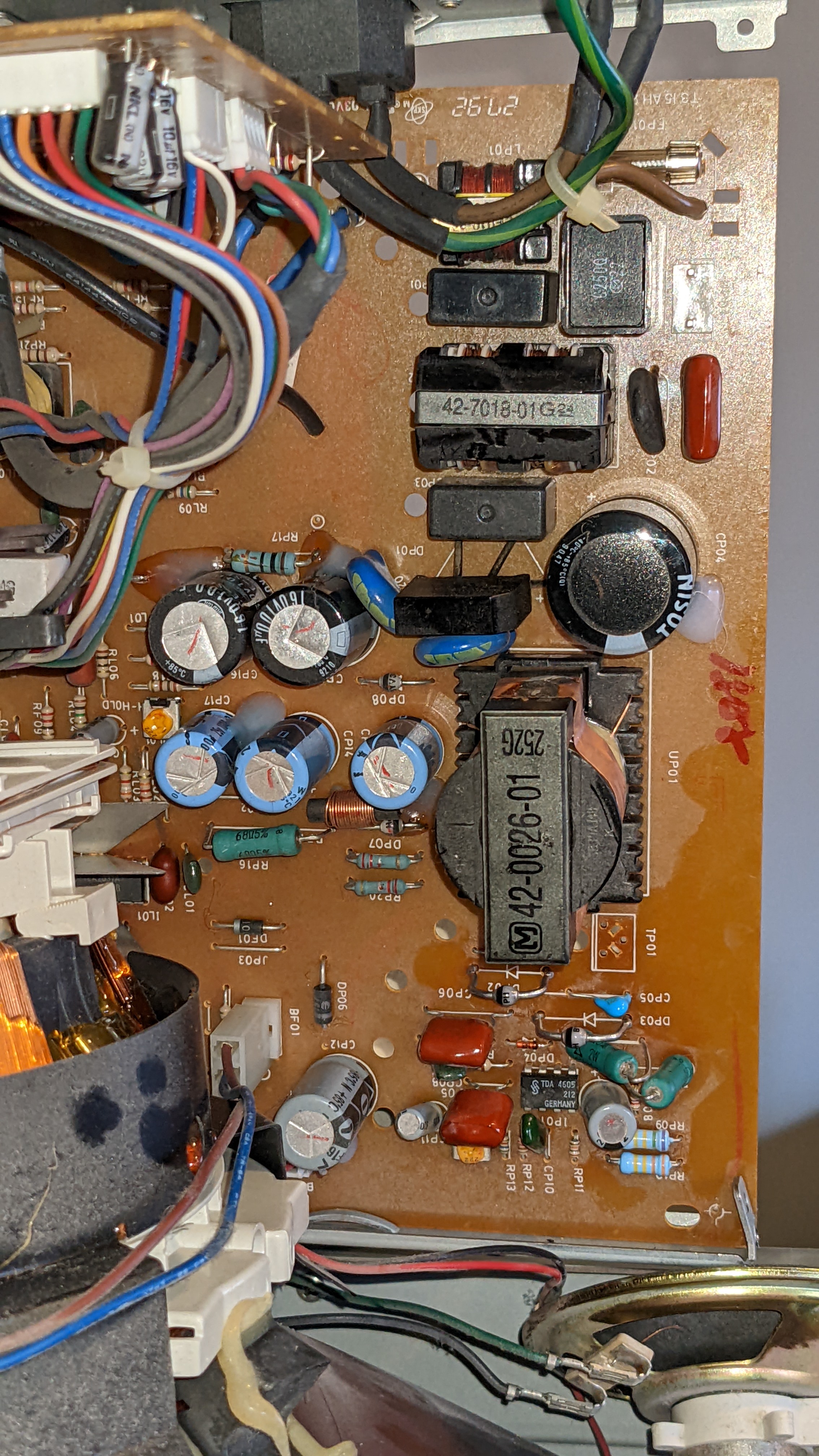

I'm also beginning to wonder if one of the coils in the transformer is shorted, which isn't something I think I can test for. And who knows if I can find a replacement, not having a circuit diagram.
/edit: just occurred to me that if I can't find anything problematic on the primary side of the transformer, I could remove the transformer and attempt to power up?

As I mentioned above, transformer failure does happen, but it's very rare, and in my considerable experience only occurs on certain makes and models, where there was obviously a design flaw in the transformer - from I can remember, out of the thousands of PSU's I repaired, I used to only stock two transformers, interestingly both were for satellite receivers.
Power up what?, and how?.
Power up the power supply without a load, to try and isolate whatever the issue is to before or after the transformer. But I don't know how much interaction there is between the psu and the rest of the board.

You can't really power the primary without the transformer, as the chip is powered by the transformer (D1), plus there's feedback to the chip as well (D3).
Do you have an oscilloscope?, you 'may' be able to test it to some degree - bearing in mind that the primary is live mains, and the scope is earthed, so will go BANGGG!!! if you connect them. Usual solution is to feed the TV via an isolation transformer.
But if you've got a scope, you could test the transformer anyway:
But that antique method does rely on a timebase output from the scope, otherwise you'd have to build a pulse circuit to make it 'ring'.
