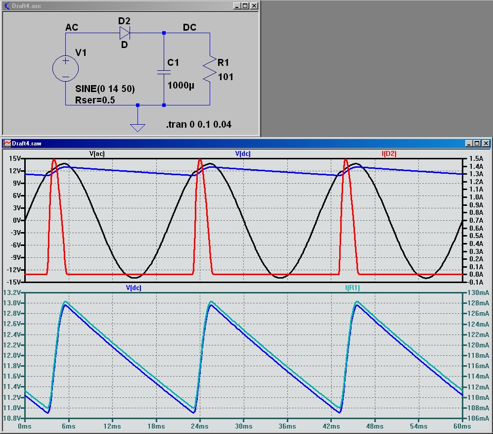

Hello there.
Why does the diode cause ripples to the output voltage?
The diode doesn't cause the ripple. The ripple results from the fact that the filter capacitor gets a momentary recharge every 16.6msec (or 20msec if 50Hz), and then it is up to the capacitor to supply the load current until it gets another recharge during the next AC peak when the diode conducts to refill the capacitor. The larger the capacitor, the less the ripple....
Look at the attached sim. Note the peak diode current as compared to the load resistor current and its duty cycle.
Exercise for student: How big would the filter capacitor have to be to reduce the load ripple voltage to < 0.5V? Why would you rather use a full-wave rectifier?

The ripple is simply the peak-to-peak difference between the two voltage levels. It includes c-d and b-c.

The rectified AC charges the smoothing capacitor which has to deliver the supply DC. If AC changes polarity the cap is not charged during that period, hence the voltage across the cap decreases, depending on how fast it is discharged. The highter the load current the faster will be cap be discharged.
It takes 20ms at 50Hz and 16 2/3 Hz at 60Hz to start a new charge cycle for the cap. Using a full wave rectifier both times are half of that value meaning less ripple with the same load current.
