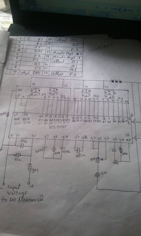

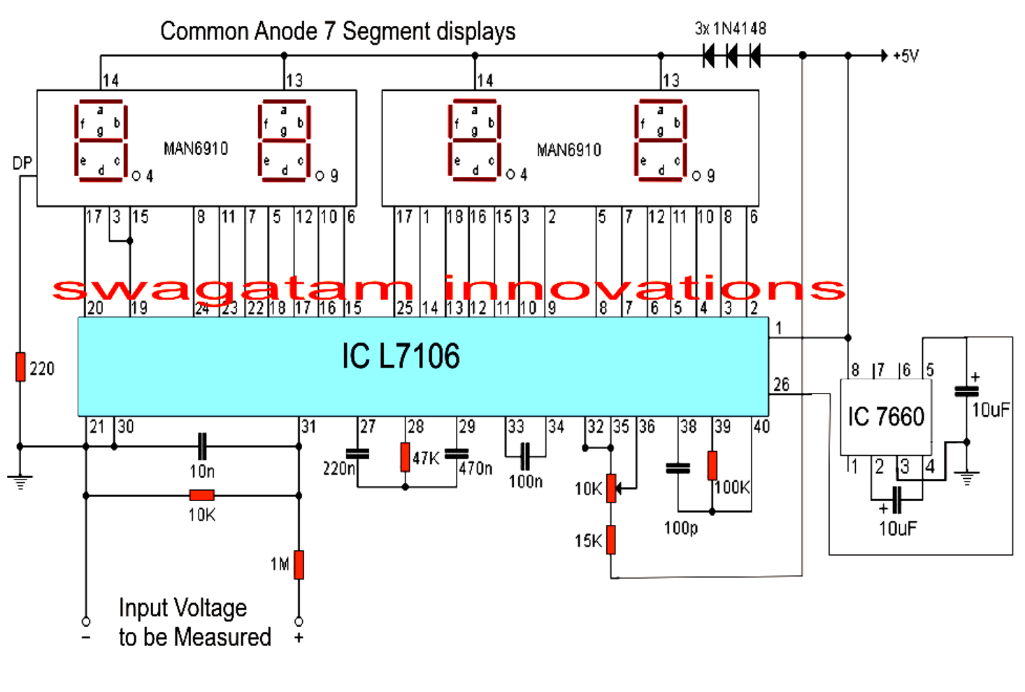

I am also still waiting for the list of components required by the schematic you used.
schematic diagram .......................

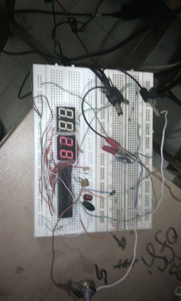

Your wiring looks alot better.
Can you check the power to the chip?
Pin 1 is positive and pin 26 should be negative.
Seems that chip needs 5 volts or more supply voltage.
You may need more than 4.5 volts to get it to work!!!

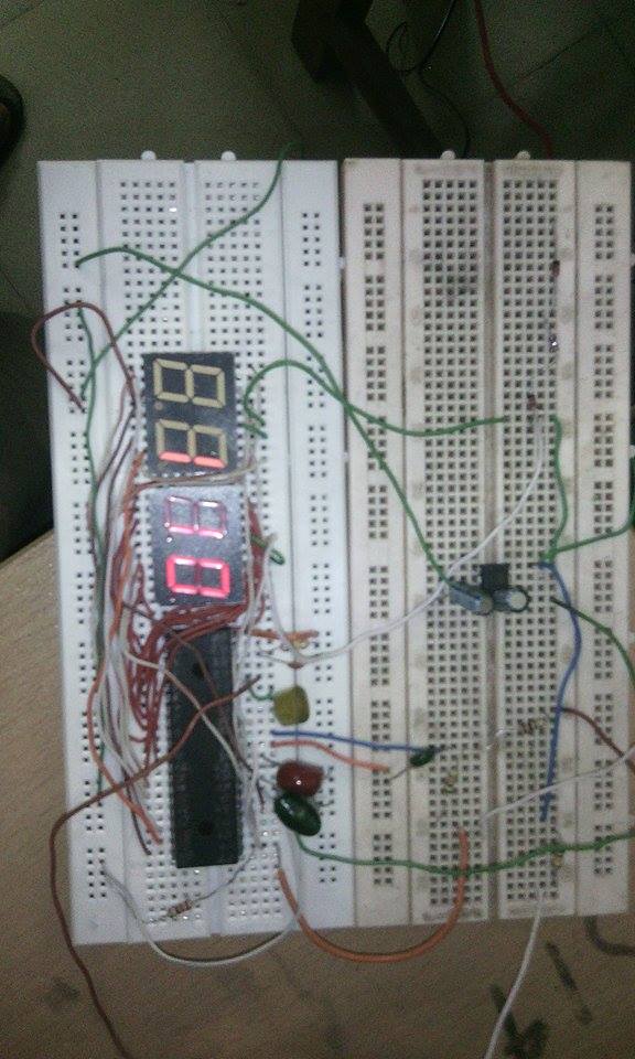

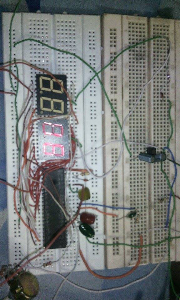

Present situation !!!!

remon7, I was asking for two lists: One of the components you used, and one of the components specified by the schematic. You gave me the one of the components you used, but not of the ones required by the schematic. Or am I missing something?

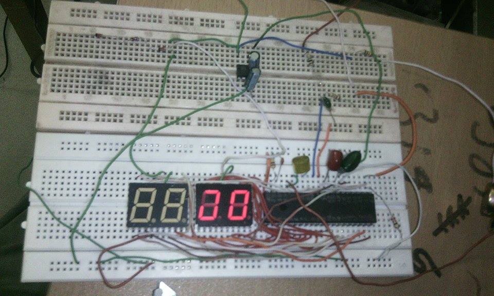

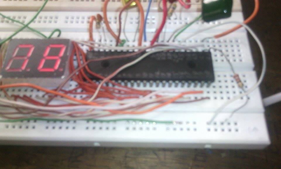

Today i went to lab and applied 5volts but results in 7 segment display its not stable and not accurate !!!!

Ah, my apologies remon7. I did not realize you had combined the two lists. At first glance all the components you used should work. Make sure you fix the voltage issue that 4pyros pointed out though. It won't work if you don't supply the -5v in the right place.

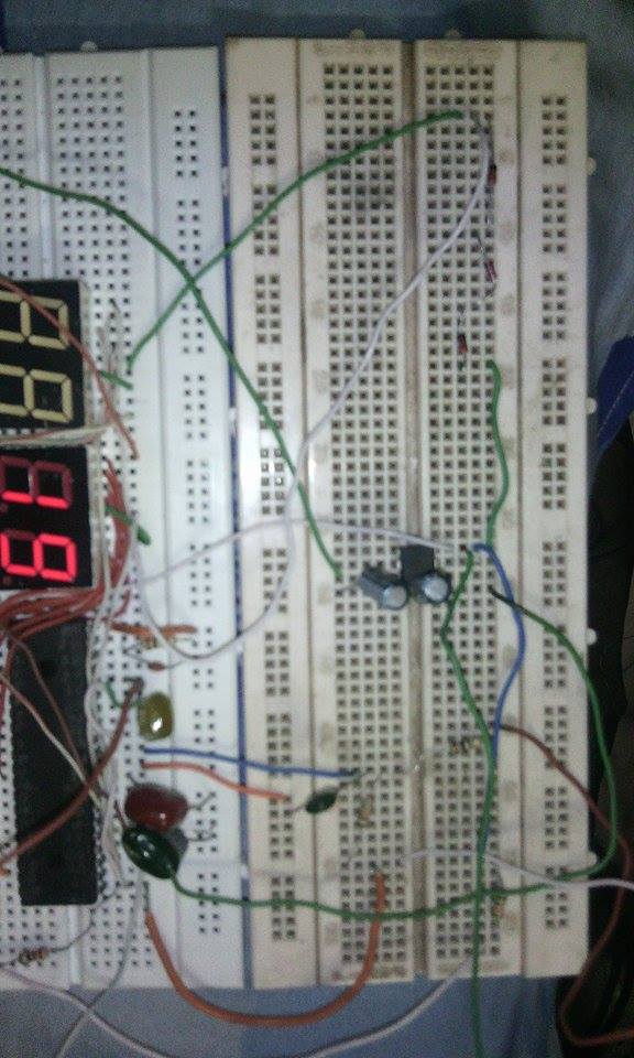

In the Schematic you put on Post #42, the 10uF Capacitor between Pins 5 & 3/Gnd, is in BACKWARDS.
The Positive of this Cap should go to pin 3/Gnd.
The Negative of this cap should go to Pin 5.

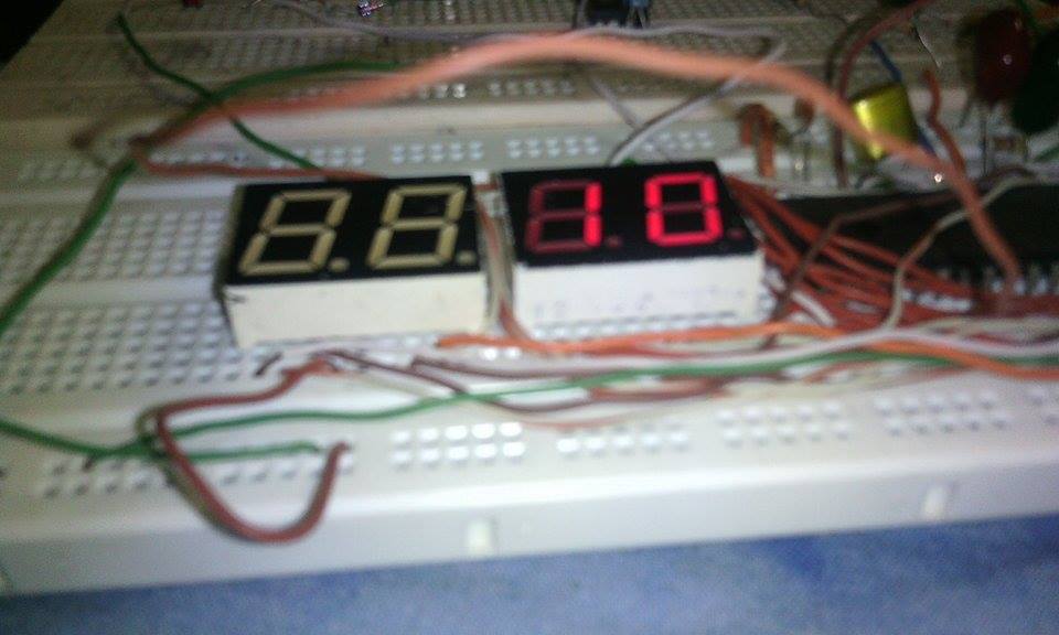

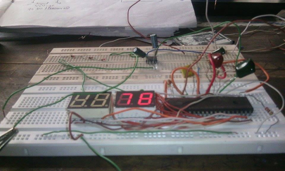

its amazing maybe its working well. To be honest when i am working on this project that's time i was thinking that many people(Engineer )<DerStrom8, chemelec, 4pyros>with me. helping me about advice, planning, ideas. That's why i did not lose my hope. Rather its increased after reading your messages. Look my digital voltmeter >>

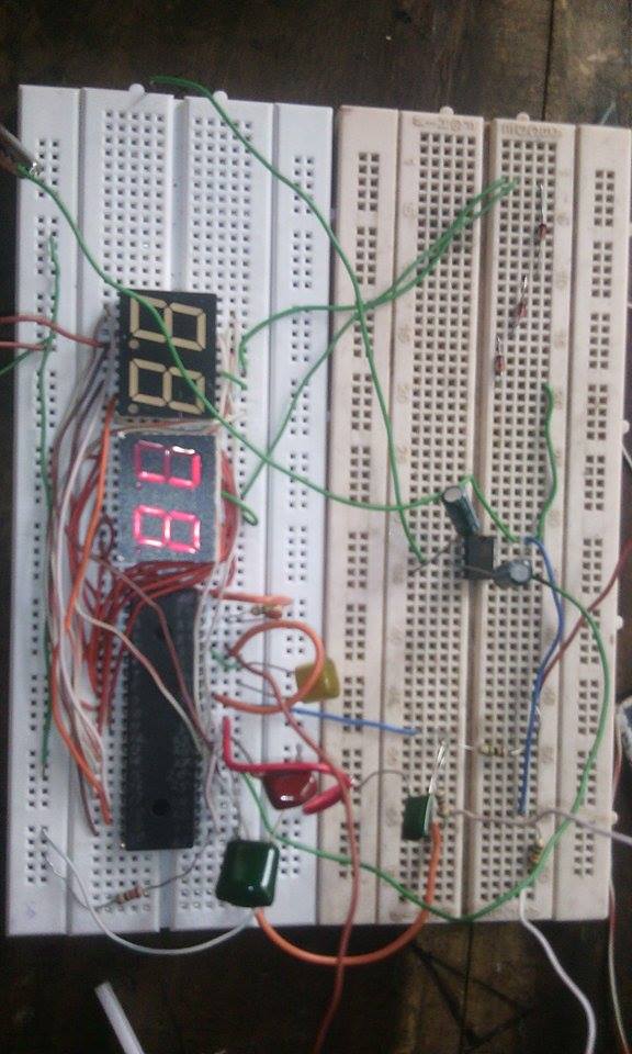

unfortunately its not work well maybe its on right track..Need more Help ....yeah Derstrom8 i used -5 part with 5volt supply negative part and positive +5volt positive end and ground still ground there is no charge . u noticed that in this video first LED Display was off i dont know even when i connected for measuring volts then first LED just on showing me number 1 digit. just it...so tell me next procedure ....

What is the Voltage your Measuring?
Without a Voltage Divider on the Input, Maximum voltage measurement may only be 0.199 Volts.
(199 Millivolts.)
1st LED total off MAY be OK with Leading Zero Blanking.
Again, a reminder - what is your input at this time. Initially I would short the inputs.
Input means measuring voltage is 3volt maybe .......again at home i used 4.5volt for supply but ic wants 5volts. usually in campus lab i used 5volts from power supply ....But its working great at home means in 4.5volts...
(199 Millivolts.)
>>>>>It includes a 3.5-digit LED display with a negative voltage indicator. It measures DC voltages from 0 to 199.9V with a resolution of 0.1V. The voltmeter is based on single ICL7107 chip and may be fitted on a small 3cm x 7cm printed circuit board. The circuit should be supplied with a 5V voltage supply and consumes only around 25mA.<<<<<< please look this website i followed this website ideas >>>https://projectlistinfo.blogspot.com/2013/01/how-to-make-digital-voltmeter.html it says 0 to 199volts.
