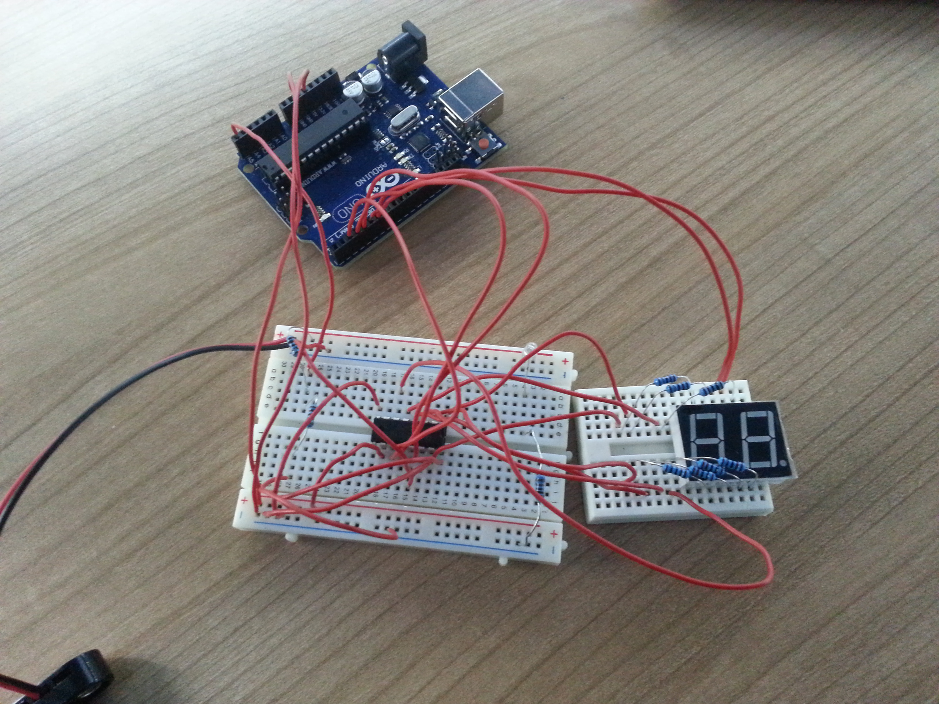

Ill post some pictures or videos as soon as i solder this together (it is all on breadbord for now)
I have solder it together and something really wierd is happening :D
The same 75hc595 on breadbord IS working well and on my soldered board isnt :S
I have checked pins, and pin 8 and 10 are connected to ground and pins 13 and 16 are connected to +5V. Input pins are connected like on breadbord and on all otput pins is 0V, when on pin 6 should be +5V (and it is, on the same chip on the breadbord). So what can be wrong with this? :D
Post a sch and a good picture. And did you put a .01 uf cap on the power pin.
But most likely a bad solder joint.
No i didnt put it. But on my breadbord version it is working. I dont have a scheme, but i can explain it to you, it is easy
I have common catode led display (2 of them with 2 digits ,4 digits all together). Segment pins of them are connected through 1k resistors to outputs of first 74hc595. Outputs of second 74hc595 are connected to 4 "grounds" of displays which when are LOW are active, and that digit shows..
So the difrent from the breadbord version is that here i have 2x 74hc595, and 3 output pins from arduino and on breadbord i have 5 outputs from arduino. Ill post a picture but it is really messed up :D
