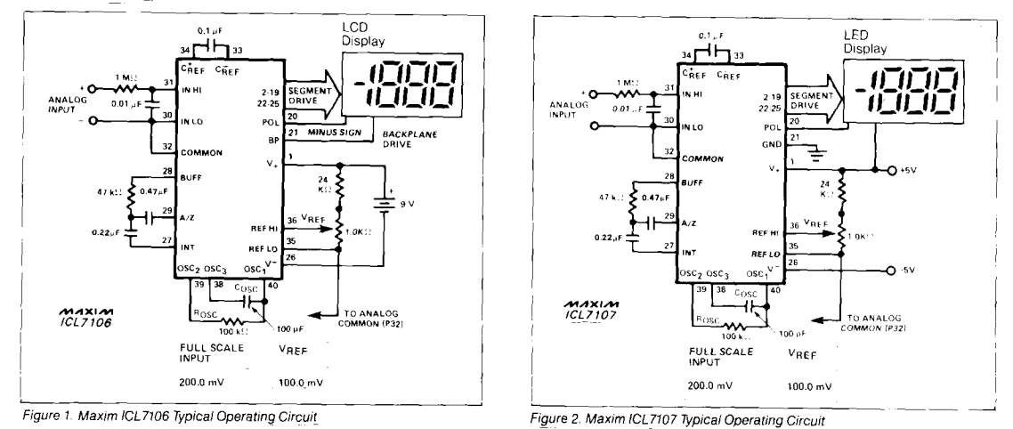

hi Andy,
Compare the two circuits.:)

Hi Eric.
From what I can see the only change is the voltage to the led's
If this is the case then i should not have any probs. Thanks
Also check the BP [back plane signal pin] to the LCD.
Ok Eric, you lost me there, its a very, very long time since I did anything like this. I take it that where pin 21 goes to ground it needs to connected to the led's. if so where ? It looks as if it is for the minus sign ? what if I dont need the minus sign, can this be left as is?
No, the POL, 'polarity' is the minus sign.
On the LCD display, look at the dwg for your LCD, you will see BP pins as well as the segment pins.
They may be more than one BP pin on the LCD, they ALL must go to the BP pin of the 7106.
Another point to consider, if you are displaying 50.0Vdc, is the decimal point, these will also be indicated on the LCD dwg.
OK.?:)
OK.?:)
Hi Eric.
Got it now. Many thanks.

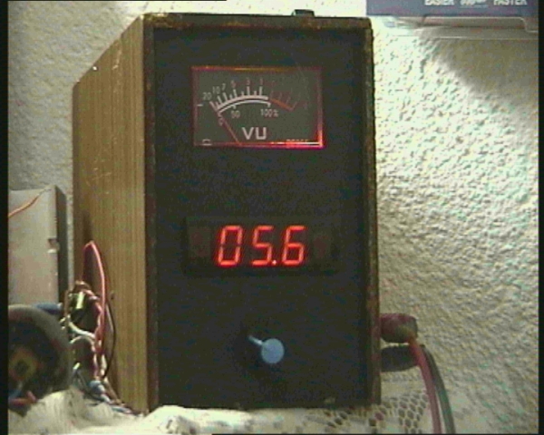

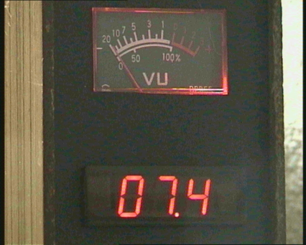

If you use it in bright environment an LC-Display is fine. I used it to make a micromanometer and reading in completely dark air channels requires an LED-display.
Using high efficiency LED-displays the current consumed by the display is below 100mA.
I also used the same power source for the pressure sensor circuit and the DVM circuit. Measuring current the power source must be separate from the circuit to measure.
