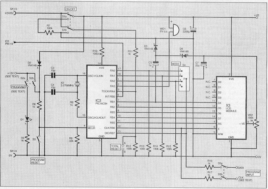

Took a bit of finding - April 1997!.
Here's the circuit:

That's very nice of you Nigel!
Anyways, just a few questions since you have the magazine..
1) Judging by the pinout, the LCD in question would be a < 80 char HD44870 if i'm not mistaken?
2) What is the function of IC2 (not shown but visually tied to INT/RB0 on IC3.. Looks like this is part 2 of 2.. any ideas about part 1?
3) the circut looks like it has its own built in programmer... right?
4) what are the functions of the individual modes, as indicated by the switch S4.
5) I'm rather confused by SK1/3, SK1/4, WD1... WD1 looks like a wall wart (adapter) to me (hope WD /= watchdog, hehe) . SK1/3 ? SK1/4 - tied to ground.
6) How much coding will it take to change the LCD output to a BCD decoder output, as I plan to use 3x 7 segment LED displays.. LCDs are unaffordable and backlit ones are simply pricey where I am.. and we don't have "surplus sales" :(.
7) What I wouldn't do for the WHOLE 2 parts of the article :)

Yes, just a standard LCD module, they used a 2x8 one in the original article.
The other two chips are on a seperate board, and not relevent to your design - they are a PLL and a schmitt trigger - they were used to provide a pulse output from the FGM-3 sensor used in the design.
The circuits for the project are only in one part, there is a second part, which deals with setting it up etc.
It's got connections for ICSP using the EPE TK series of programmers.
WD1 is an audio buzzer, for audible indications. Sk1 is simply the external conenction to the board - basically power positive and negative, and a pulse input.
You would need to rewrite the entire display routines, probably using interrupts to multiplex the displays - see my tutorials for an example.

MM..the 16c84 is sorta discontinued and I might have problems finding it at RS.
Can i subsitute it with the 16F84A? I believe it has an extra 32 bytes of codespace... looks backwards compatible by any means.. any problems? Might be useful if my motorola pressure sensors come in time. Then i probably could integrate vacuum reading too... If I have any I/O pins left.
And I believe the 10MHz version of the chip is used and not the 4MHz one?
anyways, was the 2x8 display they used fully utilized? I'd probably be putting in a 2x16 and will prob want to expand their short forms they used..
How does switch s4 operate? with *eight* modes how is the switch operated?
Actually, umm. what sort of a switch is it in the first place?

You should use the 16F628, the 16F84 is long obselete as well, the 628 replaced the 84 series. The only change required is two lines to turn off the comparators in the 628 - it's also cheaper than the 84!.
To be honest I've never found any difference!, I'm absolutely sure they all come off the same production line and just get stamped differently. There's no possible a way a chip designed for 10MHz is only going to work down at 4MHz (and that's assuming they even grade them at all) - I've overclocked 4MHz 16C84's at 12MHz with no problems!.
Yes it was, with a 2x16 you could improve it - the extra memory in the 628 would come in handy for this! - 2Kb instead of 1Kb.
It's a "4 bit binary, rotary switch".

Nigel Goodwin said:
indecided said:
eight way switch and diodes to create binary data? Now i'm confused..
Think pull-up resistors on the four lines, with each switch connection taking different lines to ground via diodes - so for all ones you have no diodes, and the resistors pull all the lines HIGH. For all zeros you have diodes from each line, pulling them all LOW - for values inbetween you simply wire diodes accordingly.
how does eight individual pushbutton switches and a maze of diodes sound like?
In sounds like the switches don't latch 8)
Oh dear. I can't make much sense outta this.. I can roughly quantify the idea but have no inkling of a circut. Please do elaborate.. I'm pretty keen on using pushbutton switches instead of a rotary dial.
OTOH, am I supposed to be looking for a decimal/hexadecimal rotary?
parts num 333-091/333-085 on RS (Rotary Switches)
