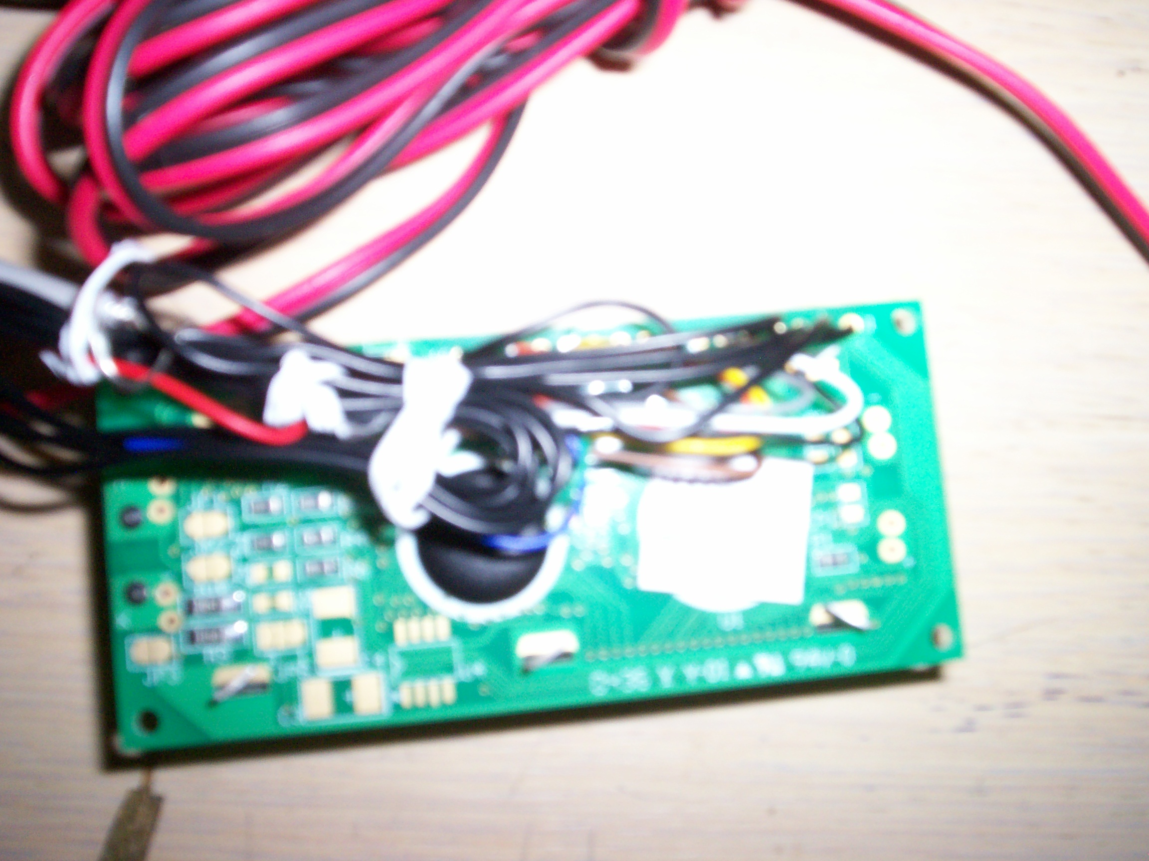

i make speedo out of AT90S2313 because the ATTiny2313 was not available where i am (Australia), and i don't purchase parts over the net. Fortunatly www.jaycar.com.au had the AT90S2313. i put the everything together using a pcb prototype board, 2-core dc power cable, 9-core computer cable and scraps of 2-core shielded averaging about 1m long each that i picked up when i was train testing. i still need to aquire the crystal which i can get in store. the pcb on the outside is where the crystal will go because i couldn't fit it on the pcb.

First off this is an old post. And I guess you could not start a new one.
Second, a 1200A has an internal OSC so you would not need the Xtal (same as the old 2313 and no RAM, use the registers for your RAM).
Third, you have blurred picture, no schematic posted and no code. I doubt you will get any help.

Also, you mentioned that you put the crystal on the outside...
It should be as close to the chip as possible...
the crystal is on a seperate cut-off of pcb. the was no adequate room on the pcb, all i can do is shorten the length of the wires. this might be the problem, avr freaks said the code look a little bit dodgy
You need the xtal on the same board and the two caps that go to ground as well. Can you use a socket and tack it to the bottom of the board? Then plug the chip in?
AVRfreaks are great, but you are back here. Glad you are back, and the pictures are very blurred. People will help if you comply..
And the program goes in flash not the eeprom.
yes i've worked that out. avr freaks say that the code is dodgy (this part):

i have to find a COMPETENT board, and transfer the ic socket, regulator and wires to it. and if someone has got theirs working could the please post a picture of the lcd, when it is turned on?
