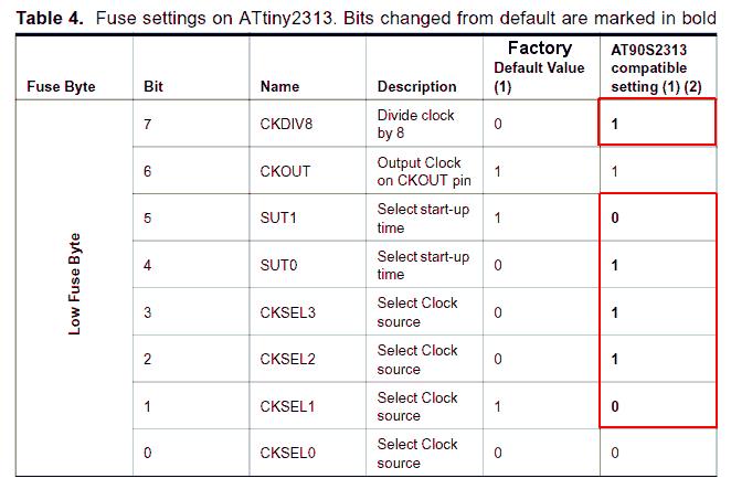

fever said:
i heard that AT90s2313 contain 2 fuses where as ATTiny2313 has lot of fuses.
Not a lot, only 17 fueses! :)
They are inside three bytes called Low/High/Extended fuse byte. However, the ATTiny2313 designer has already taken care of the user wanting to change to Tiny2313 by providing a table of fuse setting to be used.
The table is inside a migration document here:
AVR091: Replacing AT90S2313 by ATtiny2313
and also posted here for you with changes marked in red. Only the low fuse byte is shown as default factory values are used in both High/Extended fuse bytes and doesn't need any change.
I have a brief look at the link you posted.
The clock selection in the webpage is "crystal, 8MHz or higher" while in the table by ATMEL is "crystal, 3-8MHz".
If in doubt, check the AVR2313 datasheet page 26 doc2543.pdf.
