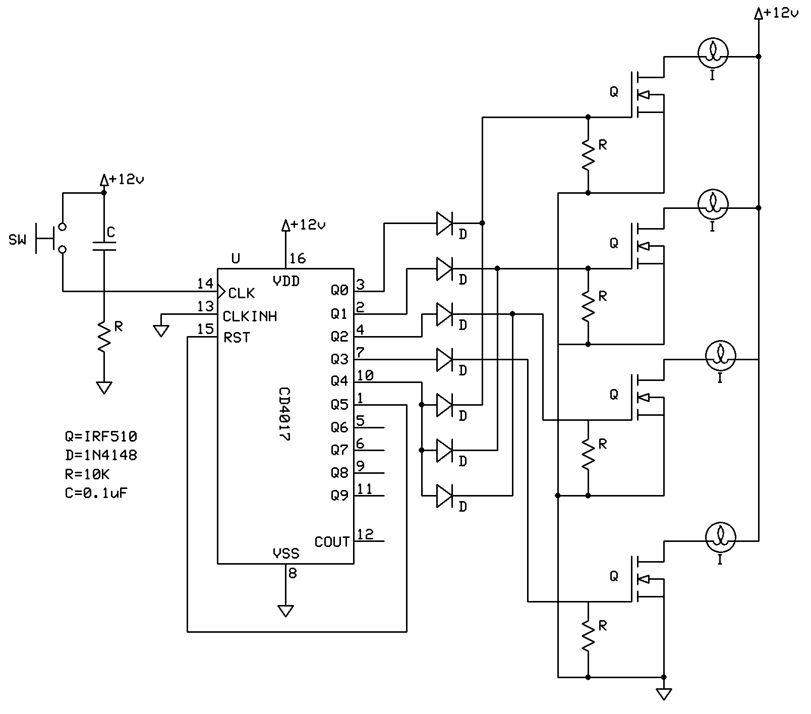

Hi, not sure i used the correct terminology, correct me if im wrong.
I want to remove a 4 way slide switch and replace with a push button switch that has 5 outputs that i can hook to relays. or it they can push out over 200ma. Again schematic / circuits appreciated.
thanks
What's the voltage associated with the "200mA"? Do the circuits to be switched by the circuit or relays have a common ground? Are the selections to be 4 outputs and an OFF, selected one at a time?
Ken
Working voltage between 9v and 12v.
I can either output 12v 200ma direct to a light, or can use to trigger Relay to power the light.
I woluld like 5 positions, 1,2,3,4 = on / off individualy, 5 = 1,2,3 On all toghter(position 5 isnt essential and can just be the 4 switch)
They all use common ground depending on voltage, if we can use 12v for the switch then the whole setup can be common ground.

1-all Off
2-1 on 2,3,4 off
3-2 on 1,3,4 off
4-3 on 1,2,4 off
5-4 on 1,2,3 off
6-1,2,3 on 4 off
Ken
Yes, the MOSFETs will handle up to 5A.

Hi Ken,
I suggest to have the counter being reset by Q6(pin5). That way you'll get "all Off", or shift the diode network from Q0 upwards (leaving Q0 unused) and still reset from Q6.
A 4017 has Q0 high when reset.
Regards
Boncuk

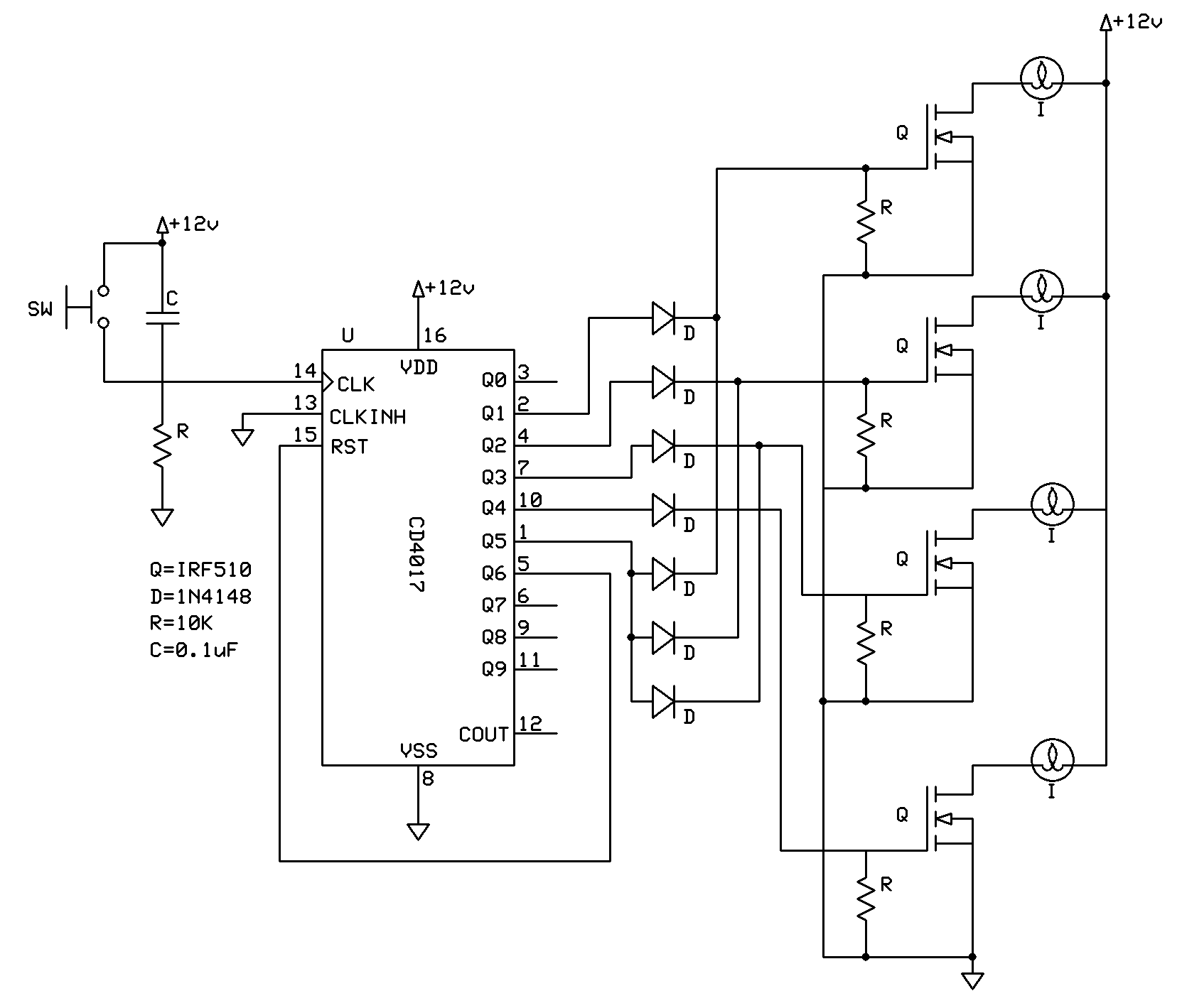

Thanks Boncuk,
Not sure where my mind was. I'll correct the schematic.
Ken
Corrected schematic:

Hi again Ken,
I assumed you will correct everything of your schematic. :)
Connections SW, R, C and CLK have no junction.
The same applies to the gate discharge resistors of the two bottom transistors, where the latter missing junctions are self explanatory (meaning there must be a connection).
The first one could also be a crossing.
Regards
Boncuk
That sometimes happens when exporting a ExpressPCB schematic to a .BMP, cropping it down in Microsoft Picture Manager, and then exporting as a.gif.
There should be a junction there, as well as at the top of each gate resistor. I'm going to have to find a way around that problem.

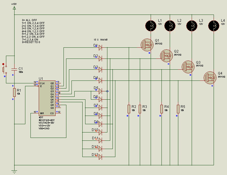

Here's the super de luxe version of the lamp sequencer. :)
Boncuk

Decided to play a little with the ExpressPCB export. Found my problem with the missing connections. Though the intersecting wire connections appear to be there on the screen...little gray boxes at the junctions...the actual connections were never make. The gray boxes were just the wire ends. It would have been caught had I linked it to the PCB layout program. :)

just to throw a wrench into the works, but instead of having the 4017 reset from otput 6, couldn't you just double up the outputs to use all of them? i see no reson why it can't be done. Boncuk, what circuit simulation software are you using?
You would have no All-Off selection...and it would require 7 more diodes, to save 1 piece of wire, to do the same thing. ;)
Ken
