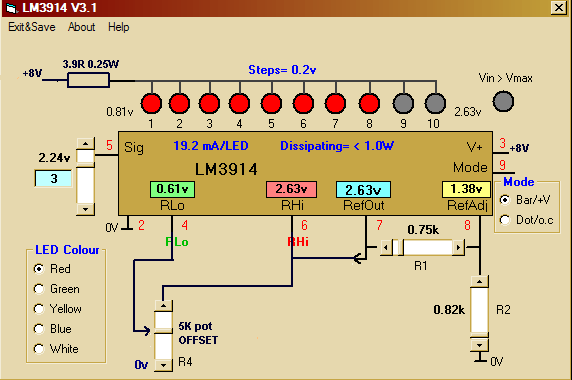

Hello Eric,
I'm using another LM358 that I just bought this morning. Measuring every resistor doesn't give accurate readings like 470R rates at only 457 Ohms etc... will these affect vo1? Almost every resistor doesn't give exact readings.
How about if we'll just make the LM3914 minimum to 0.64v? Even if i connect VS to the ground the minimum of vo1 is still 0.64v lighting the last 2 LEDs.
OK,
I will post a value for a resistor on pin# 4 on the LM3914, so that you can adjust off that 0.64V
EDIT:
Wire up the LM3914 as shown in this image, the 5K pot will enable you to back off the +0.64v at the EMPTY tank end. LED#1.
I have built the tank sensor using LM358 and it works perfectly OK.??
I cannot say at this time why your version is not working as expected.:)

Thanks Eric,
Just to clear things up. All 3 pins of the trimpot will be used this time right?
Leg #1 connected to ground.
Leg #2 (wiper) on pin #4 of LM3914.
Leg #3 on pin #6 of LM3914.
Is this correct?

hi bb,
Your connection details are correct...
Just looked at the 'bb' , with the extra 5Kpot on my project board, its working away happily.!

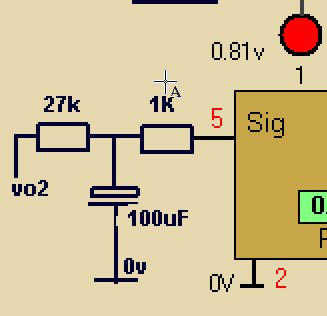

Hello Eric,
Our fuel gauge is still working fine, thou fuel sloshing is very annoying. I have bought 1uF non-polar capacitors (remember the 1uF we discarded?), will these alleviate the problem? Or we need a major modification to average the fuel readings?
I will look and get back to you.
EDIT:
This should give you a quick solution, if not let me know.
If you have a larger value than100uF [ say 470uF] it will be ok to use it.

Wow never thought it would be that easy to modulate sloshing. Thou I won't be able to try it till tomorrow since its already 11PM. I'll let you know tomorrow. Goodnight!
@MikeML thanks mike, but it seems that eric's quick fix did a good job already and sloshing was gone.
@Eric, your sloshing fix was perfect. Now it really is an awesome fuel gauge. Thank you so much for all the time and effort.

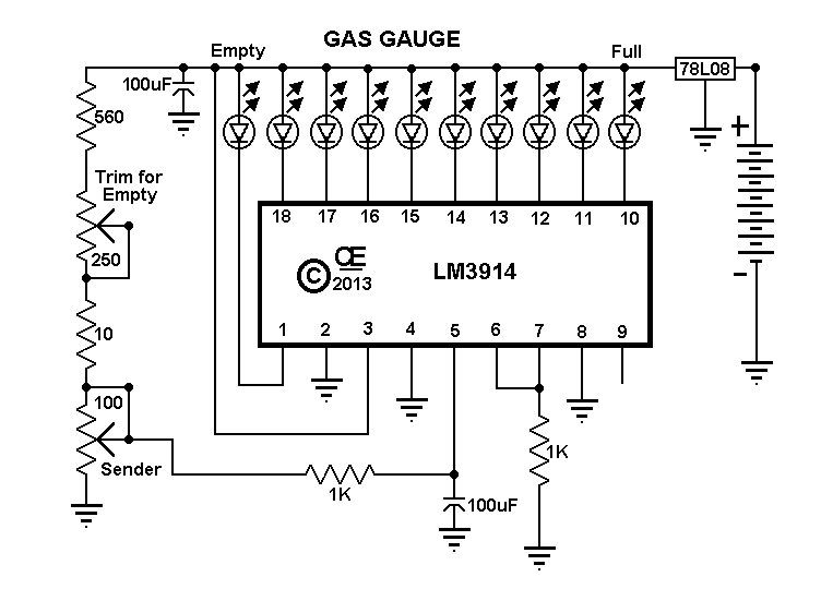

This Circuit should also work.
Just arrange your LED's so the Full LED is at the top, Or Right side.

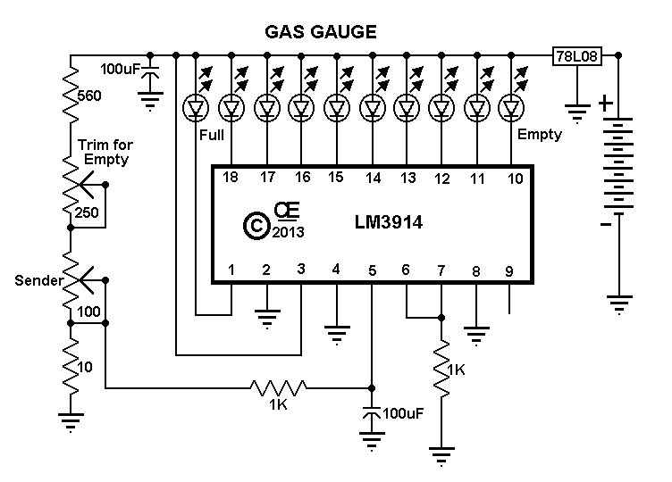

I Prototyped this up and it Works.
With a Full Tank, Adjust the 250 Ohm Pot to JUST Light the Full LED.
