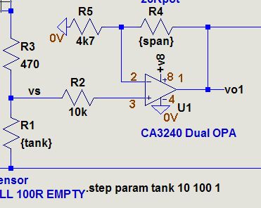

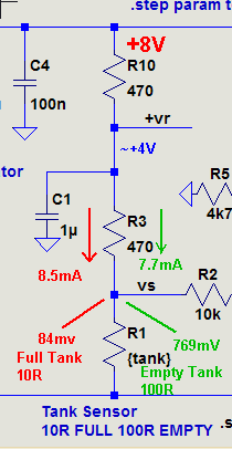

Ok,
Look at this section of the circuit, you must have a problem in your build.??
Measure the current in R3, compare it with the image.
For a 22R tank sensor that voltage should be ~180mV

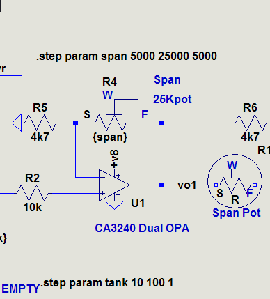

Pleased to hear you have fixed the problem.
This image shows the effect of changing the SPAN from 5K to 25K.
You could connect a fixed 10K resistor in series with your SPAN pot, this would give a change of 10K to 35K.
Check the voltage input to the LM3914 pin 5, when tank is empty, it should be close to 0V.

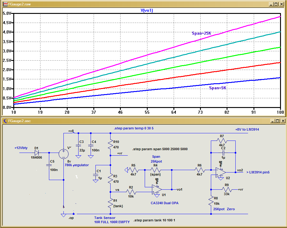

hi bb,
We seem to be making progress.
For the SPAN pot not to work, assuming its wired correctly, then it suggests that R5, 4k7 may not be connected to 0V.
Check against this drawing

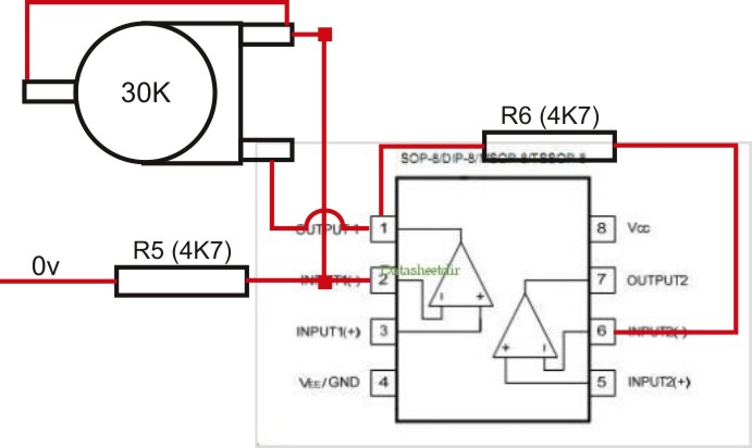

I can't seem to find any errors on the wiring and build on that area unless if my trimpot wiring is wrong. I used one leg of the pot and the wiper (which is connected to the other leg with a wire link). Please see attached picture.

Your diagram looks OK.
Have you built the circuit on strip board,, if yes, make sure you have no copper strands shorting.
Also have you tried another OPA,, are you sure that 4k7 resistor on pin 2, is not 47K .???
The gain control should work OK.

Can you confirm that varying the tank from full to empty gives a voltage on vo2 as shown on my earlier plots.??
The results you are getting are puzzling.
Please do the following.
Using a voltmeter, measure [vs] thats at the R3 and tank junction.
Varying the tank sender from empty to full and tell me what you measure.

I posted this testing image yesterday, I thought you had carried out this test.???
Testing (VS) from full tank to empty measures around 0.07v to .78v which is correct.
