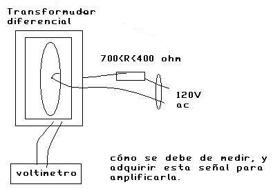

I am using a differential transformer to sense unbalanced lines.
When it happens the toroid (differential transformer) induce a current and so a voltage accross the terminals of the differential transformer.
for currents as low as 26 mA ac induce a voltage of 129 mV ac and for currents of 830 mA, it induces a voltage of 7 V ac.
I would like to measure this signal to prevent electrical damage on communication equipments. But I have no idea of this kind of electrical considerations, I have never done a design with this kind of transformers.
When I put a resistor of 98Kohms between the two terminal in ordet to measure just the voltage so in this way I supposed not to demand current to the transformer, the measured values changed.
Asking about this matter, someone told me that for this toroids large resistors can saturate the core of the toroid, but a lower resistor can avoid it.
Does any one can help me how to read the induced voltage in a differential transformer.

Inside the section I pass one wire from the 127v outlet, then I conect a resistor to reduce or change the current through it, so in this way by using a multimeter i read the voltage in the two output terminals. But when I tried to design an amplifier stage, I had problems with my readings becasue the values changed, so I woulf like to design an amplifier stage becasue when a current of 30mA pass through the resistive load in the diferential transformer a voltage in induced around milivolt is induced and I want to amplify it.

when you use multimeter to read output terminals, are you referring to another loop of wire wound around toroid? I understand that you have 120V source with series resistor making one loop around toroid. You then read voltage induced (in another loop) around same toroid? Please clarify this.
Your AC source is 50Hz? and the toroid is a low frequency type rated for that? I can't read spanish but based on the numbers given, they don't look like very useful specs anyways..
Yes your right,
I measure the AC voltage (120 Vac) with the multimeter at the outlet, when I put a resistor then this loop is closed, if I connect the multimeter to measure the current then I put it in serie, when I have already measure the current (the voltage is known), I move the multimeter to the terminals of the diferential transformer.
This transformer has two terminal where in there I measure the induced voltage, with the multimeter. This is not a loop but I have to close it with an OpAmp or a resistor in order to sense the voltage by an ADC.
The problem here is this; when I connect a resistor in the terminals of the Differential transformer the voltage values change, I mean the voltage at these two terminal is not the sme as when I measure it in a open loop, as you can see in the figure.
The figure shows an open loop, a measurement just with a multimeter, but instead of doing it by an instrument I want to read this values by an ADC, it's here where I have problems, because I do not know what to do. How I should measure the induced voltage?
When connected a resistor of 100K in this to terminal the readings changed, I think the toroid was saturated
I have no electrical parameters of this diferential transformer, it is a WG-70 or 35 transformer from circutor
there is just physical parameters, size, weight etc.
What can I do?

Try this, keep the resistor in the 120V loop and put the same value resistor in the measure look (where you want to sense induced voltage). Now, all you have created is a 1:1 transformer. We still don't know for sure if the core is saturating but once you have this arrangement things will be easier to predict.
With your 1:1 transformer and ignoring Xm (magnitization inductance) and leakage parasitics for the moment, you should see the same current flow in your output (Vinduced) loop. You can measure this with a scope or possible RMS meter. Make sure the measuring device input impedance is much much greater than the resistor values in the loop (usually is ok)
If you do not see the same current and voltage measurements (approximately) from the input loop compared to the output loop, then something else is happening like saturation. If it is saturation, the core will get warm(is this happeining) and you will get different values.
If this is not the case, just use this method for sensing. Since you are wishing to amplify the signal, why not get some amplifying with turns ration on the transformer? If you have one turn on input side and 10 turns on output side, you will get a 10X on voltage (approx).
There are alot of other considerations to make about the design but for now, try and learn something about the toroid you have to use by performing the simple 1:1 experiment.

830mA flowing in 131 Ohms on the output side (131 Ohm is across terminals)? And you measured current in 131 Ohm how? The numbers by themselevs are not making sense let alone the changing values. Dont worry about the changing values yet. First you have to get a predictable output so you can understand how it is working. You are sure it is 500:1?
Also, what value are you using on input side (700>R>400) what is its value?
Sorry, the value of 400 ohm in the figure should be less.

With your 131 ohms on input side (830mA flowing), short circuit output terminals and measure current though it. What is output short circuit current? If we assume it is 500:1 then you should see about 44uA flowing if your core is not saturated. The other thing is the magnitizing current may be a significant fraction of your primary current.
Remember, this thing is a transformer so when you add 100k on output terminals and "load" the transformer, this impedance is reflected back into primary side and that current will change. 100k is much greater of a load than open circuit (no load just volt-meter) so the changing values makes sense to me but I am still wondering if it is not saturated or even if the 500:1 is correct. You need to find an operating point that shows the turns ratio without a doubt.
Please give me a hit for the design
Optikron considering what I have done, can you imagine what would be the input impedance of an operational amplifier?
or which configuration you recommend me? how I should read this signal by the ADC.
You got it too, I read 44.1uA in the terminals where the induced voltage is generated when a current of 830mA passed inside the toroid.
This current was obteined with the resistor of 100K 1/2W and the multimeter in series to measure the current.
I haven't measure the current in short circuit (where the induced voltage is generated), just the voltage in open circuit.
Also voltage and current in close loop with the resistor.
how did you get 44 uA
Thanks a lot Optikron
In the right upper corner, are the two terminal where I measure the voltage.
inside the circle I pass one wire from the monophase AC voltage to generate the current with a load (Resistors of 840 ohm in series and in parallel to change the value)

What you need for sensing is an I-V converter. The simplest I-V converter is a resistor. Let the transformer drive your resistor and just measure the voltage of that resistor for sensing. Use your opamp for that.
The input impedance of an op amp is very high but also dependent on the process used.
In the specs for op amp if front-end is made with bipolar transistors, then the bias currents they need will be in microamp range. Feedback will boost the input impedance by order fo magnitude.
You can expect 10's to 100's of megaohms at worst.
If you use a "FET" input type, this number goes up to Giga-Ohms even Tera-Ohms (for electrometer types).
It's safe to say that your opamp circuit will not load the transformer at all. But you will delibrately put a resistor load on the transformer making it drive 100k or whatever you end up with.
Will one end be grounded? Be careful with common mode voltage range in your design. also, consider using an instrumentation amplifier if you can live with less than MHz bandwidth.
Also for highest signal sensing level choose the resistor to provide the amp the largest signal it will allow for the worst case sensing condition. Then in subsequent stage(s) attenuate and level translate for appropriate input range of ADC. So that you do not start off with a signal so small that noise prevents you from sensing properly.
Also be sure to account for worst case line conditions. If that phase is normally 120V you can bet there will be times when it is much higher.
Also keep your opamp circuits away from the high current side of the xformer because there will be strong magnetic fields present and your wires will pickup 50/60Hz form that easily in the 10's of mV or worse levels. And also wire the circuits so that you do not create any large loop areas with supplies and grounds because those will also act like another loop of wire around the xformer also picking up the field.
try it!

I read this post this week-end and I got sick. Now I feel better and I was thinkg about your ideas.
By the way, I really do not understand this part:
What resistor refers to? an external resistor or the resistive value the transformer has
This too:
I am thinking on the design, I suppose it is better to connect directly the xformer to the opamp, using the two inputs, I realise that instrumental amplifiers can handle it, the book I am reading about this, one terminal is connected to the ground vie a resistor.
I do not know if it makes to one of the wire that comes from the xformer be grounded.
I know that measuring the voltage is easier that measuring current, that is the the purpose. However, something cause me noise. the impedance you talked, it will affect the voltage value as I told you before, when I put an external resistor between the two terminal the voltage drop from 7.17@830mA to 4.43@830mA
I did it becasue I wanted to measure the current.
PS:I am still extracting ideas from what you said me in your post
thanks a lot
