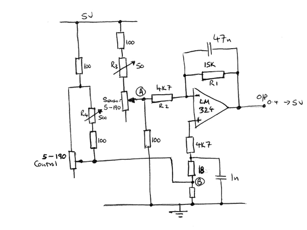

I'm hoping for a bit of help with the circuit shown.
Its 23 years since I last studied op amp circuits and the old grey matter going a bit soft so I hope you can help.
The circuit is part of a control system for positioning a hydraulic ram. R3 and R4 are trimmers to set max and min up/down position of the ram designed to be set to R3=10 ohm & R4=25 ohm. The control variable resistor is moved by a lever the operator moves, the sensor variable resistor (identical to the control one, both 5 to 190 ohm) is mechanically linked to the ram and provides position feedback to the circuit. The output of the circuit is supposed to vary between 0.4 and 5v. The output is supposed to be 2.5v when both variable resistors are in the same position and the ram is motionless. The output is fed into some comparitor circuits that produce up/down signals to move the ram, this bit of the circuit I understand. It's this bit of the circuit I can't analyse properly.
How I see it at the moment is (and I am probably wrong):
It's some sort of differential amplifier.
Gain is R1/R2 = about 3
The voltages at points A & B are basically set by the resistor chains, which act as voltage dividers.
The control variable resistor varies voltage B from 1.66 to 2.5v.
The Sensor variable resistor varies voltage A from 2.5 to 1.25v.
There are a few capacitors but this is basically a DC circuit.
Any help in analysing / understanding this better or anyone seen the same circuit used elsewhere gratefully appreciated.
(sorry about the diagram quality)

I haven't got time to study that circuit at the moment but it doesn't appear to be a standard differential amplifier, it looks moke like a normal inverting amplifier with a capacitor to intoroduce another low frequency pole.
There are plenty of differential amplifier tutorials available on Google.
You could add the capacitors in parallel with the 0V and + input resistor and the - input to output feedback resistor.

There appears to be too many parts. I suspect that you could do it with less.
You basically need a Wheatstone Bridge circuit so that it is balanced when the Ram position matches the setting of the control variable.

I haven't checked the voltages you mentioned, but basically you have it right. The difference between the two input voltages is output as an "error voltage" to tell the RAM via the comparaters which way to go. The 47Uf slows the circuit down enough so that the RAM doesn't "hunt"...
That's what I thought at first, but once I read his post more carefully I realized that the "extra" POTs were trimmers for the feedback and control POTs.
What i can see is Yes it is a differential amplifier and basically a DC circuit. The capacitors are here to suppress noise / spurious signals to provide stability to the circuit. The circuit is easy to analyse with simple voltage divider rules. I think you have analysed correctly.

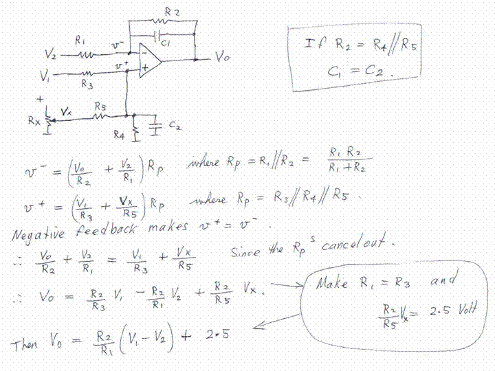

Here is how I would do it.
It is a diff amp with an offset adjustment (Rx) so that you can set the output to 2.5V when V1 = V2.
V1 & V2 are generated by the Control and Sensor pots respectively.
Connect one end of the Control pot to + (via a resistor if you need to limit the range) and the other end to gnd (also via a resistor if necessary)
Do the same with the Sensor pot.
I have used McMillman's Theorem to derive the expression for Vo.
Note that R1//R2 means R1 in parallel with R2.
Make R1 at least 10 times greater than the Sensor pot value so that adjusting the pot does not alter the situation much.
Make R3 = R1 and R2 = R4//R5 so that C1 = C2.
By "+" I mean the positive supply voltage (I don't have the internet open at the moment so I can't look at your circuit)
If you have any questions, just ask.
Edited to correct an error.

Thanks all for the feedback its much appreciated.
Just to make things clear, this is part of an actual circuit that has been in use for 20 years or so. I have come across it recently doing some charity work and im trying to understand it as well as i can.
Your replys give me confidence that im roughly on the right track. I agree that its not the tidyest of circuits and could probably have been implemented better but this is whats there.
The bit i cant fathom is a formula for V out in terms of the control and sensor variable resistor values but thats my problem.
I realise the capacitors shown are really there just to deal with transients when the variable resistors are moved.
The comparitor circuits (after V out) compare V out with 2 and 3 volts (more resistor voltage dividers) to create either an up or down or no change signal.
Maybe looking at V out in terms of the control and sensor variable resistor values isnt the way to go.
Im glad its not an AC circuit cos then i would be into poles and zeros and well stretched beyond what i can remember about mr Laplace

The trick is to calculate the voltages with the Op amp disconnected
and then calculate what the Op amp will do when the connections are restored.
It is easier to do the calculations if the resistors going to the + & - inputs
of the Op amp are at least 10 times greater than the pot resistances.
Then the loading effect can be ignored to a reasonable
dergee of accuracy.

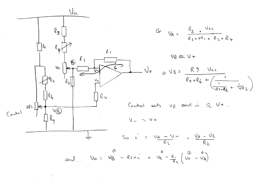

Ok got it sorted now once i realised i needed to equate Vb to V+ And hence V-. I could then get the current i in R1 and R2 and hence work out a value for Vo .
I made a spread sheet with all these values in and it actually works, Vo is just about 2.5 v when the values of VR1 and VR2 are the same.
Ive attached the analysis.

I reached the same expression using McMillman's Theorm.
Vo = (R1 + R2)Vb/R2 - R1 Va/R2
For R1 = 15k and R2 = 4.7k
Vo = 4.19 Vb - 3.19 Va
