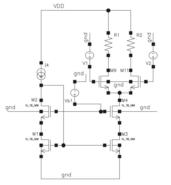

I am new and want to ask about differential amplifier.
Can you shed some light on the circuit below?
Why transistors M2 and M4 are added in the circuit?
differential-amplifier-jpg.73912
I learnt some basic about differential amplifier but when I see this circuit, it is confusing me.:confused:

It is cascode current source structure (M2,M1 is mirrored to M3,M4). It makes the current source have higher impedance.
Spoke too quickly, It is a mixer (multiplier). V1, V2 would be chopper for input signal Vb1.
hi, i am not sure what you meant. This is a differential amplifier i saw in an old thread in this forum.
