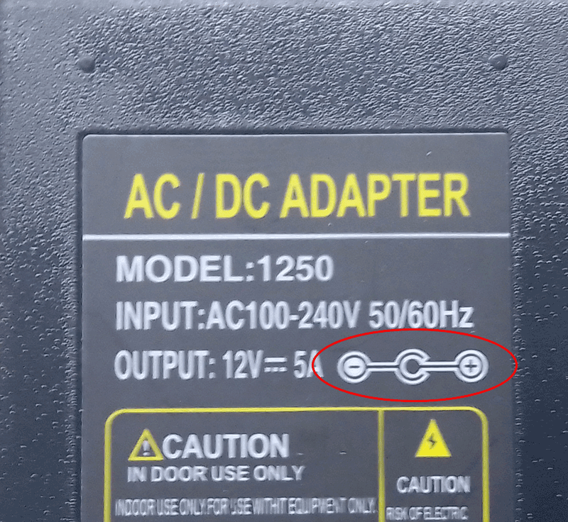

It's unlikely that 19.5V will damage something expecting 19V. It's more likely the wrong polarity.
Look for this symbol on your power adapters,
This indicates that the center pin is positive. If yours are different or the laptop is AC (very unlikely) then that is the problem.

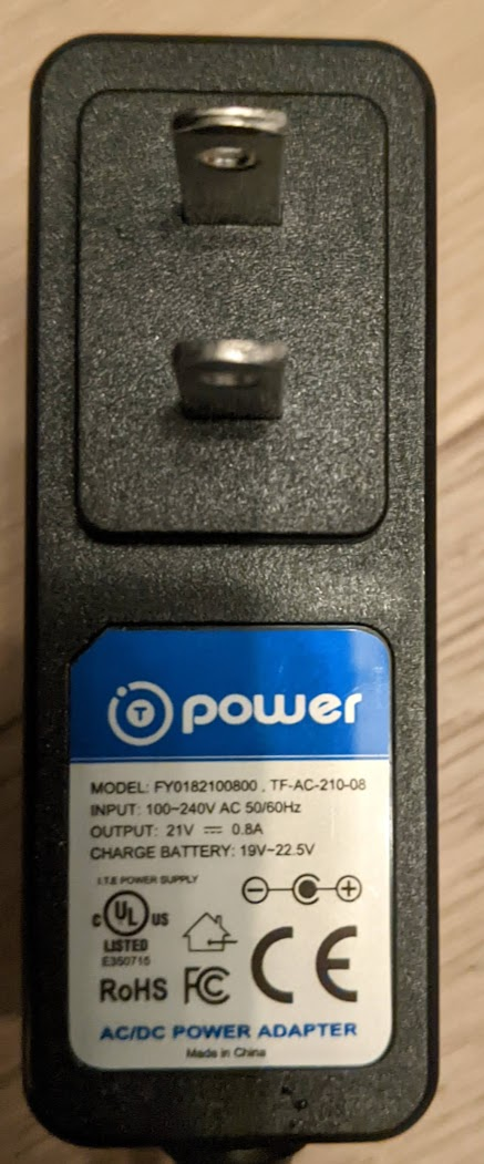

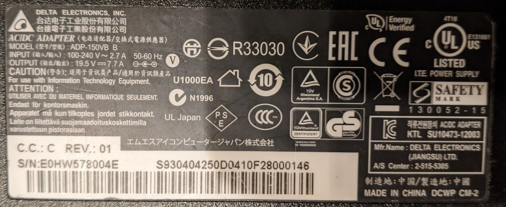

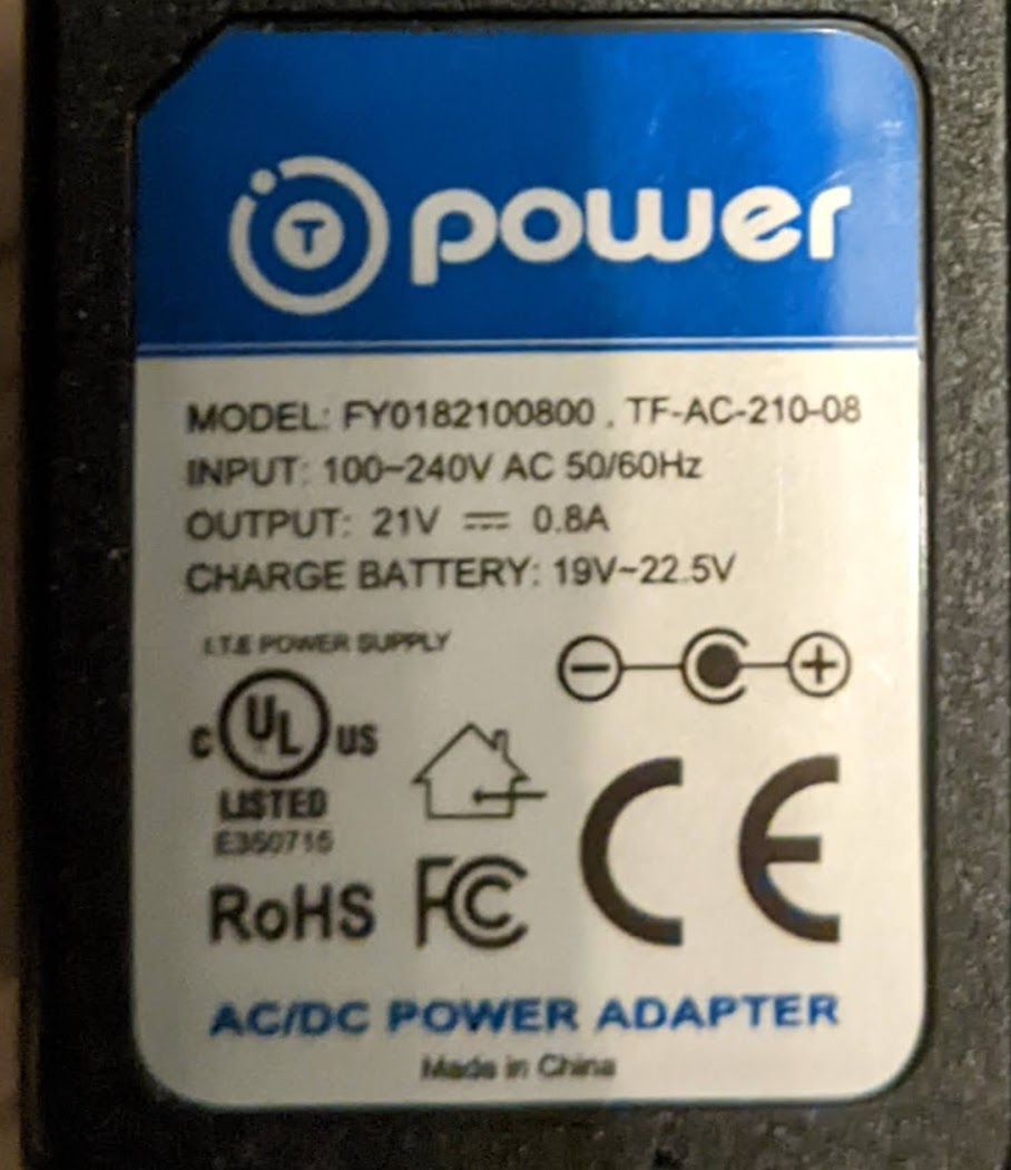

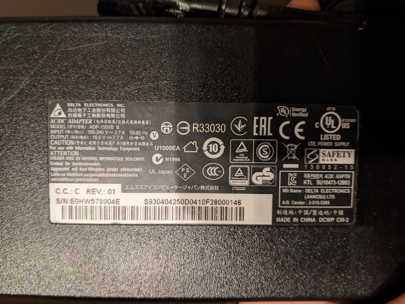

Thanks for the replies.
Here are the pics of the two adapters. I can open up the vacuum again tomorrow to take a pic of the charging circuitry.
It looks like the polarities are the same. The 19.5v / 7.7 A adapter is the laptop one.
The other AC adapter which is the one that worked perfectly for the vacuum is actually labeled 21V and 19V-22.5, not exactly sure why. It was a replacement AC adapter labeled specifically for this model vacuum, which theoretically should be 19V (e.g. similar to https://www.amazon.com/Holife-HM036-HLHM036BWUS-Power-Supply/dp/B078SMBGSG).
So if it's not the polarity, what else could it be? The main difference between the adapters is the much higher current - but would this ever matter? e.g. perhaps it won't supply 19.5v if the current is much lower - or perhaps the vacuum was trying to pull more current than it could handle?

Voltage is not a problem and the polarity is correct.
However the charger is only rated at 0.8A output, while the laptop power adapter is rated at several amps; it could be that a high current switch-on surge has damaged some part of the electronics?
Was the laptop charger already turned on when you plugged it in?

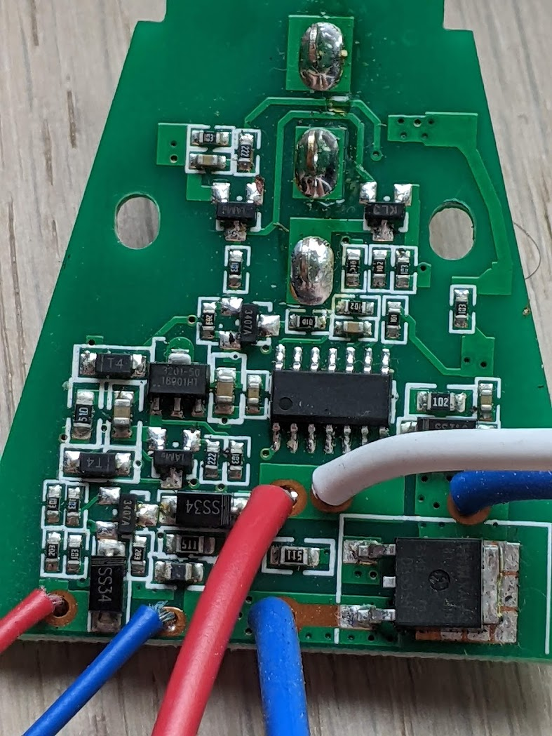

What make and model vac is it, and can you provide photos of its circuit board, both sides in good detail?
OK, here are the photos of the circuit board:
The bottom left two wires go to the charging port, the middle two wires go to the battery and the right white/blue wires go to the vacuum motor.

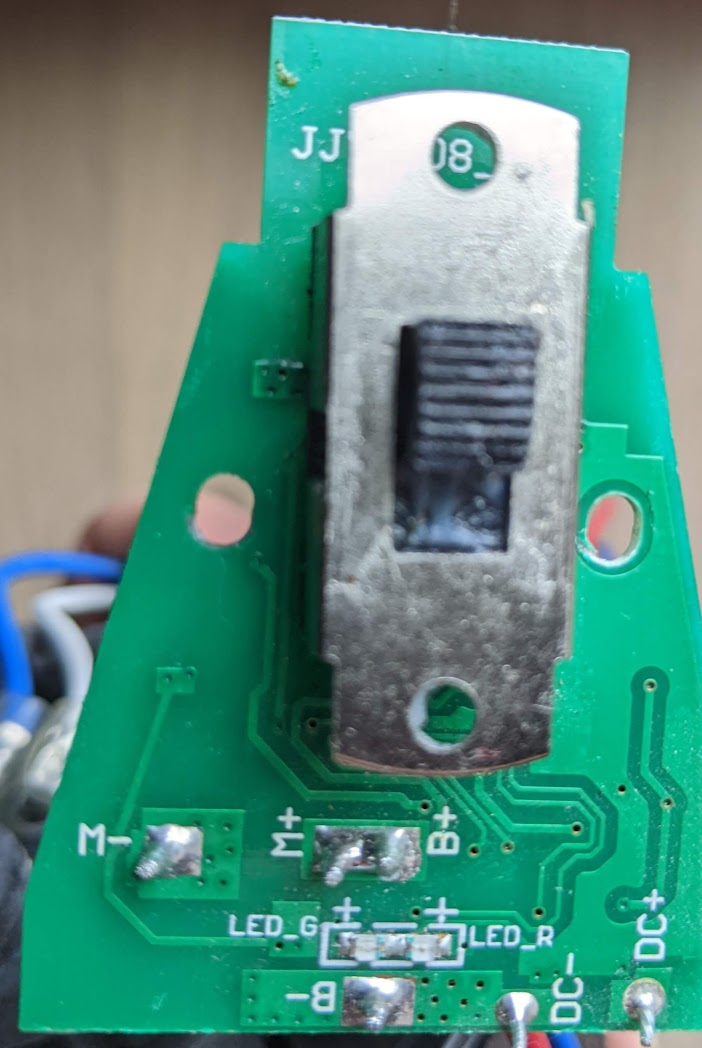

Here's the other side, which has the switch and LEDs:

The vacuum model is the HoLife HLHM036BWUS.

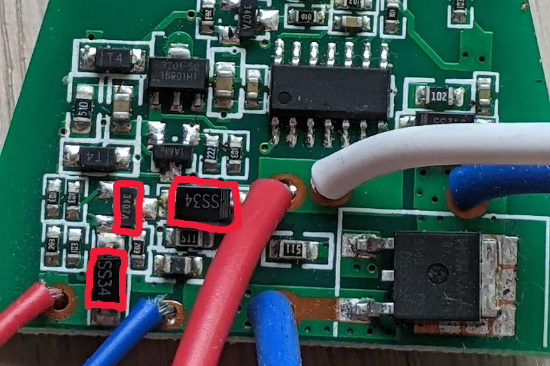

OK, it looks like the power circuit for charging is from charger positive through an input polarity protection diode (bottom), a surface mount power FET, then another diode to prevent the battery feeding back to the charge circuit.
The transistor appears to be one of these:
The diodes:
With the battery and charger connected, measure the voltage from battery negative to the top of the lower left diode, and the left end of the upper diode?

Just to be clear, you'd like me to take a multimeter and do two DC voltage measurements (with everything hooked up to the charger):
1. Connect to the battery's black wire and to the soldering above the bottom left SS34 part indicated in red.
2. Connect to the battery's black wire and to the soldering left of the top right SS34 part indicated in red.
