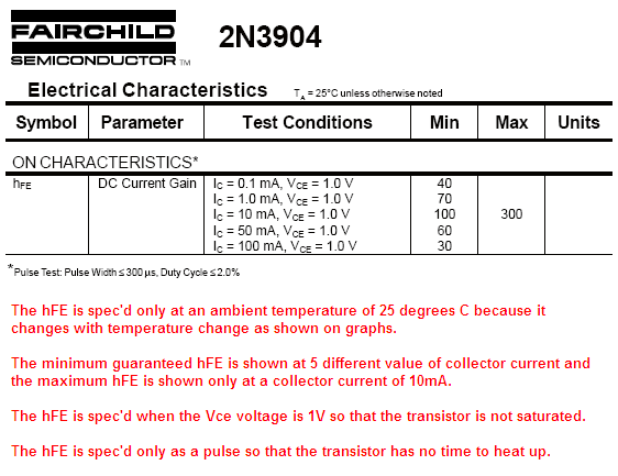

Here is the guaranteed gain on the Fairchild datasheet of the 2N3904 transistor.
Also to know what VCE and Collector Current(without measuring them in the circuit) are going to be, don't you need to know HFE and Base Current?
Your circuit design sets the Vce and collector current.
If you use negative feedback then the transistor can have any value of hFE and will work properly at many temperatures.

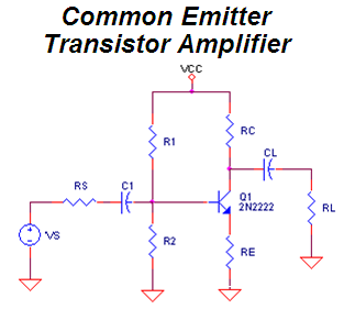

If you put a resistor in series with the emitter, you would then have a emitter follower correct? And then you would have no gain at all?
An emitter-follower does not have a collector resistor and its output is from its emitter. Its voltage gain is 1.
A common-emitter transistor circuit has a collector resistor and its output is from its collector.
The voltage gain of a common-emitter transistor is RC/RE. If RC is 10k and Re is 1k then the voltage gain is 10.
