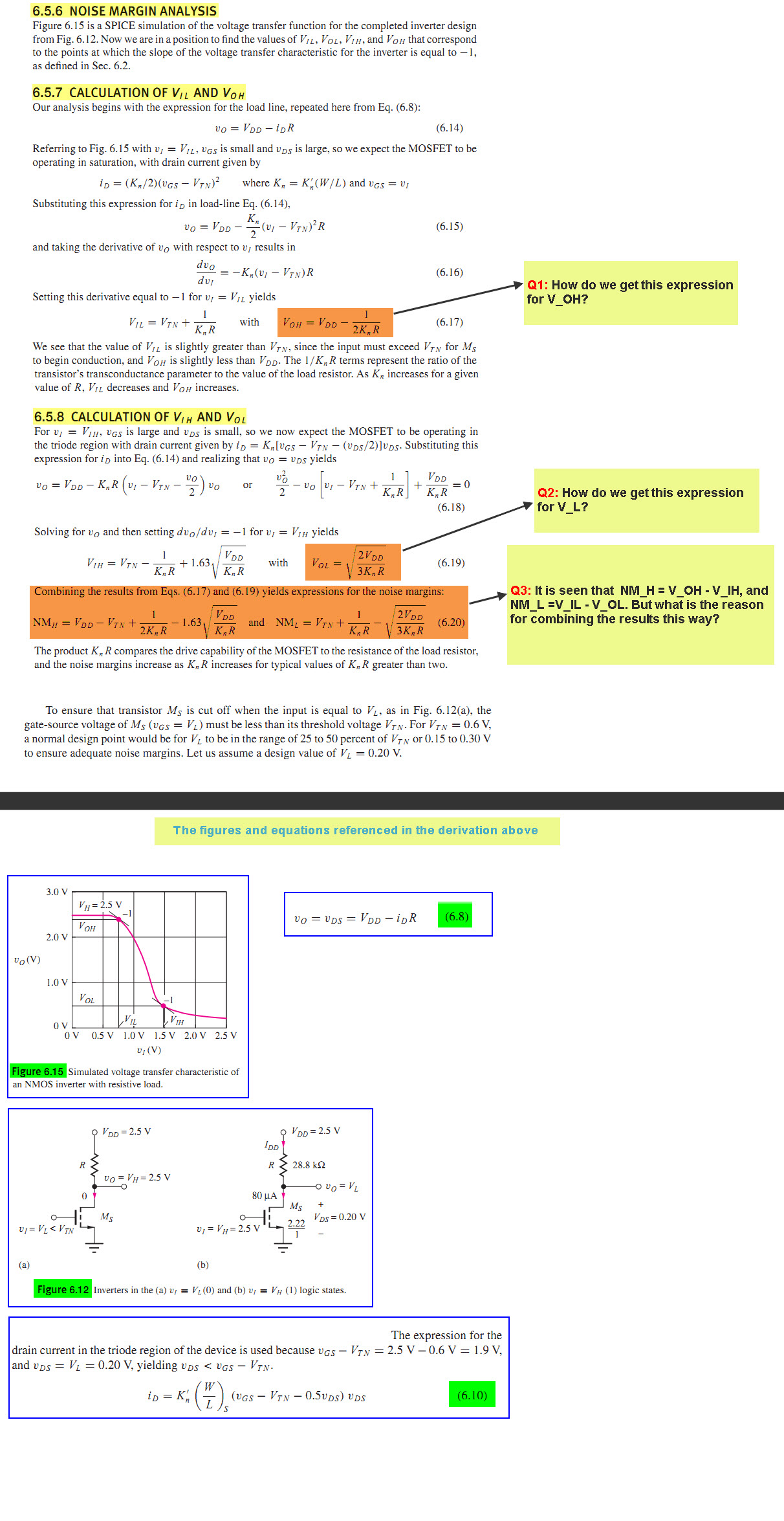

Could you please help me with these queries? These relate to noise margins of NMOS inverter. Thank you.

Since nobody answered yet i'll start by helping with Q1. See attachment.
Since they solved for V_IL (6.17 left), we have one thing solved for already. So take that and substitute that into equation 6.15 for v_I and that
gives us V_OH because V_IL corresponds to V_OH on the input/output curve.
So in other words once you have the input voltage that corresponds to some output voltage you can go back and substitute into the equation for 'vo' to get the corresponding output voltage.
BTW, the exact value for that constant "1.63" is really:
2*sqrt(2)/sqrt(3)
You'll need that to get the same exact result they got for 6.19 right (Q2).

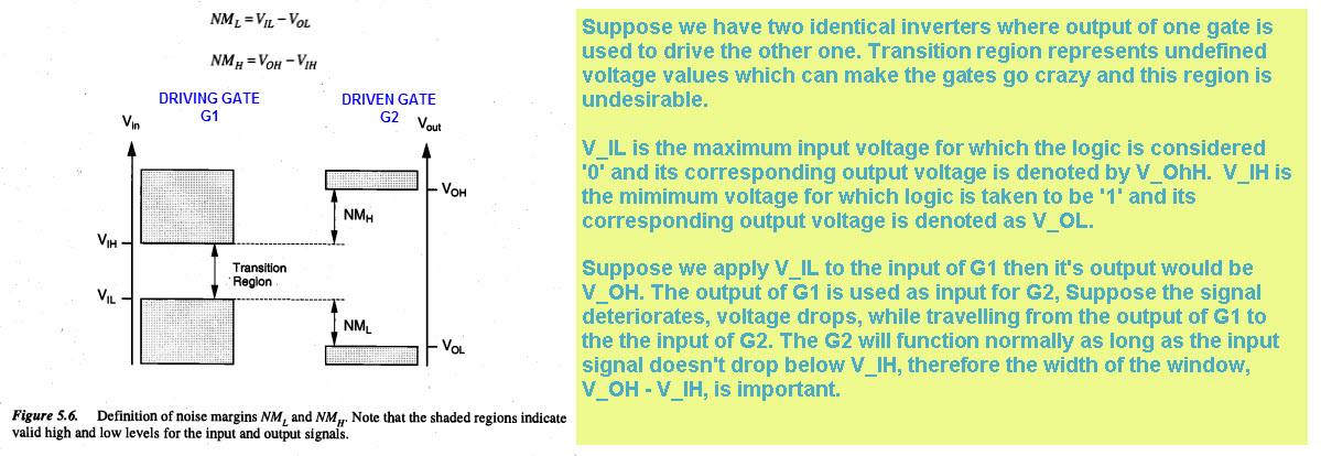

I have included my own little understandING of the noise margin which might be helpful to someone like me.

Basically if you design a Schmitt Trigger you note that you have to have high enough gain to get the output to SHOOT up (or down) to the next logic level. With the gain too low, the dang output follows the input signal. The problem is that at some point the gain is too low in the transition region and that means the output follows the input for a time and that is considered a no no for logic because the output is supposed to be well defined even if the input isnt. This is one of the reasons why we look for unity slope to help define noise margin. Contrast this with noise immunity for more enlightenment.

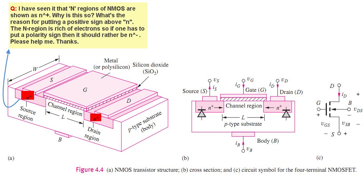

For example, n+ denotes an n-type semiconductor with a high, often degenerate, doping concentration. Similarly, p- would indicate a very lightly doped p-type material.
When many more dopant atoms are added, on the order of one per ten thousand atoms, the doping is referred to as heavy or high. This is often shown as n+ for n-type doping or p+ for p-type doping.
