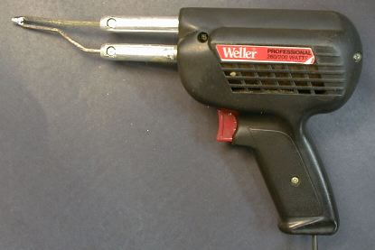

Let's get this straight, we're talking about a heat gun, not some kind of exotic eddy soldering device?
If so I'm very surprised that it produces enough of a field to degauss a monitor or vice. I'll have a play with my heat gun and some iron filings. This should also work with a hair dryer too.
Just like that. A hair dryer would probably not work the coils are designed completely differently, the coils are much bigger and air wound the stray field they put out is probably very week even though the power is higher, also they way air heating coils are wound I don't think the field is going in the right direction. as tcm suggested it's really easy to determine the relative strength of an AC magnetic field, just take a strong permanent magnet and put it near the spot you're interested in. You'll feel a vibration from the induced forces in the magnet, the stronger the vibration the stronger the field.
I noticed this effect myself at work a long time ago and was surprised at how strong it was. I got one of the magnets we use to hold paperwork to a board near the forklight battery charger wire and thought for a split second I was about to get electrocuted. Although a bit higher than a typical soldering gun there's 20-30 amps of current going through the charger when it's on and you can feel the buzz in the magnet from almost 8 inches away. Since heating coils are typically wound and a soldering gun is designed to be compact the smaller field is magnified.
As a side note any even half assed decent CRT monitor made in the last 10 years should have a built in degaussing coil. I've yanked a few out of monitors I've disassembled, not sure if I kept any of them but they might run on straight wall AC power. The coils are pretty large would make a nice little project for a shop de-magnetizer, just keep in mind they're not meant for constant use, they generally get 5-10 second pulse of current when the monitor turns on, and sometimes you can activate a degauss feature in the settings. Just be careful, outside of the monitor and close to your person if you carry your wallet with you it will eat credit cards for lunch.
So there's an internal transformer and the tip is heated by a very high current?
I see what you mean, I was thinking of a heat gun, I've got no doubt a soldering gun will work.
