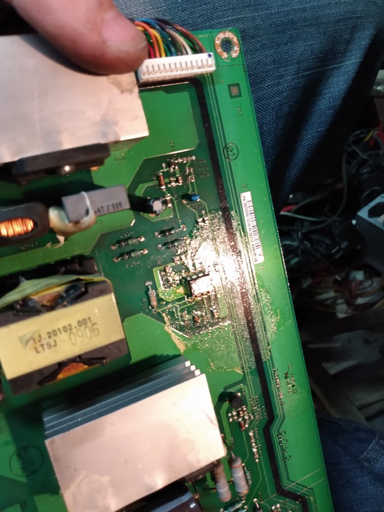

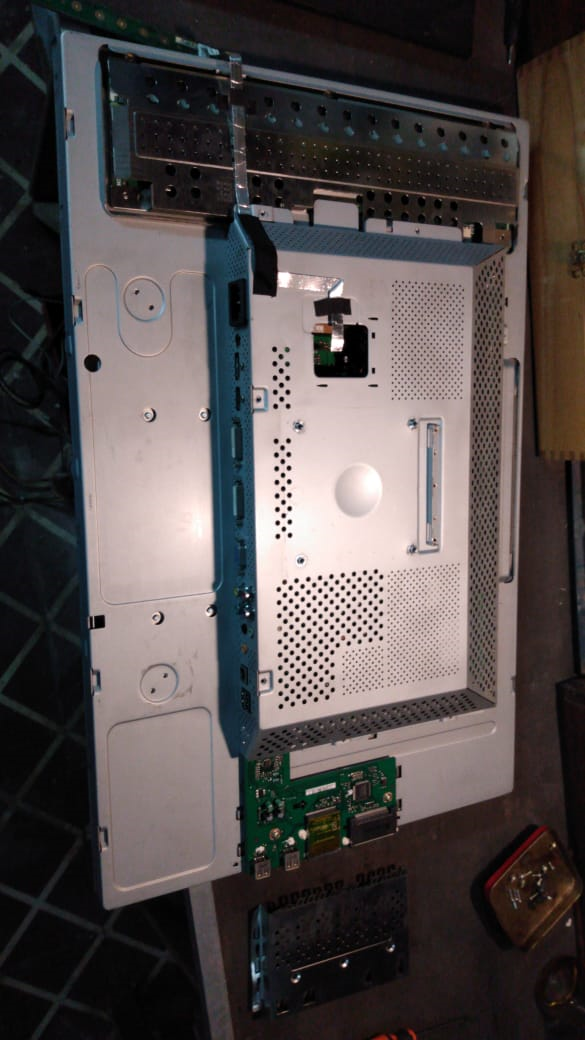

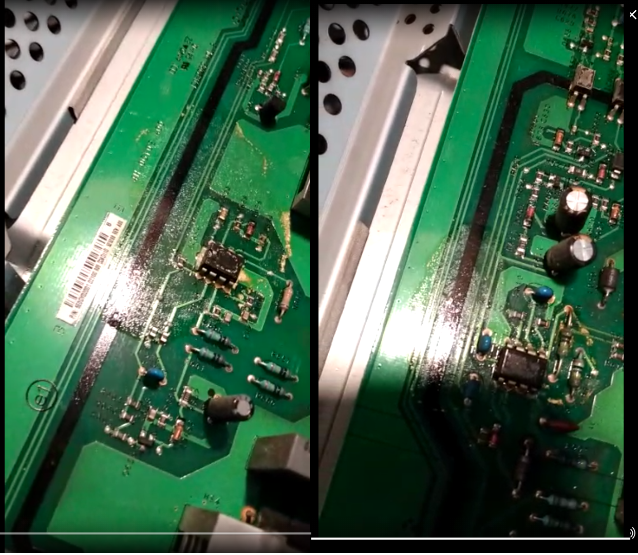

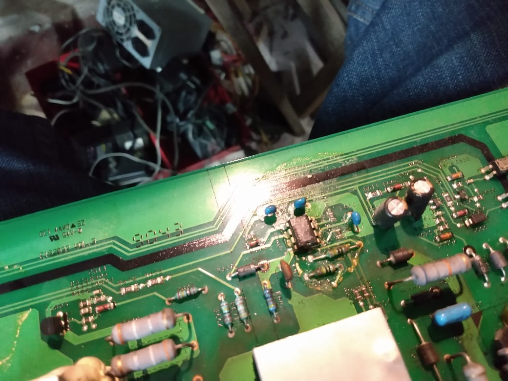

A friend had a Dell 2407WFPb laying on the floor of his apartment and i volunteered to repair it.
The monitor works fine but it doesn't even turn on other times.

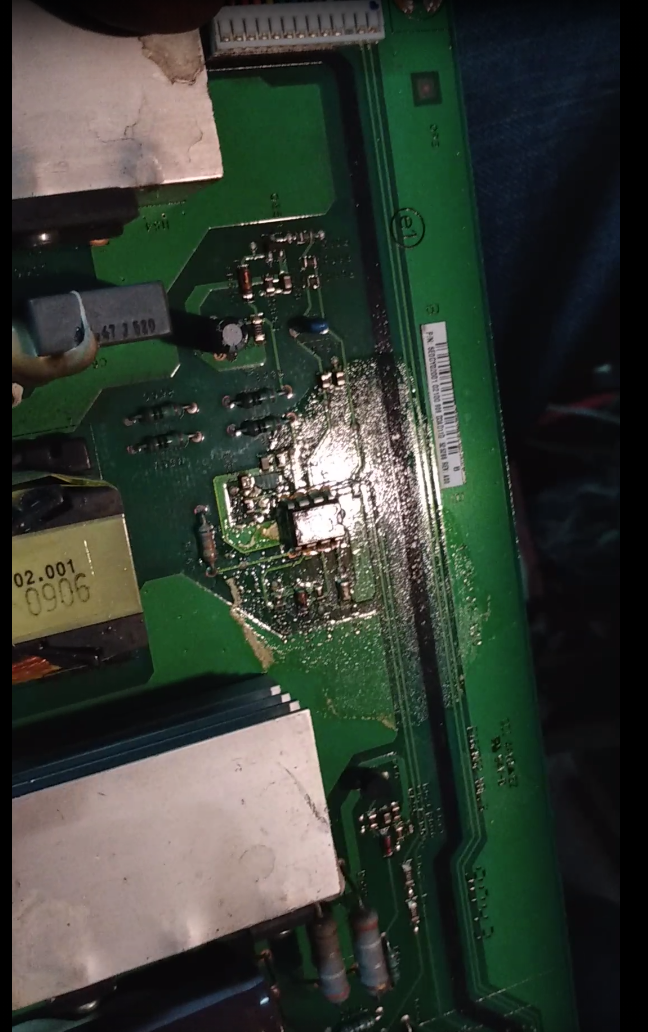

Opened it and this was the discovery, a black transistor without markings, that looks burnt.

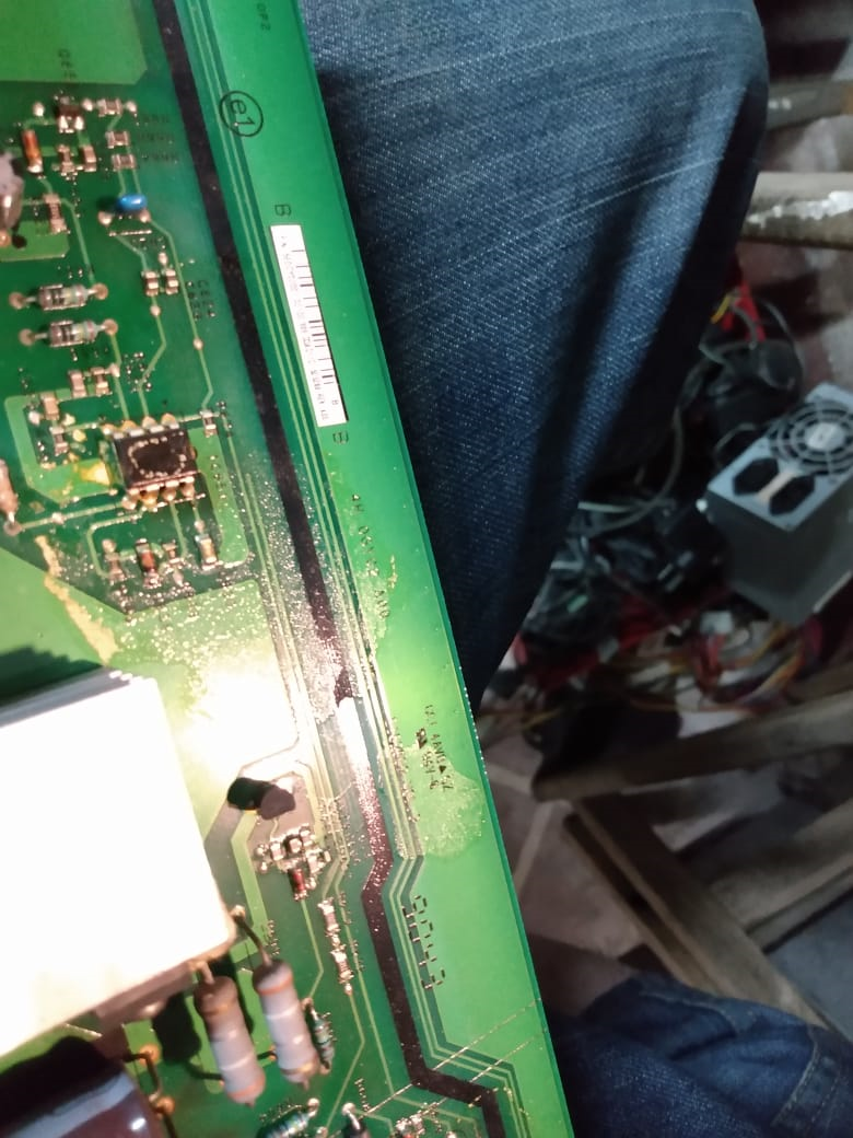

A leak-like stain in the PCB board around every transistor.
My first idea was to cook it like a GPU revival method but since this has PVC cables attached didn't took that route yet.
I recently added an "APC power bank and stabilizer" to my rig, because I had crash problems with mi 1080ti, after the purchase realized that I have not 220 as the electric company said, I have 189/209...
The APC was the solution for my PC, now it runs smooth.
Maybe the APC will "fix" the monitor problem as my friend does not have such a stabilizer, sure that he has less than what the monitors needs to run, but looking at those pictures I want to ask your opinion before trying to put it back together.
Thanks.

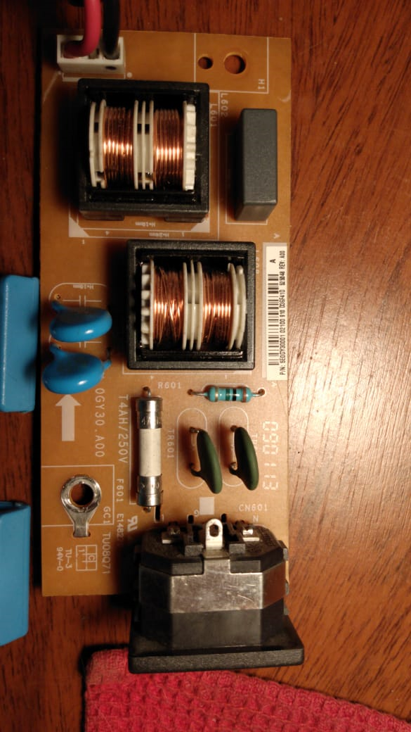

My first thought would be failing electrolytic caps in the power supply section.
The marks on the PCB appear to be small areas of varnish type material, something like a selective conformal coating over something they consider sensitive rather than dipping the whole board and protecting areas that must stay clear.

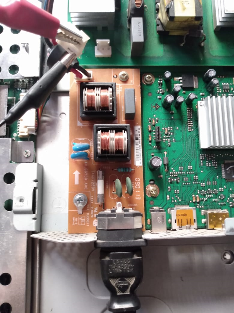

Right now this is what I have....
1. A decent and stable power input. 230v.
2. A ¿Working? power supply giving around 250 in direct, and 185 in alternate.
3. A resistor that does not BEEP when Continuity test. (the light blue big one)
4. A burnt smell in the PSU area when pugged up.
¿Next step? ¿Change the resistance?
The big capacitor from the original post looks good, it charges and discharges when unplugged, and also has not continuity beep.
One thing that I realized is that the first radiator-mosfet hast not a thermal pad and only one of the "yellow wrapped boxy things" from the original post has a tiny thermal pad, plus the shield has a black stain like there is hot air flowing through it.
