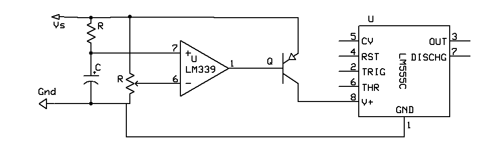

Wouldn't it be easier just to use a cap, resistor, and comparator? Once the cap is charged to a voltage set to the by the potentiometer, you could start up the power to the 555. I have attached a psuedoschematic. It my not be fully correct, for my fluency of electronics is relatively low at the moment. Please forgive me :)
