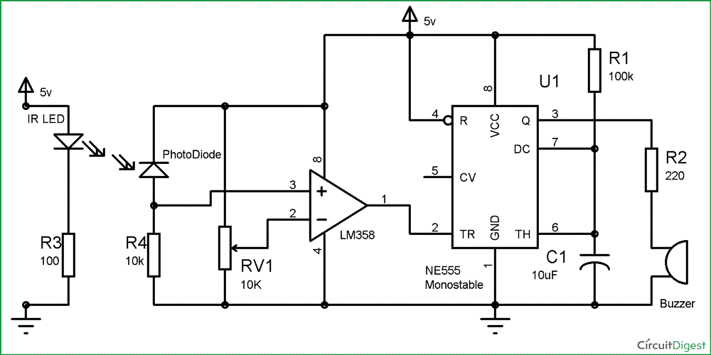

    Hai.
    I just want some help in this school project circuit.im using 555ic to get delay off effect of lights.
    But the problem comes when trigger is longer than delay time, then lights going instantly off without any delay. So can u please help me in building the right circuit. Im just using monostable mode to get the result,but in vain

    Show the circuit of what you have and how it's being triggered.

    This is the circuit. Triggered with IR circuit when there is a blockage between IR led and photo diode. Replaced the load with a led,cause i want to use it in the street lights 06-20-42-IR-security-alarm-circuit.gif theme.

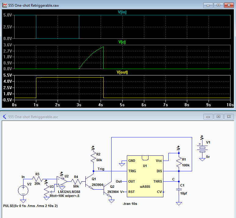

    If I understand correctly you want the one-shot time to start at the beginning of the trigger and time out after the delay time after the trigger stops.
    Below is the LTspice simulation of a modification to the circuit that does that.
    I added two transistors, one to trigger the 555, and the other to keep the voltage on the timing cap C1 (Vc) at zero volts until the end of the trigger, at which point the 555 times out.
    You can use other NPN transistors but they should be rated for a least 200mA maximum to minimize their saturation voltage.
    Note that the input polarity of the LM358 is reversed, since the transistors add a phase reversal.
    As can be seen, the pulse OUT is extended a little over 1 second after the end of the trigger as determined by the R1C1 values shown.

    You just need to add the two 50k resistors (R2, R4 in my schematic) and the two transistors to the circuit you posted, and reverse the inputs to the op amp.
    The pot and input resistor R3 in my circuit are part of the circuit you already have.
    V2 is just to simulate the switching of the photodiode.
    Note that LJ's suggested modifications won't give you the extended delay pulse you want after the end of a long trigger pulse.

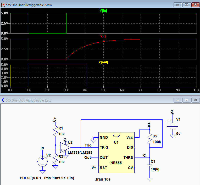

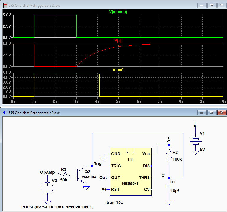

    Edit: Below is a variation on the circuit I posted that only requires one transistor instead of two.
    Note that the connection to DIS (pin 7) must also be removed.
    It could actually be reduced to no transistors if the LM358 opamp is replace with an LM339/LM393 comparator as shown in the second attachment, since the LM339/LM393 has an open collector output.

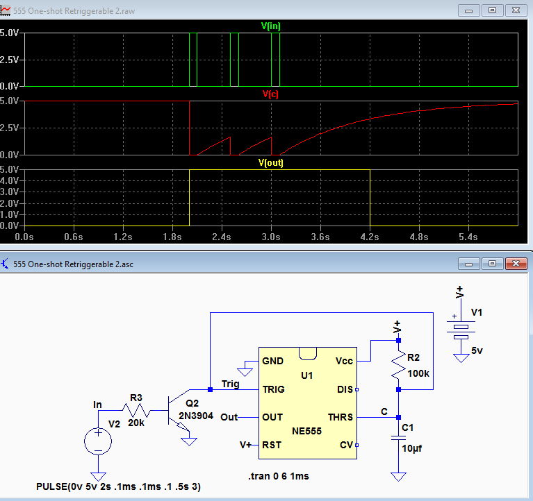

    Sir. Another question .
    Im getting the output pulse right now.
    I want to improve it more.
    Like say 3 short input pulses given in the delay time which are shorter than the delay. Can the delay be reset to the last input pulse? Just want to experiment it more.

    Yes.
    All the circuits I posted will start the delay after the trailing edge of the last pulse as long as the time between pulses is shorter than the one-shot time, as shown below.

    What you needed to look for is "retriggerable one-shot".

    Thanks sir. I just tried with one transistor and it's working well. .
