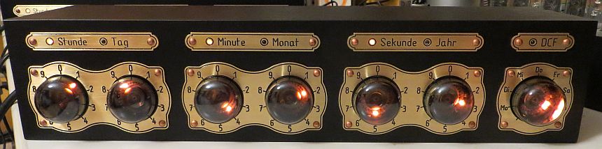

Hello,
I just built two Dekatron clocks. One is with 6 Dekatrons and one with 7 Dekatrons.
I operate it with a 450V supply. No other voltages needed. (For sure the 5V for a microcontroller)
Complete building phase is shown on my site:
http://www.a-reinert.de/Dekatron_A101/dekatron_a101.html
here a video showing both:
Best Regards,
Andrew

Your dekatron driver is very similar to mine, I biased the guide electrodes at 60v as I found with an older tube the glow wanted to rest on the anode ring as well as the number electrode.

Hello, please share some pictures.
I biased all kathodes and the guide kathodes at 80V and tested this circuit with 95 Dekatrons. All are working perfectly. But as you can see in my videos and on my pictures: At some Dekatrons the anode ring stays dark (clock with 6 dekatrons) and some have a light glow on the anode ring (clock with 7 dekatrons). But that doesn´t have an effect to the function. I´m not sure what I like more.

Yes, that´s the same in Germany. We have the DCF77 time signal. So there is no need for a rtc or a 24/7 powersupply.
