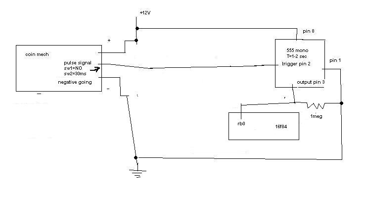

hello guys i'm getting multiple readings on my pic, maybe this is because i'm using common ground throughout my breadboard. my question is if i increased the value of the decoupler (1uf) to say 47 uf, will this reduce the noise (i'm only assuming this was the correct term to use) and fix the multiple reading that i'm getting? i already placed 1-meg pull up resistor in my RB0.

A 1 meg pullup is useless. Post a schematic and a better description of your problem.
eric gibbs taught me the resistor divider approach but was not able to make it to work so i went on using the 555. the 16f84 and the 555 have 1 uf decoupler. thank you very much in advance.

If the supply to the coin mechanism is +12V and 0V is common/ground and all the coin switch does is switch the +12V on/off, how can the coin pulse be a negative voltage..:confused:
i have no idea but heres whats going on eric, when i attached the wire that sends out the pulse from the coin mech to the 555 trigger, the 555 will give me an output and the PIC would even detect. i have no idea and i can't explain why and how it worked. its just i'm getting multiple reading after the pic read the rising edge.
if its a mechanical coin switch you will get multiple signals due to contact bounce.
You need to debounce the switch signal, use a cap/resistor filter on the signal from the switch.

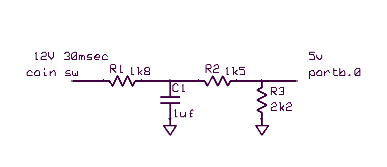

okay eric i found a sample
let me guess "X" there goes to my RBO?
i found other diagrams but they are a bit complicated and uses 555 and schmitt triggers (i have no idea what schimitt is [it compares voltage according to my speed read]).
you think this diagram will do eric?

no, it will make it worse.:)
I will do a sketch..
EDIT:
Something like this. Increase the C1 value as required.

Your 1 meg is not actually pulling up anything since it is tied to ground, this would be a very, very, very weak pulldown.
A pull up is a resistor that tends to pull a line towards a positive level as in +v. A pull down attempts to pull a line towards ground level. The choice of a pull up or pull down is often selected based on many factors. Some are, open collector outputs, or if line may go tri-state, or the driver needs help sourcing or sinking current, these are but a few reasons.
