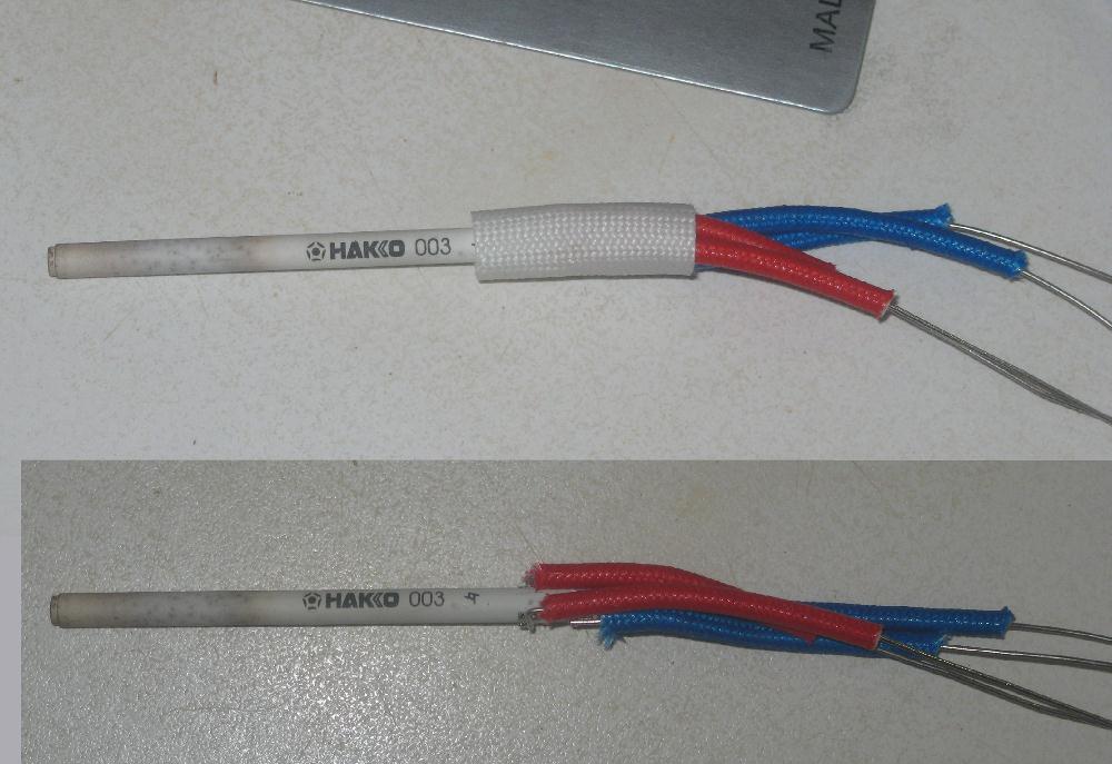

What started this was i got a soldering station and soldered with it once with the iron, then the next time i went to use it it started going crazy because it would indicate "5-E" or "S-E" on the seven segment display, which is an error code for "Bad soldering iron". That made me take the iron apart to see what the problem was, and that meant i had to measure the resistances. I found the heater element to only measure 16 Ohms and the 'sensor' was open circuit. I connected the element to a DC power supply and it did heat up, so the problem was the sensor blew open. But since the current was too low (like 1.5 amps) i knew it could not be a 50 watt element, so that got be looking into this matter (1.5^2*16=36 watts).
To make matters worse, yesterday i received a new heating element that is supposed to be "50 watt 24 volt" also, but when i measure that heater resistance i read about 4 ohms !. That's nowhere near the right resistance, but i havent checked it 'hot' yet. I'll have to check that better today some time.
The waveform out to the iron (with 16 ohm heater element) looks severely flat topped, which indicates that the transformer could be saturating near the peaks, a typical low end design or a design in a product meant to be used for short time periods only on an intermittent basis. More testing will be required on this too.
I cant wait to see what it looks like inside, like the control circuit and transformer size.
SHORT UPDATE LATER:
Ok, i measured the new 4 ohm element when it gets hot. At 4 volts it draws 1 amp, but then the current starts to decrease significantly indicating that the element resistance is rising. Running it up to 20vdc it draws only 2 amps, which of course indicates that the resistance is now around 10 ohms and it is probably still increasing a little. I suspect that running it up to 24vdc would mean the resistance would increase to 12 ohms which is just about right for a 50 watt element. So this is truly a 50 watt element.
The name brand is "Hakco" and the package is stamped "50 w, 24v".
The element is just stamped "Hakco 003".
So this element changes resistance a lot when heated, the other element does not do this or at least not very much.
Unfortunately i am not sure if this element can work with my rework station. The iron that comes with that station is 16 ohms cold, and while this new element is heating up it will draw much more current than usual. I dont want to take a chance and blow the station, so i'll have to see how they make this station first (parts used, ratings of the parts, etc.).

Speaking of imitations, and attention to detail:
Do they really say "Hakco"? There is a well-regarded brand of soldering equipment called "Hakko". If yours is spelled "Hakco" I would assume it's a knock-off and should probably go in the garbage.
Yes good point. But in this case it was my fault because when the write the intended correct name "Hakko" they make that second 'k' very close to the first one, so it looks like a "C" if you dont look closely. I didnt look closely enough so i wrote "Hakco" when it is really "Hakko".
I saw some pictures on the web and it looks the same. It also appears to be of decent quality.
I'll get the pic off my camera and post here hopefully in a few minutes.
Thanks for bringing this up because sometimes a 'slightly' different name is used by the fakers to make it look like the real thing as you noted. My intent with this thread is to bring out the good and the bad with soldering irons and stations.
This element is also interesting because the cold resistance is 4 ohms while the hot resistance would be around 12 ohms. That means it heats up faster than one that was just 12 ohms all the time, given the right drive circuit that is. It will not work in my rework station unfortunately because the initial resistance is too low, but mostly because it uses a PTC thermistor (Positive Temperature Coefficient Thermistor) while mine uses a K type thermocouple. That seems to separate the two main types of elements in the iron itself, and the stations from what they can deal with. Some stations require one and some the other.
Here are the pictures. You will see the element slightly blackened due to testing as it gets pretty hot.

With reference to fake Hakko irons, the real ones afaict have a good quality crimp on the cable clamp in the handle, the fakes just have the metal wrapped round. Of course I could be wrong...
Oh ok well that's interesting too. This was just the element as that's all i ordered. Any information that adds to the pile is good i think so we all learn more about this.
