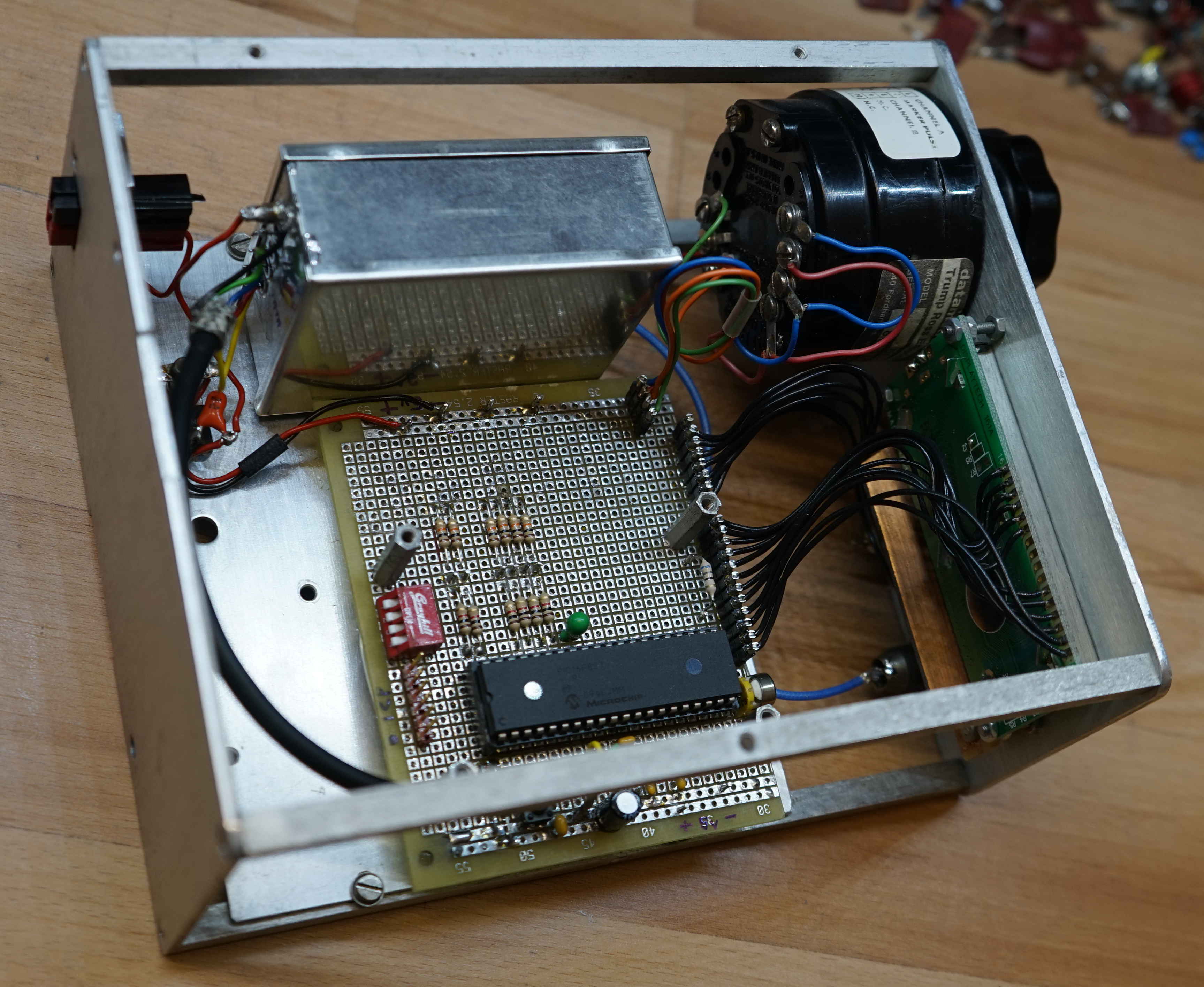

So here it is in all its glory:

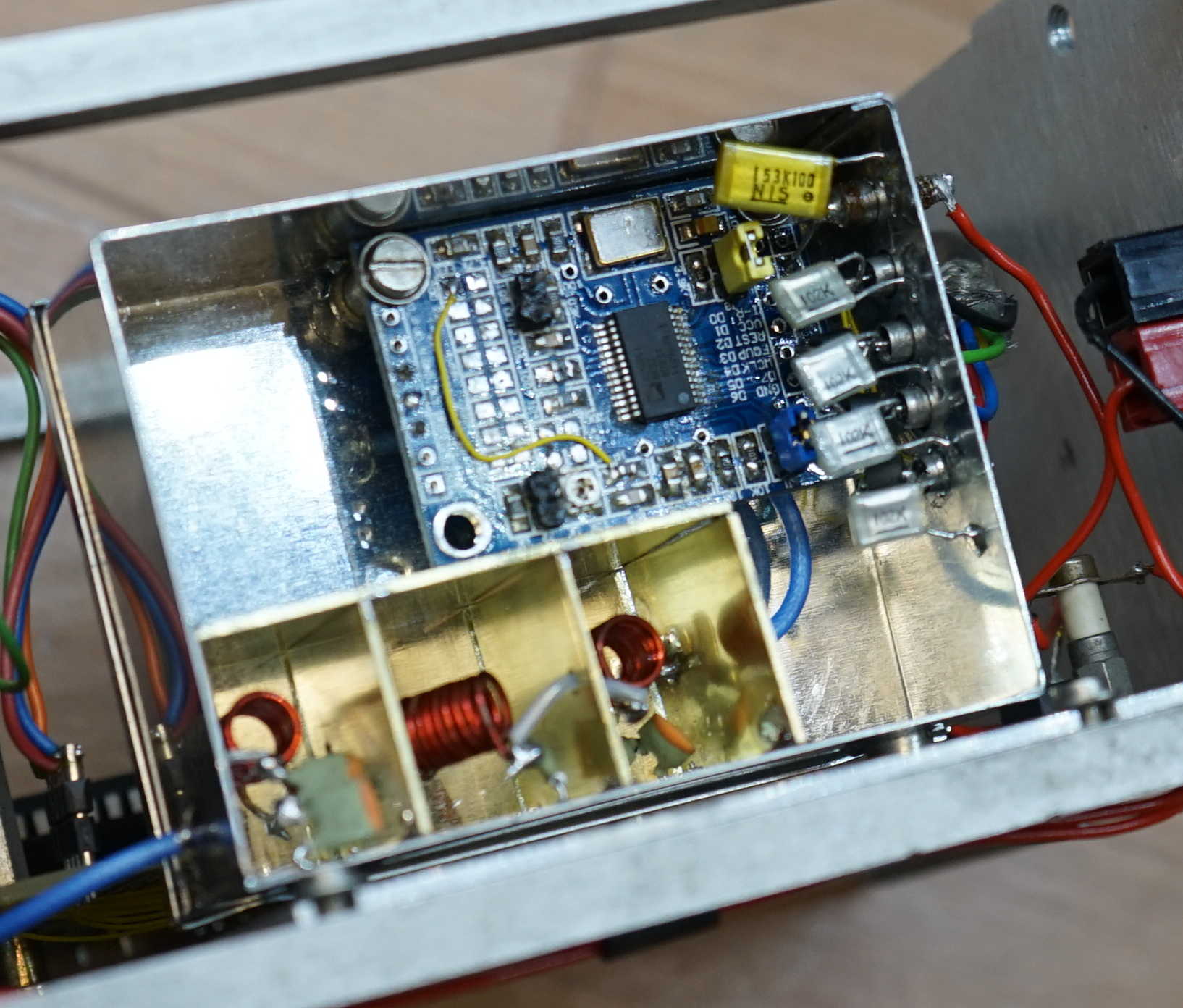

And inside the tinplate box:

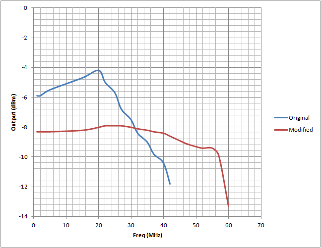

I modified the AD9851 module by removing the lowpass filter which was fitted on the board and added my own LPF which can be seen at the lower left of the box.
I also changed the output load resistors to give a 50Ohms output, rather than the 200Ohm output which is configured as standard on these modules.
I was getting some rather strange variations in output from the generator as it was tuned across the range of output frequencies, and the various harmonics and aliases were not as well suppressed as they could have been with the original filter as fitted to the module.
