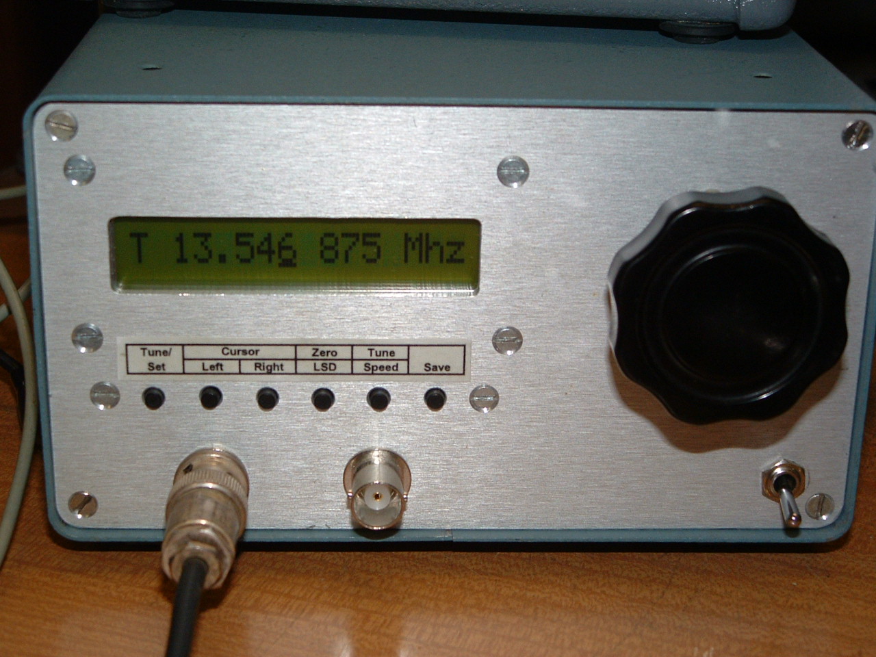

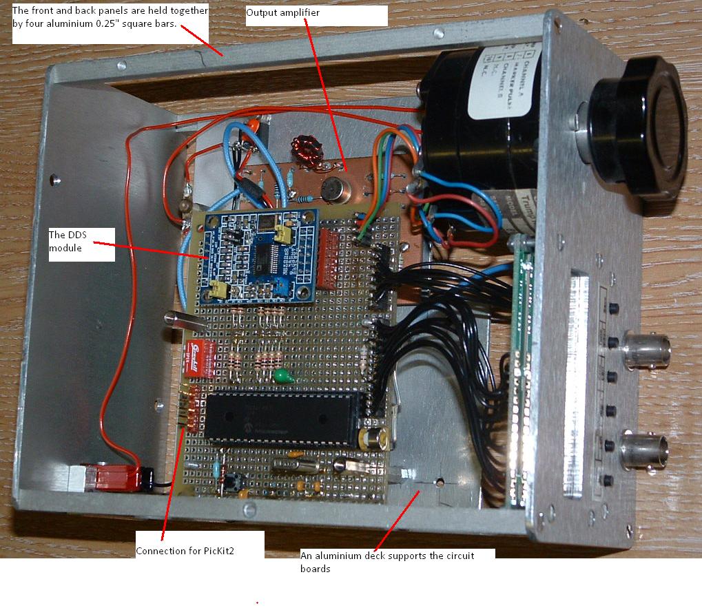

Here it is in a box. The outside is quite nice, but inside is a bit of an ugly evolving work in progress.

The only idea which I used from that article was the way of mounting the AD9850 into a 28 pin DIL header.
In my original incarnation of this signal generator, I used that AD9850 on a DIL header, a PIC 16F84 and two display modules with 7 segment LEDs which gave me an 8 digit frequency display.
The thing worked reasonably well, but setting the frequency could be a bit tiresome with just two tuning rates.
Then one day I had a flash of inspiration which gave me a better way to set the frequency.
I had originally been driving a binary count from the quad encoder and then calculating the display frequency and the DDS tuning words from that.
The new idea was to use the quad encoder to drive decade counters for the display and calculate the DDS tuning words from the display.
That way I could tune any individual display decade, or let the count ripple through the decades for continuous tuning.
I should point out that these decade counters are PIC registers, not 7490s or similar!
I also moved from the LED display to the LCD and added some buttons to give various control facilities.
I also upgraded the PIC to a 16F887 which has a lot more I/O ports and registers than the old 16F84. Saves a lot of messing about multiplexing I/O.

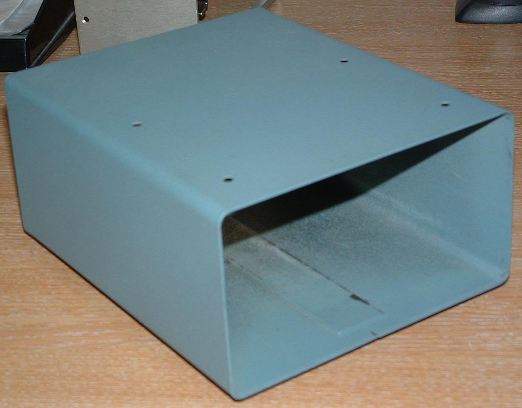

The case is just a simple steel carcase which I bought some years ago for £1 if I remember correctly.

The idea behind having two output connectors is that one is for high frequencies (above 1MHz) and the other is for low frequencies (0 to 1MHz).
So far the low frequency output is not connected, I will get around to it one day.

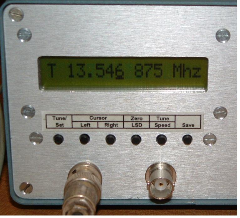

The buttons:
Save - saves the displayed frequency and mode to EEPROM. The generator will then start with these conditions after a power on/off.
Tune Speed - press the buttons to cycle through three tuning rates.
Zero LSD - sets the digits to the right of the cursor to zero. Pressing the button in the picture would set the display to 13.546000 Mhz.
Cursor Left/Right - moves the cursor left or right. Turning the tune control will then change the frequency at the cursor position, the digits to the right of the cursor will bot be affected.
Tune/Set - when set to Tune (shows T at the left side of the display) the frequency will tune up/down through the whole range of the generator. The tuning steps will be determined by the cursor position. In the picture the generator will tune in 1kHz steps.
When set to Set (shows S at the left side of the display) tuning will be restricted to the digit at the cursor position. In the picture the generator will tune from 13.560875 to 13.569875Mhz. The purpose of this is to be able to just set individual digits to quickly set a wanted frequency without having to tune through the whole range of the generator.
Mmm.... I think I have just gone half way to writing an operation manual for it!
The label for the buttons was made using MS Excel and stuck to the front panel using clear nail varnish.
Shame about the lines through the Zero LSD and Tune Speed boxes, I did not notice that error until much later.
