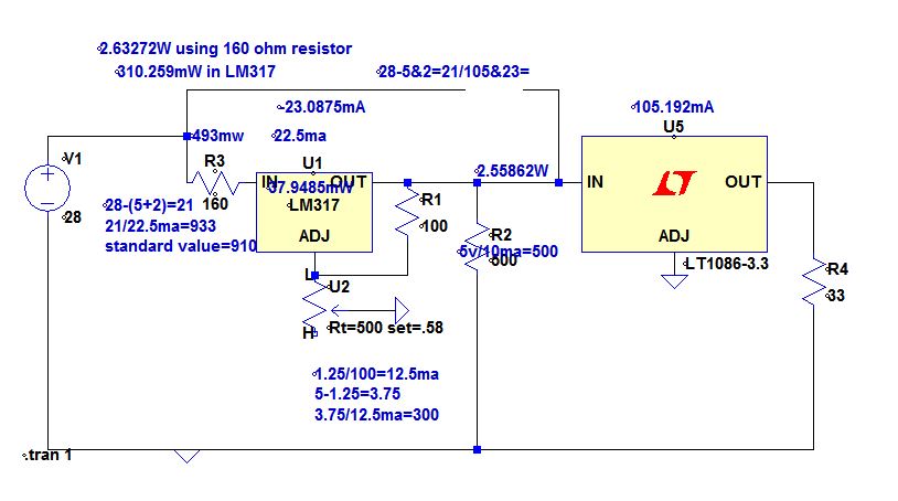

You missed a point. Even though the total wasted power is the same, the way you propose configuring the two linear regulators requires that U2 have the same max unregulated input voltage spec as U1. By cascading the two regulators, it reduces the demand on U2, making many more chips available... Besides, the TS has already decided that U1 should be a switcher (because that is where the bulk of the dissipation takes place) , and U2 can be a linear (with a 5V input) because the dissipation there is only (5-3.3)*0.1 = 170mW.
alternatively, OOPS this was supposed to post last night,
I would use a switcher also because of the wasted 2.5 watts and I have not had any problems with them, that I know of, but wanted to see what could be done with linear regulators
  • 5 &3 volt supply#2.asc

I have a 28vDC supply and want a 5vDC 10mA + 3.3vDC 100mA deriving from it. I have used tried a few LDO regulators just wired up by hand to test the outputs and I have tried two configurations.
First configuration was with the 28vDC feeding both regulators, both regulators can handle 30v in, but for some reason the 3.3v regulator popped and and blew up the HC-O5 I had attached to it, this happened twice after approx 30-40 seconds!! I did it a second time because I thought it might have been a faulty regulator. When I did not have the HC-05 connected the output showed 3.3v without issue.
The second configuration has the 5v regulator output feeding the 3.3v regulator input, but in this configuration the 5v regulator got hot (didn't blow just got hot to the touch) .
So my questions if what is the best way to get 5vDC 10mA + 3.3vDC 100mA from 28vDC supply. both the 5v and 3.3v supply IC's

Easy way: use a couple on LM317 (TO-220 package) devices set up for 3.3V and 5V. The 3.3V reg needs a small heatsink like solder down to 1 square inch of copper PCB.
