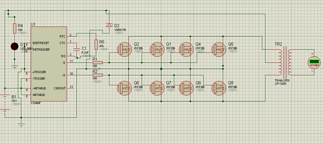

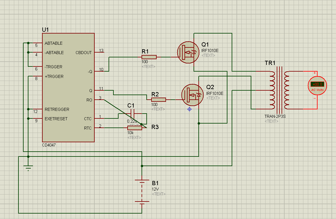

hello to every one i want simulate inverter but i failed can any one help me
i have made inverter circuit in proteus,have used cd4047 to generate 50hz square wave, i have used irfz44 mosfet. what are the transformer rating for proteus simulation, using a 12V battery, output should be 220 watts, i am confused how to set the step up transformer for proteus.
and if a want to make an inverter of 500 watts, which mosfet shoul i use and what are transformer rating.
i had also posted the inverter schematics.
guide me, your suggestions are valuable for me.

What electrical device do you have that works properly from the squarewave from your inverter and with no voltage regulation?
I think your last inverter has a 23Hz output.
i want to make inverter
it is our project to simulate it in proteus and dont have any device to use i just show the out put
The simulator program might not know the spec's of a CD4047 IC and the spec's of the transformer you will make or buy. Ask your teacher how to find the spec's and feed them to your Sim program.
Why bother simulating the circuit when you have no detailed spec models of the transformer for the sim program? Did you find the detailed spec model of the CD4047 for the Sim program?
