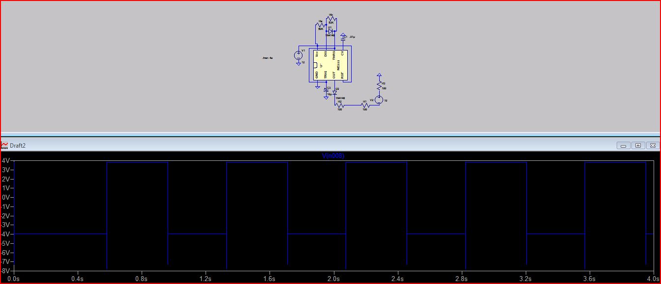

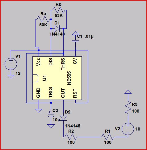

Ok, so going off of a DC signal project everybody's familiar with, I tampered with a 555 circuit, using a ~50% duty cycle (https://www.electro-tech-online.com...quare-wave-pulses-have-a-50-duty-cycle.94231/) and finally came up with this:
The signal is taken from between R1 and R2 and is an AC square wave at about -4 to 4 volts, where the original DC square wave is about 0 to 12 volts.
And I realise, this is just a simulation. So if this wouldn't really work in practice, by all means just let me know.
An explanation of the extra parts:
D1 is used to achieve a ~50% duty cycle
D2 is used to prevent a negative voltage on 555 pin 3 (not sure if this is even necessary, and it reduces the final output voltage)
R1 and R2 are the voltage divider network to create the AC square wave.
V2 is a negative voltage source, not sure if this will even work correctly in practice.
R3 is used to prevent a short between pos and neg terminals of the two voltage sources.
Please share your thoughts:
How much does this idea suck and what are some other ways to change a DC signal into an AC signal?
How ineffecient is this setup (where does it waste too much power) and what are the most obvious ways to improve it (if its worth improving on)?

I have just run you circuit in LTS, where on the circuit are you taking the output from.?

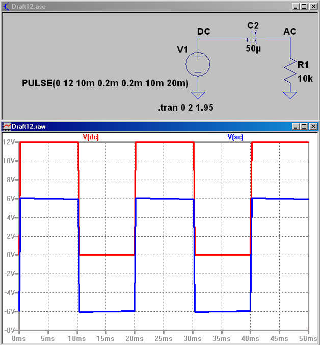

Look at post #6. A simple capacitor does this for you.
Why not just put a DC blocking capacitor in series with the signal, as shown here:
As with the original poster, there's no such thing as a 'DC squarewave' - a squarewave is AC already.
I respectfully beg to differ. This signal is a square wave which oscillates between 0v and +3.8v.
An AC signal - Alternating Current - oscillates from 0v to some positive voltage, back to 0v, to some negative voltage, then back to 0v. F'rinstance, U.S. line voltage cycles from 0v to +110v, to 0v, to -110v sixty times every second; 60Hz AC.
What I am working with is a DC voltage that is simply being turned on and off very quickly, hence "DC square wave".
