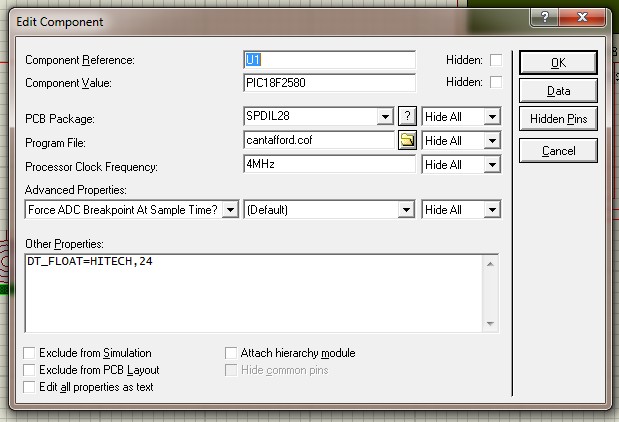

I have done that and the speed is displayed as zero on the LCD no matter what the actuall speed is.
This is the code(the last function is the one that is supposed to display speed, the one in which I followed your instructions):

And this is how I connected the encoder: Q1 on RA4(not sure what I have to do with the other 2 pins)
Two things stick out... You set T0CS then turn it off with the T0CON statement!!
If you turn PSA on you don't need to worry about setting the prescaler
The other is the use of floats...
This line..
speed = TMR0 / 6; It you are going to use floats then you have to cast..
speed = (float)TMR0 / 6; This way the TMRO is cast to float BEFORE it is divided...

Lastly... If you are going to use floats in ISIS place this line in the properties box
DT_FLOAT = HITECH,24 Then you can debug the values easier!!
