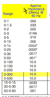

Hello,
I have a new Simpson analog DC amp meter and I need help with the connection. Simpson's web sight calls for a 10 Ohms impedance. The attached picture is from Simpsons meter connection document. I certainly don't believe that it should be an integral link in the service line. The illustration is too vague for me to comprehend.

The meter for use with external shunts has a sensitivity of 50mV full scale, as Mike ML stated, and has a 10 ohm meter resistance. That may seem low for a meter resistance but it's connected in parallel with the shunt, which is in the milliohm region, depending upon the full-scale current sensitivity desired. Thus the meter resistance is much higher than the shunt where it measures the 50mV voltage.
The meter data sheet you present is one of these as you know. The meter scale is 0 to 300 Amps and that meter is designed to work with one of these shunts and to be specific the 0 to 300 Amp shunt.
Pretty much as covered. So the output of the shunt is 0 to 50 mV based on 0 to 300 Amps flowing through the shunt. Thus even though the meter is a 0 to 50 mV meter movement the actual scale of the meter face is 0 to 300 amps. The meter is scaled to provide what it reads based on the output of the shunt it is used with. If you wanted to test just the meter movement you would apply 50 mV to drive it to full scale.

Now as I understand the situation the shunt is actually an integral link in the service line and based on my meter I should use the one that I have highlighted.
If that is correct then is the 10 Ohm resistor in the line between the shunt and the meter POS post?

You don't need a resistor. The 10 ohms is the resistance of the meter movement and it's given for information only. You just connect the shunt directly to the meter terminals.

The 10R you keep quoting is the Impedance when used on AC circuits.
Attached is the Simpson datasheet.
The actual resistance of this type of shunt is milliohms [ ie: 0.001R], so if you used a 300A DC shunt that developed 50mV that would mean that you would only 'lose' 0.05V drop in the 100V DC voltage in the circuit.
Its perfectly OK.
