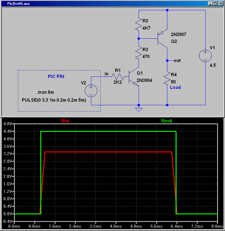

Even if it were 5V, the PIC pin will not pull all the way to 5V when sourcing more than a few mA. The Vbe of the first transistor is about 0.7V, while at higher current, the Vbe of the second is likely to be ~0.9V, so 4.5-0.6-0.6 is about 3V at the emitter of the second transistor. Remember that you are using these as two emitter followers in series, so the Vbe drops are additive.
You really should be using a high-side PFET as a switch. Doing it that way, you will get almost 4.5V across the load.

I would say that using an NPN transistor to drive the load is a bad choice for your application.

Conceptually that's not right for your requirements. NPN devices, when driving a grounded load from a positive voltage, are acting as emitter followers, thus the output voltage is at least one diode drop (or two diode drops for a Darlington) below the 3.3V base drive voltage. Thus you need to use a high side driver (PNP bipolar or PMOSFET) transistor to drive a grounded load with minimum voltage drop, as MikeML showed.

That's not just a drawing; it is a running simulation of the drawn circuit. The green trace is the simulated voltage across the simulated load resistor. Note that it is just one Vce-sat (~0.1V) less than the 4.5V supply voltage.

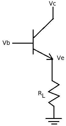

Alright, I've been going back over this in my head and I think there is something more fundamental I'm misunderstanding about BJTs. I realize I have two distinct notions about BJTs that are in direct conflict with each other (I'm visualizing the attached image as I type this out):
Notion 1: A transistor can act as a switch if the base is saturated. As the current through the base approaches the saturation point, Ve will approach Vc. Ve will never actually reach Vc because of the Vce voltage drop.
Notion 2: Ve is equal to Vb minus the Vbe voltage drop.
So, in notion 1, Ve is a function of both Vb and Vc. In notion 2, Ve is only a function of Vb. Which one is true? Or are they both flawed?

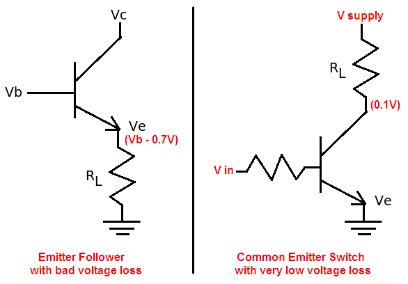

Your transistor is an emitter follower that does not saturate. The emitter voltage is about 0.7V less than the base voltage and the collector voltage does not matter (if it is high enough so that the transistor does something). If the collector voltage is 10V and the base voltage is 5V then the emitter voltage is about 4.3V.
A common-emitter transistor circuit saturates the transistor. The base voltage must be about 0.7V and then current can flow in the base current-limiting resistor. Usually the base current is 1/10th the collector current. Then the collector voltage goes down almost to 0V. So almost the entire supply voltage will be across the load like if a switch was used.

It would seem, then, that the common emitter switch is the way to go in terms of simplicity. Does the simulated circuit MikeMI posted above have any advantages over the common emitter switch?
Mike didn't answer yet so I will guess.
Maybe he thinks that your load must be connected to ground like in a car.
Then he uses a common-emitter NPN transistor to drive a common-emitter PNP transistor that drives the load.
Since the PIC pin can only drive from 0V to ~3V+, the NPN must be there to reference the base drive of the PNP from 4.5V (Off) to ~3.8V (On).
If the load must be grounded, then Mike's circuit is required. If the load can return to +4.5V, then Audioguru's grounded-emitter NPN can be used.
