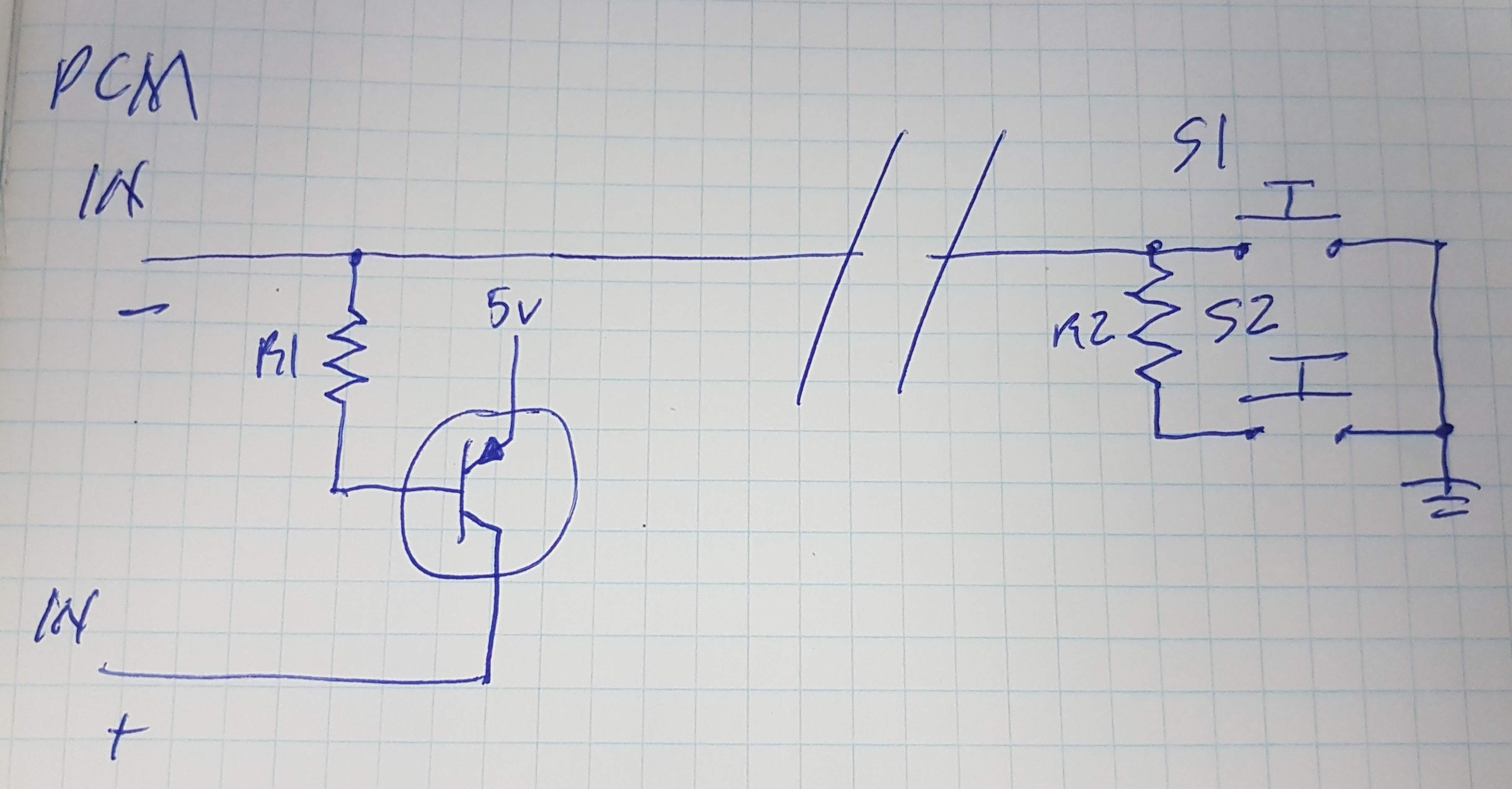

With two wires I was thinking a simple circuits for a pair of switches on each wire...
119660
S1 would activate both Controller inputs but S2 with a resistors will fail to activate second input.
Is something like this workable and if so are my schematics correct?

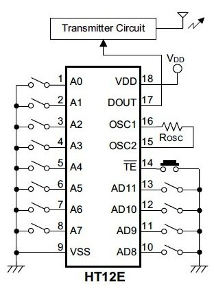

Here is a bad idea but maybe it will help.
This IC us used in garage door openers. Inputs A0-A7 are address so it will only talk to the receiver with the same address. AD8-AD11 are for switches. Normally Dout goes to a RF or IR transmitter. But could just be a wire. (needs power!)
119668
I can not find the receiver IC now. It is about the same thing but AD8-AD11 are outputs.
There are many different versions of this. More/less switches.
I have used one wire to send power and data at the same time.
options:
Wire 1= power, Wire 2= Dout
Wire 1=power and Dout, Wire 2=ground.

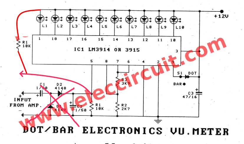

Another bad idea.
This IC is used as a meter in audio amplifiers. There are 10 put puts. In DOT mode only one LED is on and in BAR mode all LEDs below the level are on. So it reads 10 voltage levels and indicates which level is right. There are two versions. (linear and log)
I removed the input diodes and caps and added a 10k pull up resistor. The switches pull down with a different resistor for each. If S1 has a 10k resistor it will pull down to 1/2 supply. S2 and S3 will have different values and cause a different output to turn on. This IC can act like a 5 LED driver by shorting pin1-18, pin 17 to 16 etc.
119674
I can not find it now but there is a simple 4 or 5LED version some where.
So on the remote end there are 4 switches and 3 or 4 resistors. On the PCM end, it will look at 4 of the outputs.

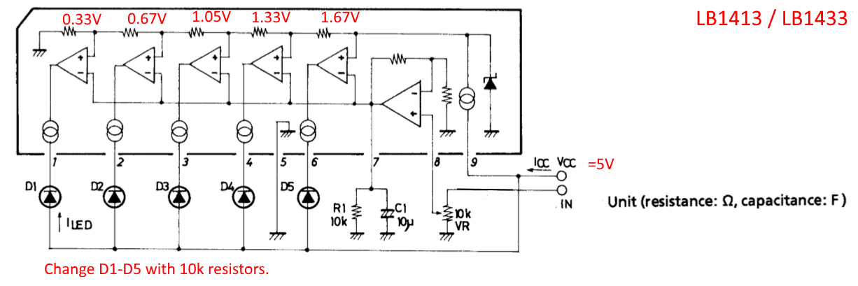

Found the IC: LB1413
119680
If the 10k VR is set to the top then when IN approaches 0.33 volts pin-1 goes low. At about 0.67V then pin 2 goes also low. By 1.67V pin 6 drops.
If you want twice that voltage adjust VR to the 1/2 point.
Probably should have a 0.1uF cap from pin-8 to ground to help remove noise.
I have not tried this circuit. I do not know exactly how low pin 1-6 will go or how high. I think 0.5V to 5.0V. This needs to be tested.
I forgot to add a 10k resistor from IN to VCC. The switches and resistors are not shown.
