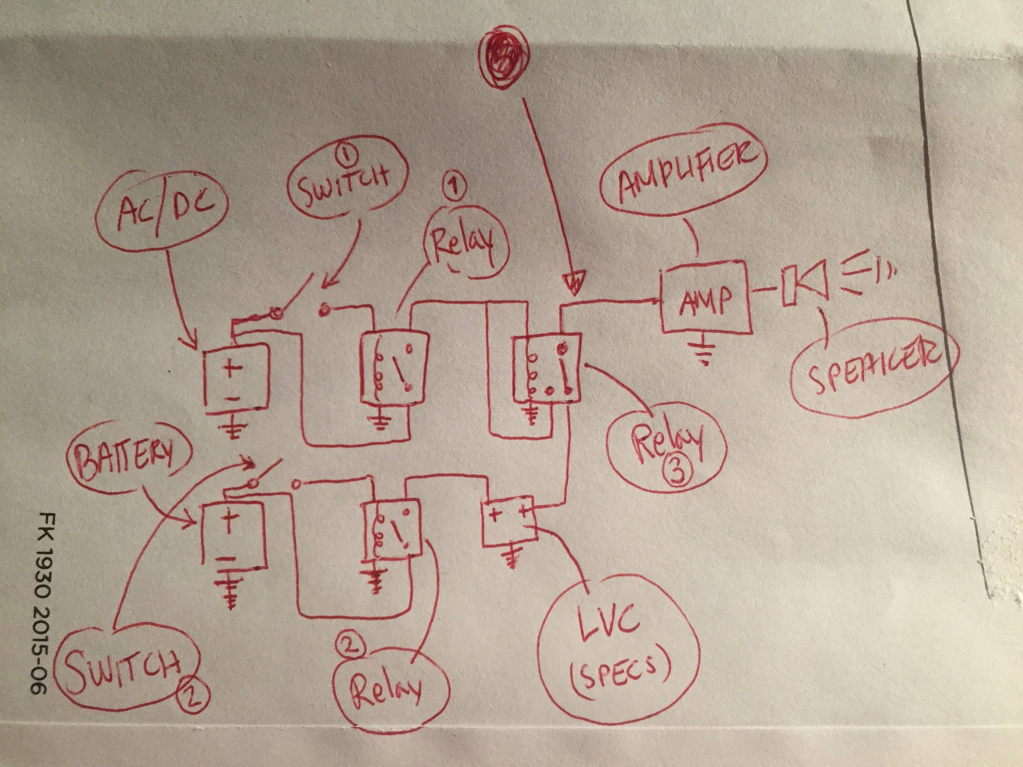

Hi again, I have a question regarding my project that I think maybe is related to the circuit. If you look at my image (hope you can understand my drawings) and look where my arrow points between relay 3 and amp.
If I connect ac/dc and turn switch 1 on and then off and measure where arrow is pointing I get around 3v that slowly counts down. I think this is wierd? Shouldn't I get 0v after power off? Is there any current staying that leaks down to the capacitor in the LVC?
Same thing happens if amp is disconnected.
Relay 3 activates on ac/dc on. Its normally on/closed for battery use.
Nothing to worry about:
There is always stray capacitance around that will store electric charge and as your digital multimeter has a very high input impedance it will take a long time to discharge the charge.
The amplifier will certainly have some capacitors across the input lines which will store more charge, but the amplifier circuit will provide a discharge path in addition to the input resistance of the multimeter.
Put a 100K resistor or so across the input to the multimeter and measure again.

Thank you very much Spec. Now I feel more relaxed about it . Next step maybe is to figure out how to change my three relays to mosfets

After looking at your schematic/block diagram, I hope you don't mind me saying this, but I suspect you have three relays too many. Can you post a truth table to show us what you would like to achieve?

Only reason I have two of thoose relays is because my switches is small and only handle 1A. Third relay is switching between ac/dc and battery. That is why Im using that third relay.

Shall I have a look at simplifying your set up?

This is how my mess looks at the moment. Dont know anything about how to do or draw schematics correct so it's possible things looks crazy. Sorry if it does not make sense! hope its not a problem going offtopic...

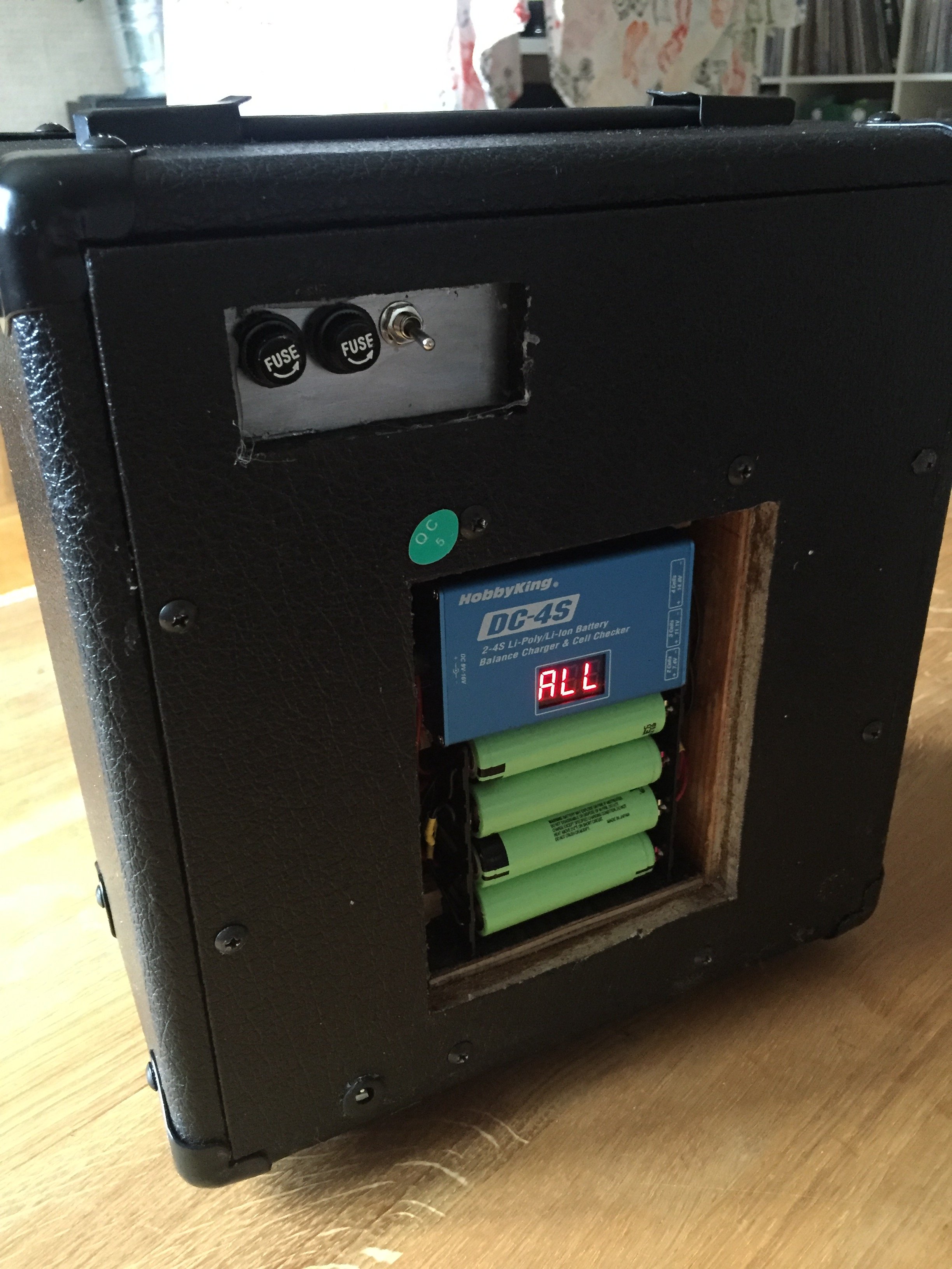

19.5v DC is now a 16v, 5A DC psu
4s BMS is a small balance charger
That one would probably do it.
AC/DC and charger on one side and battery on other side. And one more switch for on/off charging? (When battery is full the charger beeps loud )
Yes, you have got it in one.
If you can ever remove a relay or switch, it is best to do it because they are troublesome things.
