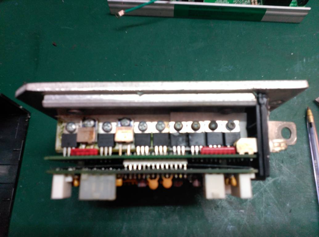

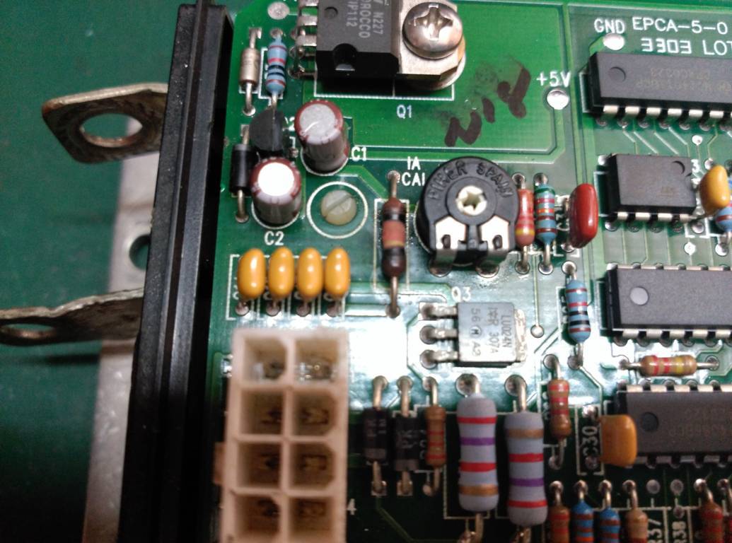

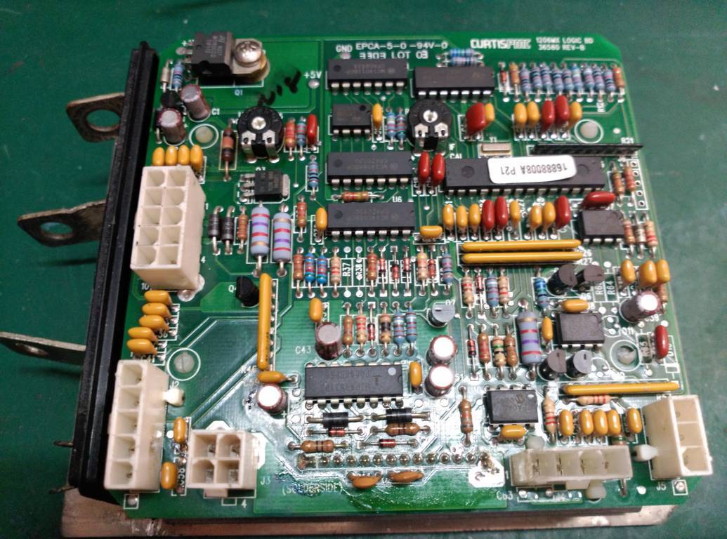

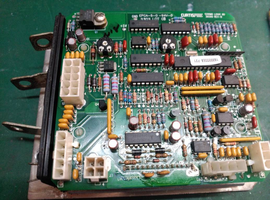

I´m trying to repair this ECU. It´s PN: 73326G06 (1206MX logic board). I have found the mosfet H bridge damaged, some gate resistors and the driver. This I already replaced but now I have the problem with R66 which is burnt and I can´t know the original value. It´s going to a colector from TIP112 in one side and to J1 pin 1 in another side so it seems it has to do with the forward and reverse selector. Does anyone have this unit or similar to know the value? I think it´s a current limit resistor.

http://www.restoretronic.com/descargas/Curtis PMC/2.jpg (burnt resistor)

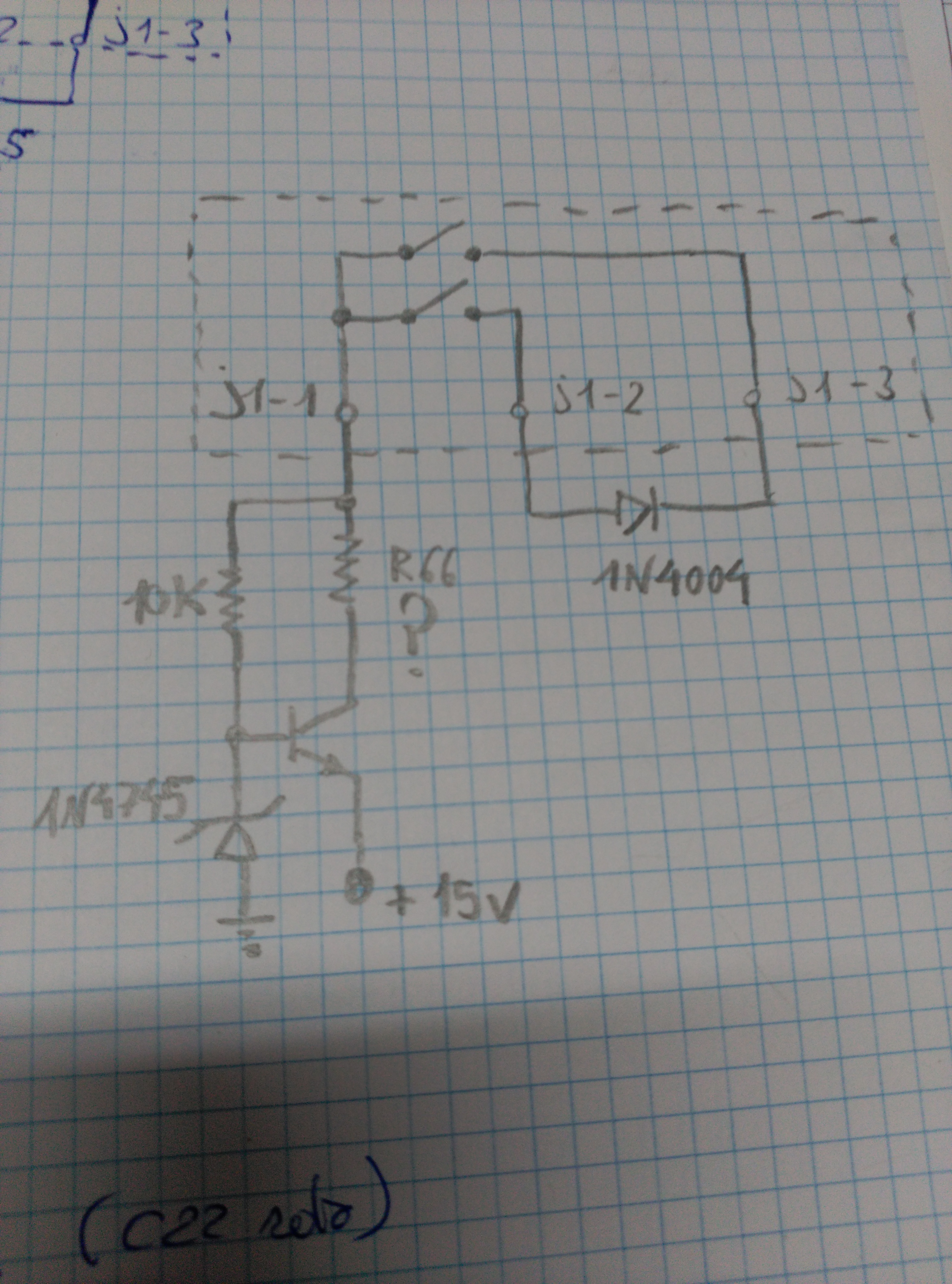

this is the circuit involved to R66, it´s difficult to follow because the board has 3 or more layers. Should I make a jumper at R66 and try it first or would you select a low value resistor?
http://www.restoretronic.com/descargas/Curtis PMC/R66 circuit.jpg
