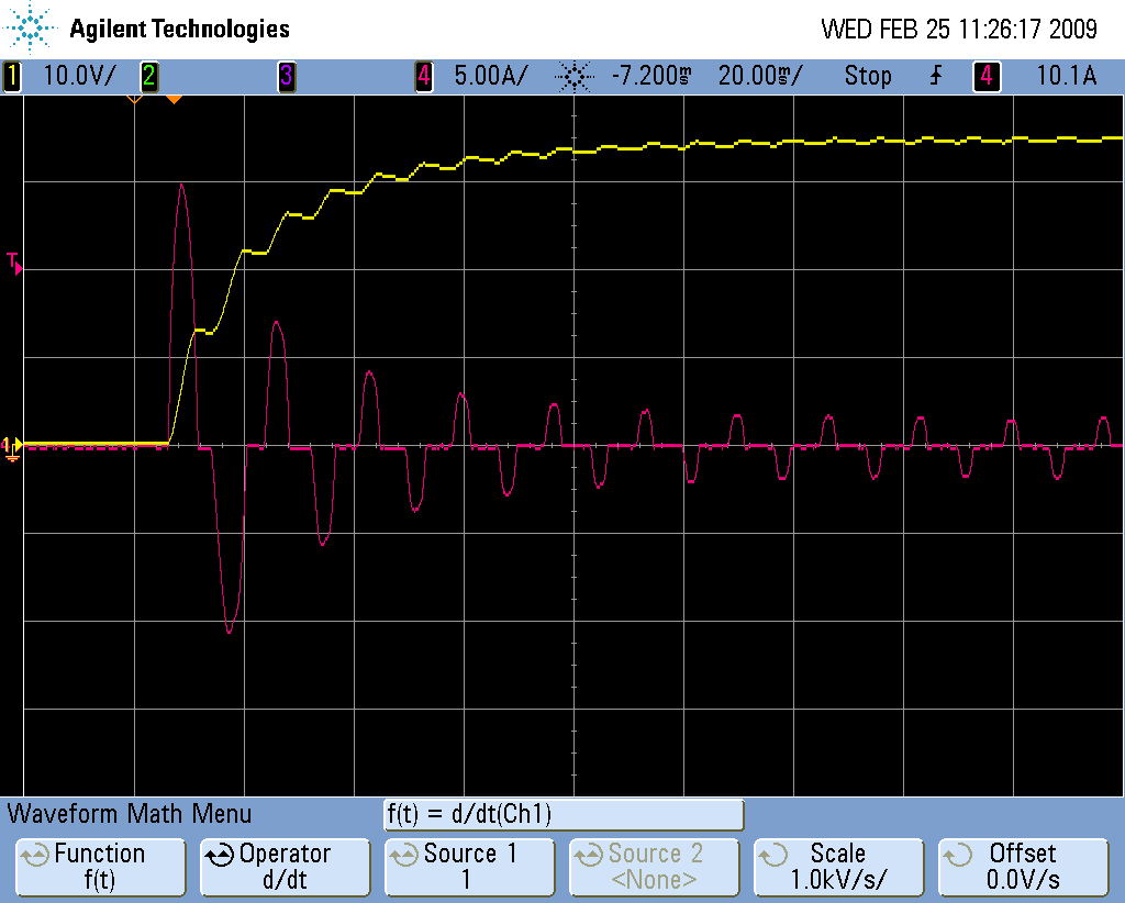

Your description sounds like you're suggesting that when the power supply is in normal operation, and the diodes are carrying a current pulse every 1/60 of a second, the pulses are allowed to be up to 30 amps. If this is what you're saying, it is incorrect.
See the attached scope capture showing diode current and cap voltage at turn on of a power supply. The red trace is the current (at 5 amps per division) through the diodes and the yellow trace is the cap voltage.
When the power supply is first turned on, the filter cap is discharged. There will be a large current pulse (or maybe several) to initially charge the cap to the normal operating voltage. Then the current pulses that occur at 1/60 second intervals during steady state operation will be much less than the initial cap charging pulse(s).
The graph on the 1N4007 spec sheet labeled "Non-Repetitive Surge Current" refers to the initial cap charging surge, not the repetitive pulses that occur when the power supply reaches steady state operation. Before that large (up to 30 amps) surge can be repeated, the power supply has to be turned off and the diodes allowed to completely cool down, at least several seconds I would say.
