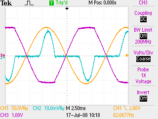

I've attached an image showing the current through the diode in a typical capacitor input filter circuit.
The orange trace is the grid waveform, the purple trace is the waveform at the secondary of the transformer and the blue trace is the diode current.
Just visually estimating I would guess that the conduction angle is somewhat less than 90 degrees. Looking at the derating chart on the second page of the GE spec sheet, we see that the diode average current rating should be reduced to somewhere between 700 and 800 mA.

You say the rating is 700 mA; the manufacturer says the rating 1 amp. How do you reconcile the difference? Why would the manufacturer lie to us?
Your empirically determined rating of 700 mA was appropriate because the current waveform was undoubtedly more peaked than a half sine; your power supplies had capacitor input filters, didn't they? The manufacturer's rating of 1 amp is for a half sine, with a conduction angle of 180 degrees.
This is only going to occur for a purely resistive load.
With a capacitor input filter, the waveform will be more peaked than a half sine, and so the diode rating must be reduced as shown in the derating chart on page two of the GE spec sheet I posted.
What was the conduction angle for your power supplies? I suspect that it was similar to the scope capture I posted, and if you referenced your actual conduction angle to the chart in the GE spec sheet, you would find the rating for the diode should be about 700 mA.
There's no mystery here, and no contradiction with the manufacturer's rating of 1 amp in the Absolute Maximum Ratings table. You just have to know under what conditions the manufacturer rates it at 1 amp.
