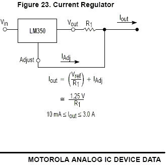

TO eng1:
And in the LM350 circuit, can I just choose a resistor as per my voltage needs and start charging? Where were you suggesting the power BJT?

What kind of battery are you going to charge with that current?
If it is a lead/acid battery, a circuit with LM350 might be good (the bjt would be a general pourpose npn one, attached to the adj aterminal to limit the current through the battery).
If you're going to charge Ni-Cd / Ni-Mh or Li-on batteries you may need a charge controller... I learned something about charging stages with the LM3647 general description and datasheet. I hope it will be useful.
check maxim-ic website or analog devices website and search in their application notes, there are some good info and some circuits about current sources.

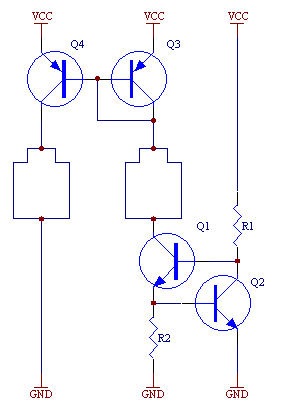

a transistor's Beta is the current gain , so a 7ma current to the base(of a power trans: ) with gain 100 , should produce 700ma Ic , in theory.
Can you suggest me a transistor that can handle 700mA Ic and also has a gain 100?

I've found just using transistors and resistors a good way of making constant current sources. In the diagram I've attached, the current is determined by the R2 (I=0.7/R2), and R1 just needs to be large enough so as not to draw lots of current, but small enough to ensure the current gain through Q1 is sufficient. It is a very simple and stable circuit which doesn't rely on a specific voltage source. Q3 and Q4 do the current mirroring - these need to be the same type of transistor and preferably from the same batch - using different types here can lead to a wildly different current in the mirrored branch. I haved used both the current limiting and mirroring bits in a number of circuits without any problems. Now you just need to workout when the batteries are charged.
