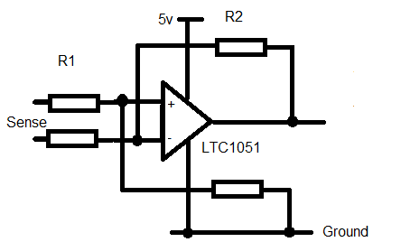

I have oodles, and I mean oodles, of LTC1051's and LT1112's dual op amps..
I aim to use one as a current sense.... Now I know some op amps will not work in this config, I normally find an example in a datasheet and use that.. But there isn't one.
As far as I can see, you would have to use a differential config with resistor dividers to pick up voltage from a sense resistor, to avoid the inputs being near either positive or negative supplies.
The 1112 cannot work within around 0.7V of either supply and the 1051 cannot accept anything below its negative supply.
If you are sensing with a resistor in the negative of a battery or power source, so voltages fairly near 0V rather than in a positive or negative supply, you could use either if you added a negative supply somehow; but I suspect a different opamp is simpler.
You could possibly cheat slightly with the near 0V sense resistor, if it's not too critical?
Add two similar diodes close enough together to keep them the same temperature, from each end of the shunt, with bias resistors to a positive supply and the 1051 opamp working from the shifted voltage from the diode anodes.
Its a psu... I will be using 1.25 ~ 24v input .. I have 3 LM317T devices paralleled to get me 4.5A I have a micro to determine voltage and current and display it... I'm not going to current limit, just sense... I have a batch of 0.1ohm resistors (5) which I'll also stick in parallel to get the 0.02ohm current detection.. The LTC1051 is rail to rail, but I don't need that... All I remember is some opamps are more comfortable with this sort of application.. As there wasn't ANY sign of an example of this kind I thought I may be barking up the wrong tree...
If an LTC1051 would do the job.......... Hey Boll**cks to it.. I have enough, I'll see if it works.... I'll try a low side first..
Must admit, I was having problems trying to current sense - in a buck/boost converter - as where ever I put the sense resistor it was too far away electrically to work with my opamp.
In the end I swapped to using an AD8210, which is specifically intended as a current monitor - this worked perfectly.

I'm just using what I have here... The LTC1052 seems to work well BUT!! Christ it doesn't seem to be linear..
I used two 68 ohm for R1's and two 6k8's for R2's I used 0.02m ohm on the sense... I'll just do a calibration sequence.. I did have a couple of 3055's somewhere.... I only really need 2~3A.. would two 317's in parallel be better??
