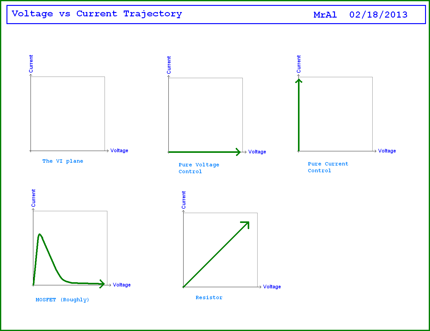

I think the most concise statement that can be said about current vs voltage for operating a device is that for any device the current and voltage follow a TRAJECTORY in the voltage/current plane. That says it all in a nutshell.

Oh, you mean what I said in post three of this thread?

Really though what i did was plot the V I for just about any device and showed that the trajectory was the most concise view from the standpoint of external control. What you did was mention that the slope was important. The slope can be derived from the trajectory, but i think you were right about mentioning the slope too.
