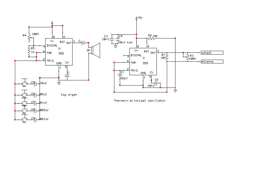

Theremin principal oscillator
not sure if this will even work
plan is to breadboard and give it a whirl connecting an 8 ohm speaker to output w/ capacitor in series w/ speaker.
any comments??
this is from the theremin vision site
oups forgot to post schematics
here are two ideas I have
simple, cheap etc
the crystal radio is not a bad idea especially if you couple it to an amplifier, I did this with a 200 in 1 kit once as I could make both the radio and the amplifier at the same time as no cmponents clashed, this will give much greater success, you can use a prebuilt audio amp to conect to each it to see how well the lads did or just knock up a design with an opamp
The 555 might blow up when it tries to drive 300mA into an 8 ohm speaker. It is not a power amplifier so the current should be limited to 100mA with a series resistor. Then the loudness will be low.

If you are going to make PCBs, why not make them as "modules" and use those terminal connectors with a sprung button - you just hold the button and push a wire in.
Then you can make a few little modules liek a 555 module, or a relay module, and things like flashing leds, switches, speaker, dc motor, battery packs etc all with leadwires.
Then the kids can just connect whatever to whatever and make stuff work. With a little attention to protecting the inputs and outputs on the PCB modules (with diodes, resistors etc) you could just let them at it and supervise with suggestions.
They will learn all the cool stuff like a LED won't light if it's the wrong way around and how a switch can be used to turn a 555 timer on and off etc etc. No soldering needed and reusable modules they can swap around to stop them getting bored.
